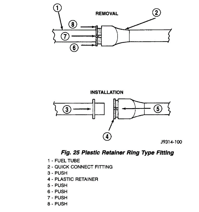

I am unsure of the fuel line size and so even though I have found an identical part I am unable to order because I don't know the correct size
Oct 31, 2019 at 1:26 AM
  • 110,246 POSTS

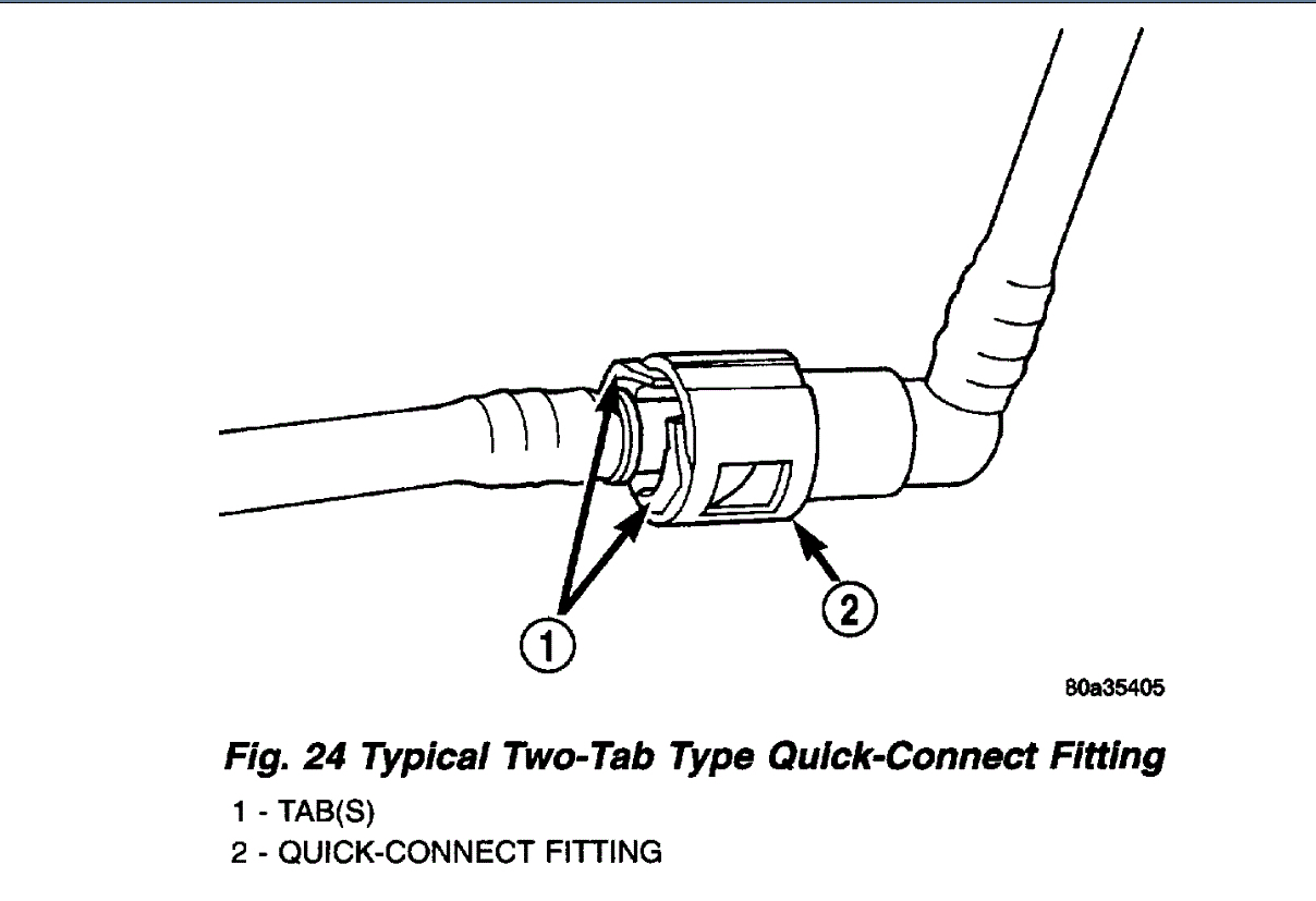

I believe it is 5/16" line. Where exactly is the location you need to repair? I just want to make sure it isn't a vapor line because that is 3/8". Take a look at the attached pic and let me know if that is the type of quick connect you are dealing with. The picture basically shows how to disconnect the fitting.
Picture 2 shows a different connection.
