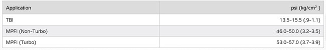

I have to feather the gas pedal on acceleration or it will stall and keep the pedal floored on the highway until I get it up to approx. 55 miles an hour. I have been to 4 mechanics and no one can find the problem. Any suggestions/

scan for codes and check fuel pressure with a gauge

I have done that and the fuel pressure was fine, any other suggestions?

what was fuel pressure? if not minimum in pic then pump is bad, or a plugged fuel filter. sure sounds like it.

The fuel pressure was good, one of the mechanics also checked it, I don't have the reading. The fuel filter is new. Any other suggestions? Thank you

only other thing I can recommend is to clean throttle plate on both sides and iac hole with choke cleaner and scan for codes as well as checking for a vacuum leak other than that I have nothing else to suggest
