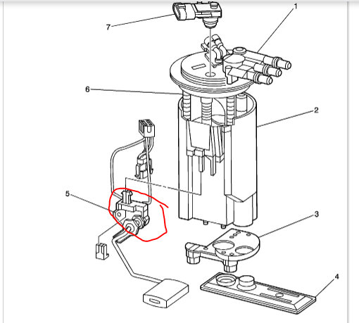

Did this happen prior to the replacement? Did you have any trouble installing the new assembly with the float?
The float is attached to a rheostat. The rheostat is a resister that changes the voltage based on the float's position in the tank. If anything, that is what I would think could cause this unless we have a wiring issue.
If you look below, I attached a pic of the assembly. I circled the rheostat also known as a level sensor. Could the float arm have gotten bent when installing the assembly into the tank?
See pic below.

Didn't have any trouble installing the new assembly, it went in fairly easy. When I bought the car, it had less than a quarter tank of fuel, so I put gas in it which I was only able to get 7 gallons in it before the pump stopped me from putting any more in and it only went to half a tank on the gauge.
I don't know if it could cause a wiring issue but the old assembly had a ton of dirt and dust on top of it which I did clean and vacuum up before removing.

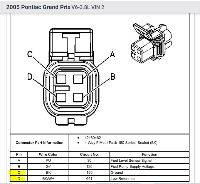

It could be a ground issue. If there is excessive resistance, it can change the signal to the PCM, which then sends the signal to the instrument cluster (fuel gauge).
Do me a favor. At the fuel pump connector (black connector/4 pin), I need you to check for continuity to ground. If you look below, I attached a pic of the connector. We need to check pins C and D.
Pin C should have ground at all times. Pin D will have it with the key on. Check that and let me know what you find or if there is excessive resistance in the wire.

That'll have to wait till the weekend but if this info is any help, I was able to put 10 gallons of fuel in without issue and the fuel gauge went from reading almost full before filling, down to a quarter tank after doing so.
