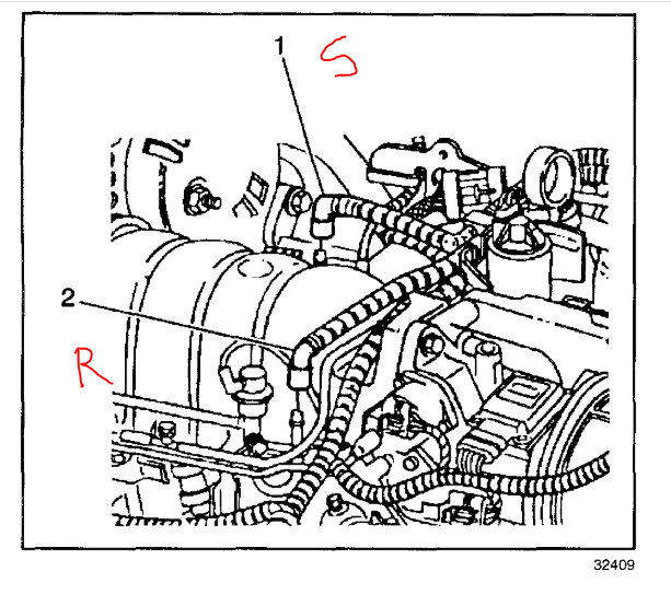

the fuel supply line is leaking at the fuel rail when the engine is running. do i need to replace the fuel line or the o-ring?
Dec 21, 2024 at 7:29 AM
  • 110,240 POSTS
Which is the one leaking? Is it the supply or return? See pic below.
If it is the supply, inspect the connector for cracks or the hose for any damage. If everything appears to be okay, you should be able to simply replace the o-ring.
See pic below.

the supply, how do I replace the O-ring?
Dec 21, 2024 at 2:07 PM
  • 110,240 POSTS
Often times, the connector is replaced. They make replacement parts that get installed onto the existing hose. On the other hand, once the connector is off, you will see the 0-ring inside the connector. To replace it, I always use a pic to remove the old one.
One out, you have to get the same size o-ring for replacement. If it isn't the same as the original, it will leak. There is a good bit of pressure on it.
Once you get the new one, it's nothing more than reinstalling it into the connector. I like to put (don't laugh) a little Vaseline on the new o-ring to help prevent the chance of damage when installing it.
Let me know if that helps.

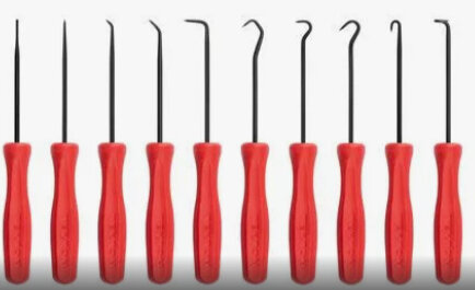

If the connector is still good and the only issue is the o-ring, I would replace that. As far as a pic, I attached a picture below of a mechanic's pick set. If you have a Harbor Freight nearby, they sell a smaller set for under 5 dollars.
See pic below.
Dec 23, 2024 at 1:31 PM

I have the first 3 and the last pick in my toolbox, are those o-ring hard to replace? the leak not bad how would fuel-resistant sealant work on the connector?
Dec 23, 2024 at 2:15 PM
  • 55,286 POSTS
Those O-rings are not bad, any of those picks should work.
