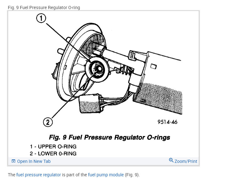

So, any ideas as to what is causing this excess pressure? I believe the fuel pressure regulator on this model is located on the fuel pump in the gas tank, which is not something I can work on here in the street in front of my house. I hate to send it to a shop if that is not the solution.

Let me know what the fuel pressure is and send that picture over and we can go from there but I think you may be on the right path with the regulator which is on the pump in the tank. Thanks

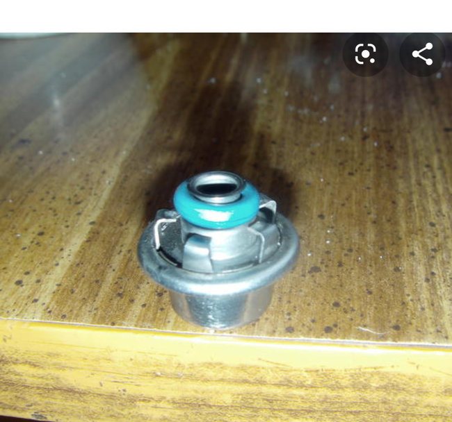

This is a stock photo of my fuel rail ( photo is reversed, cap is on drivers side) And someone else's photo of the cap that is leaking ( mine is exactly the same).
https://photos.app.goo.gl/oHa9AKp7TgreEJdGA
I removed my cap and replaced the o-ring. O'rileys sold me the wrong one the first time so I tracked down an original mopar one and put that in.
I think It may be a coincidence that the leak stopped for a little while. The original o-ring looked okay, and the replacement is an exact match.
I'm sure I have it seated properly because it stopped leaking that time I opened the gas cap.

Does the piece you are talking about have metal tangs or clips that hold it down into the rail? Then the o-ring is at the bottom?
If so, this is more than likely just a dampener meant to smooth out fuel pulses. As you can see the fuel pressure jumps around (flutters) when running so this dampener is just there to smooth it out. However, this is not a serviceable part so once it is removed those tangs loose their tension and more than likely the only way you will fix it is to replace the rail which should come with this already installed.

Yes, It is the cap you are describing. It is marked "do not remove" (which is impossible to read until after you remove it!). It does not seem to "seat" into anything, and I agree that it is a damper. I compared it to a water hammer arrestor when I was trying to describe it.
I was extremely careful in removing and replacing it and the tangs are completely fitted under the flared end of the little tube thing it fits on.
I don't understand what would prevent it from being serviceable, but that's beside the point.
Is this a part that would fail from old age? (The o-ring looked okay) If not, what would cause it to fail?
I really hate working on cars, so as long as I have to replace the fuel rail I want to get whatever the root cause is, too.

This is what the cap looks like (not my photo). It sits in a tube near the end of the rail. It doesn't click in, just pushes in until the tabs go over the flare on the rim of the tube and lock it on.
Tuesday, September 3rd, 2019 AT 6:23 AM

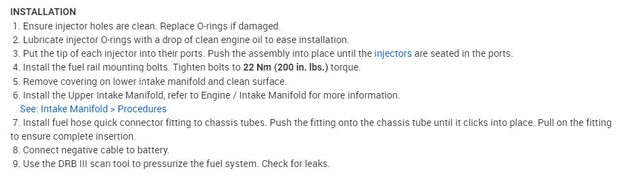

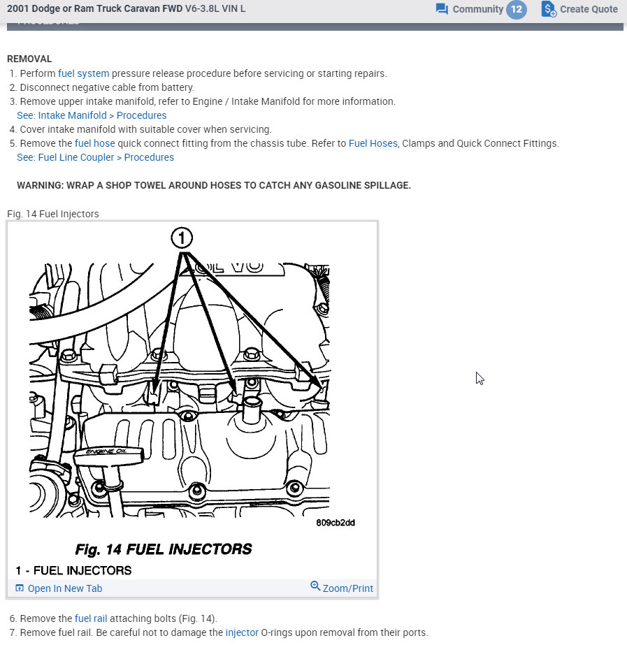

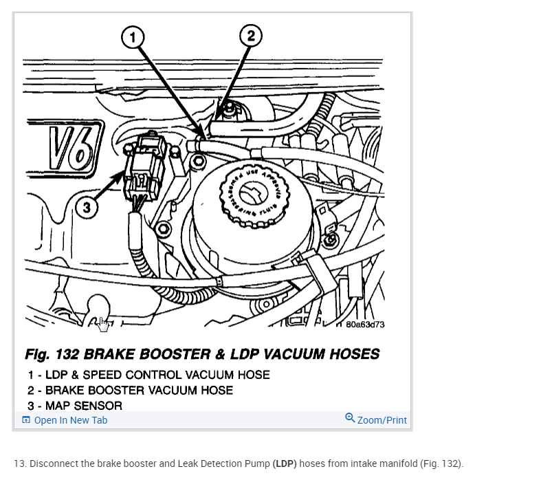

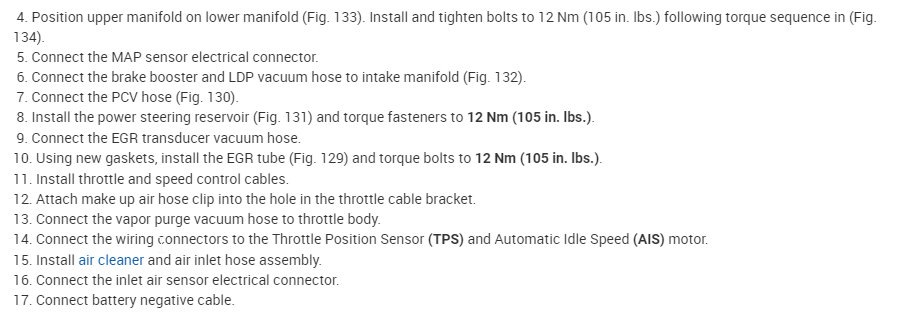

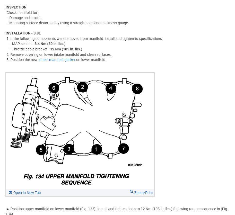

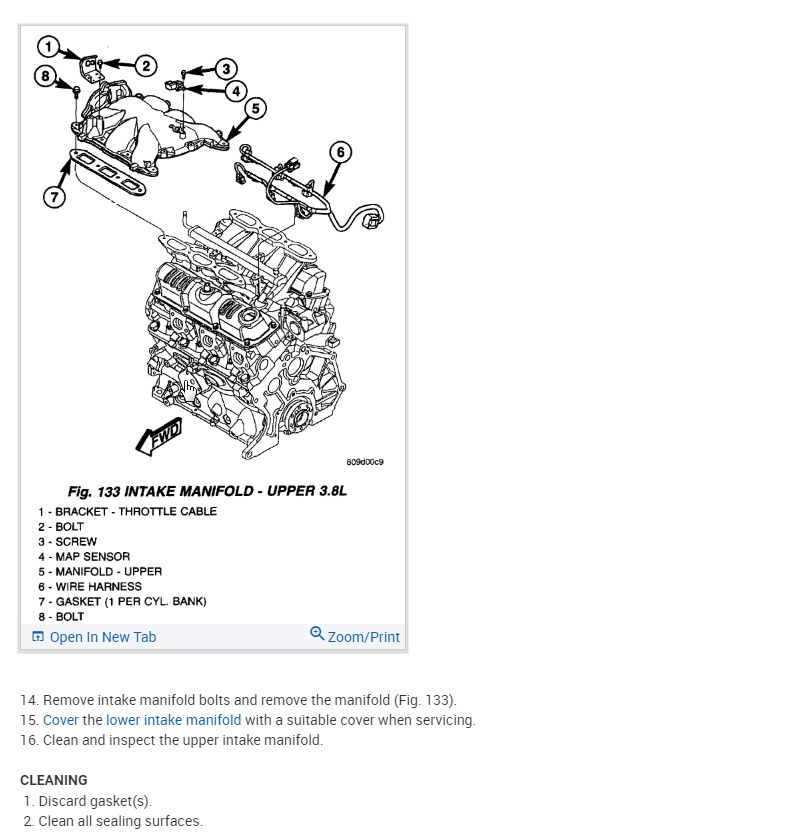

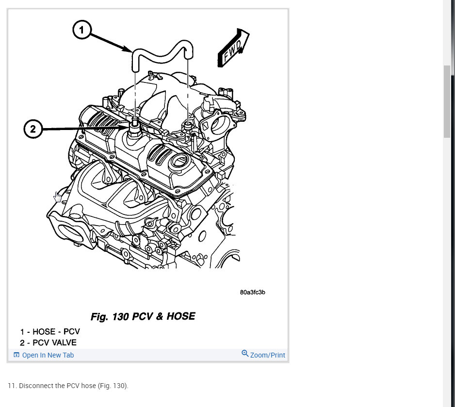

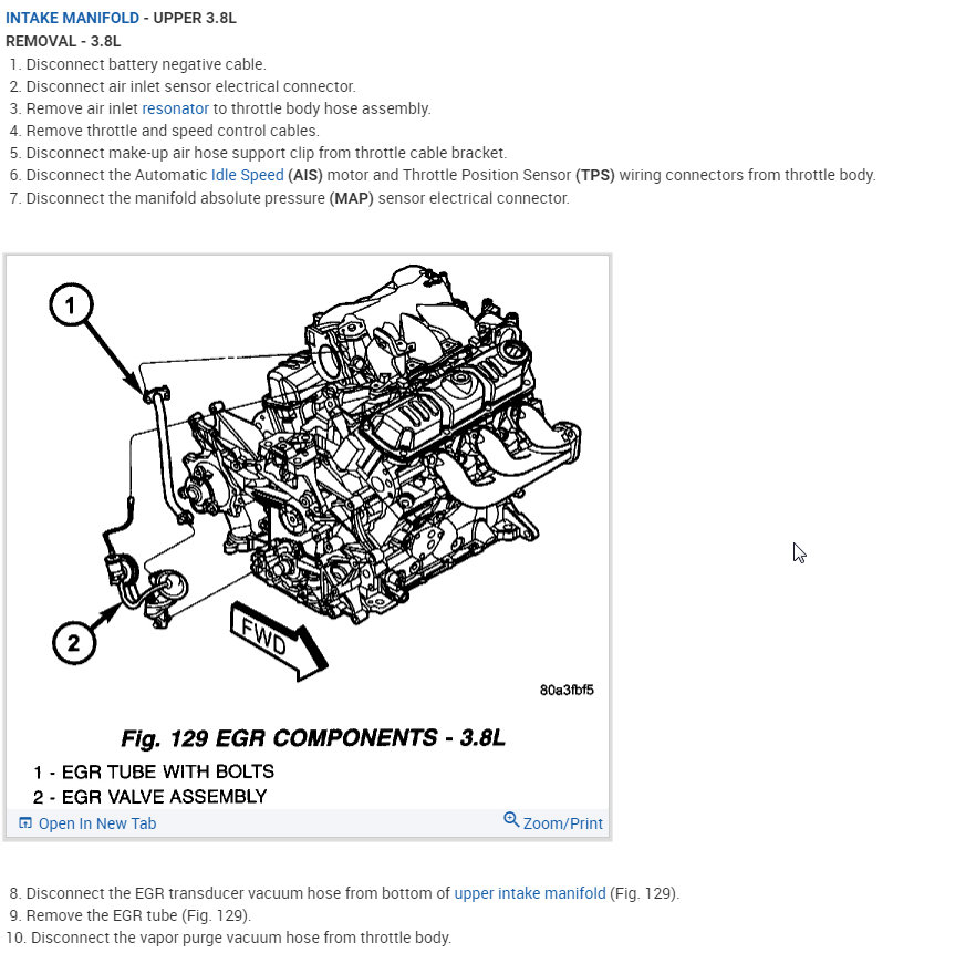

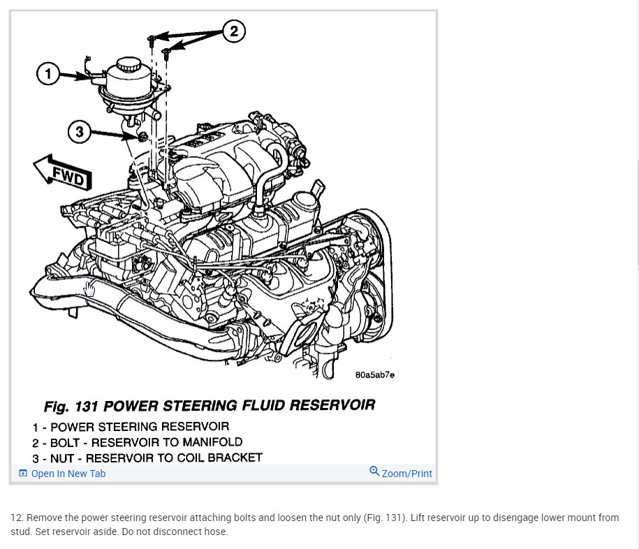

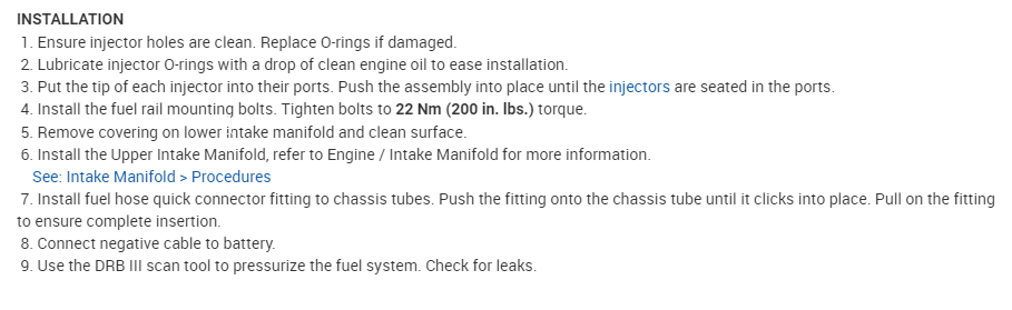

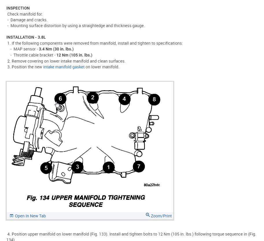

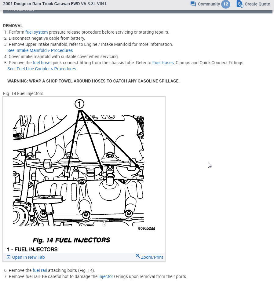

Yes, okay. We are on the same page. That is in fact what we are saying is a damper. Unfortunately, what happens is when it is removed, those tangs do not hold enough tension on the assembly which causes it to lift just a bit when the pressure goes up to peak pressure of about 64-66 PSI.
Here is the procedure from the book on how to replace the rail. This includes removing the upper intake. It is not the easiest thing but can be done in a driveway.
Please let me know if you have questions and I will be happy to help. Thanks
