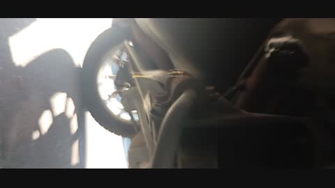

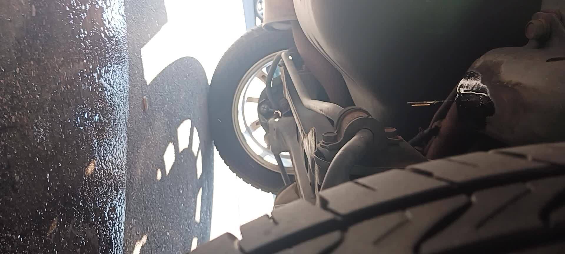

I hope you are having a good day. I've long had a persistent P0442 trouble code and haven't been able to identify the leak. Now I'm thinking I may have found the source of the leak. Please see the video I've attached. This happened while I was pumping gas this morning. After I had driven to work this morning, I checked it again and did not see any leak happening. So, this appears to only happen with the added pressure on the system from the gas pump while pumping fuel. Does this mean I need to replace the fuel filler neck? Thanks for all the help you guys have provided me already.

Hello, is that leaking out of the bottom of the gas tank? The video is a little difficult to see. And what sub model is this vehicle RS, GS or Spyder GS? Are you pulling the gas handle out to try to fill the tank to the max limit? This P0442 is an Evap system small leak detected. The Evap system is for fuel vapor management, I'm wondering if that gas leak is coming out the top of the gas tank.

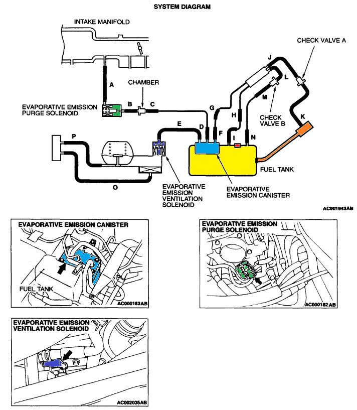

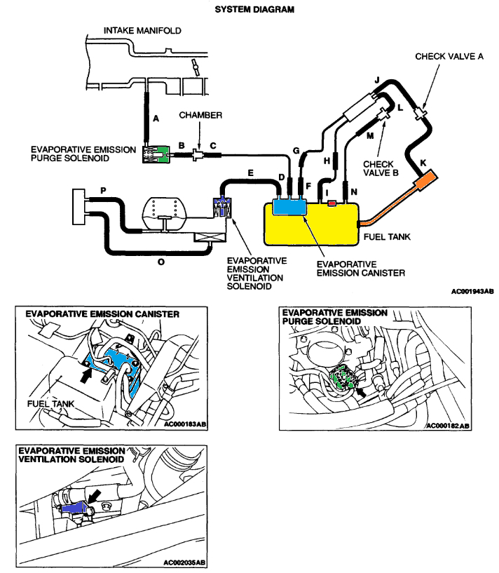

This is a diagram of the Evap vapor system and gas tank, the Evap system purges fuel vapors into the Intake manifold so they can be burned and not released into the atmosphere. But driving around with a gas leak like that is extremely dangerous and is actually illegal. If they saw a leak like that at the gas station, they would make you have the vehicle towed to a shop and the fire department would be called, I have run into that before with a customer at a shop I was working at which was part of a gas station. So, you need to get that fixed before driving any further.

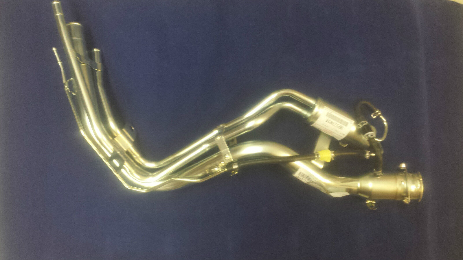

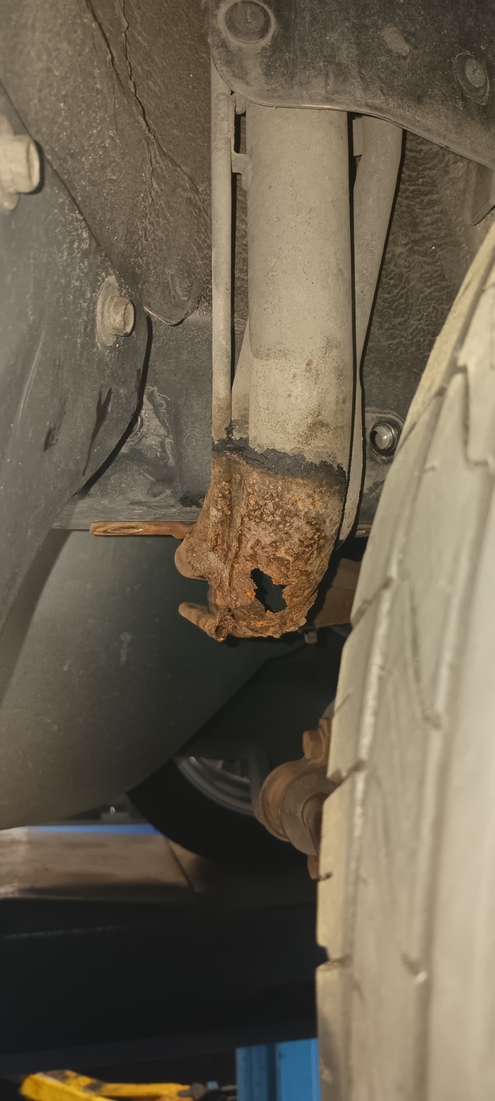

See attached image. It was definitely the fuel filter neck; it was completely rusted out on the bottom. I ended up buying the OEM part MR573836 off eBay for about $190 after tax (see 2nd pic). The OEM part is metal whereas aftermarket fuel filler necks are plastic. I've also been having some issues with aftermarket parts not always being an exact fit. Anyway, we got the new part on there and the leak is gone, and so far, the P0442 code hasn't come back. It seems the P0442 code is common on these cars, so anyone reading this with that code on a 2000-2005 Eclipse should check the fuel filler neck. Since it's metal it rusts out over the years.
