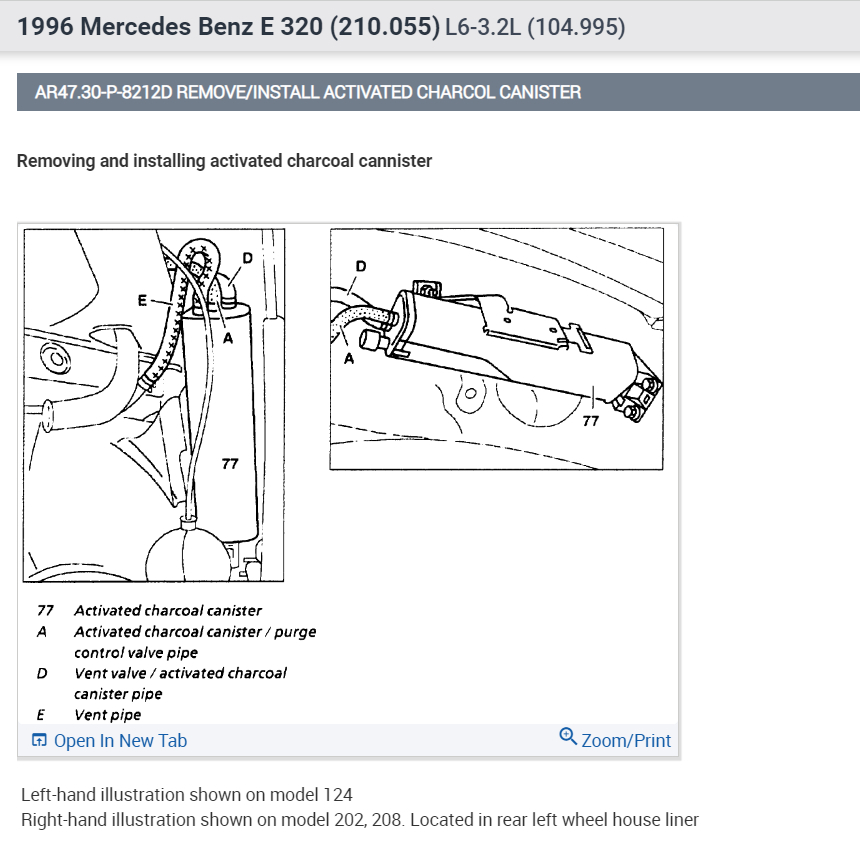

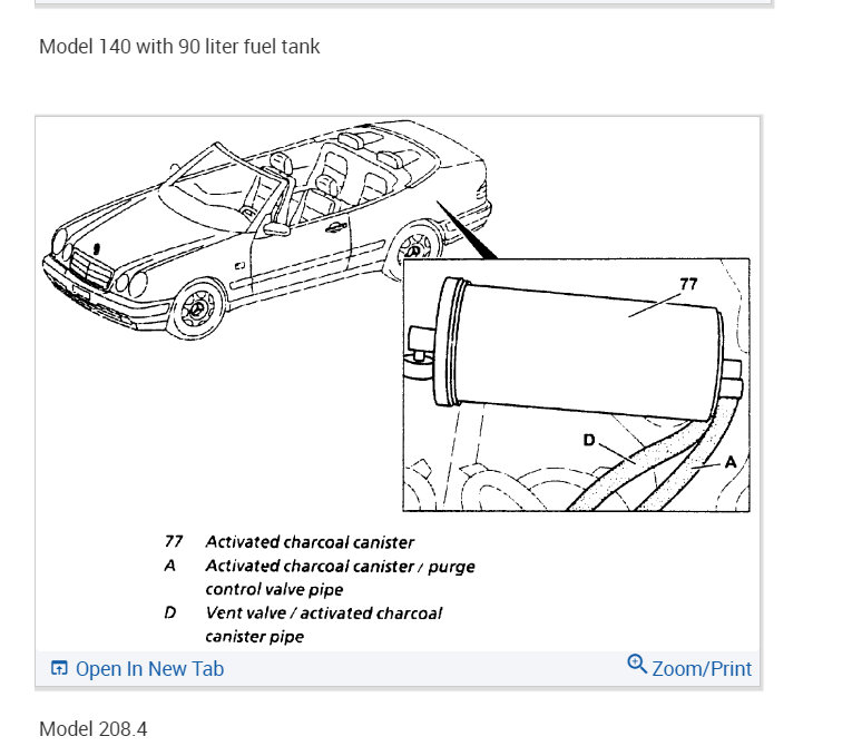

Leaking fuel from a box like with hoses located by the top rear of the right rear tire
65,000 MILES • 6 CYL • 2WD • AUTOMATIC
FERNANDO VINCETTI
The leaking sometimes goes away, then starts again, with the engine off.
Jul 4, 2022 at 7:28 AM
  • 55,732 POSTS

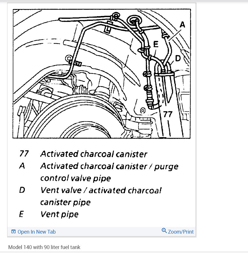

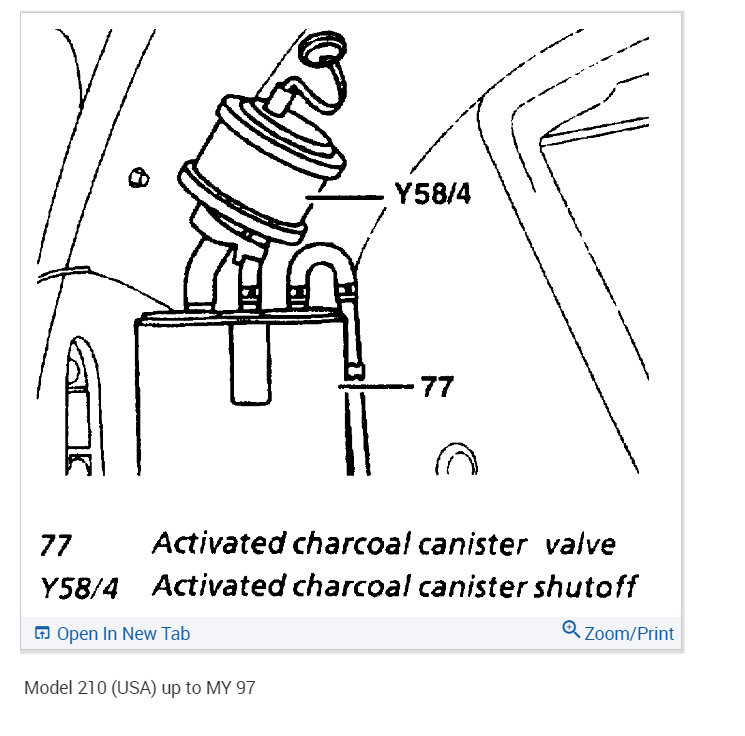

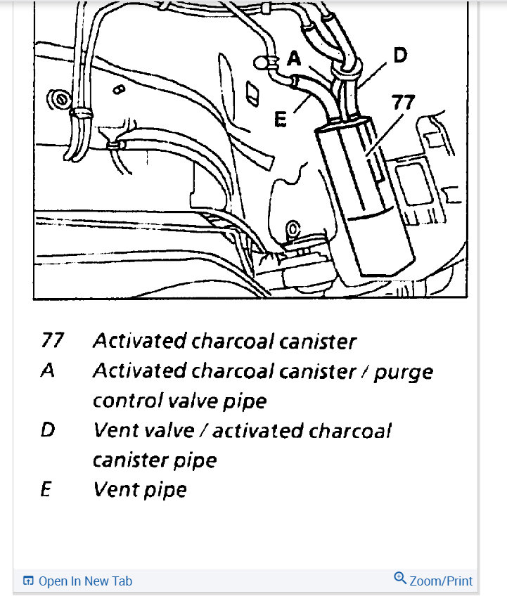

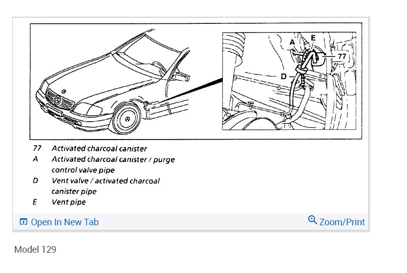

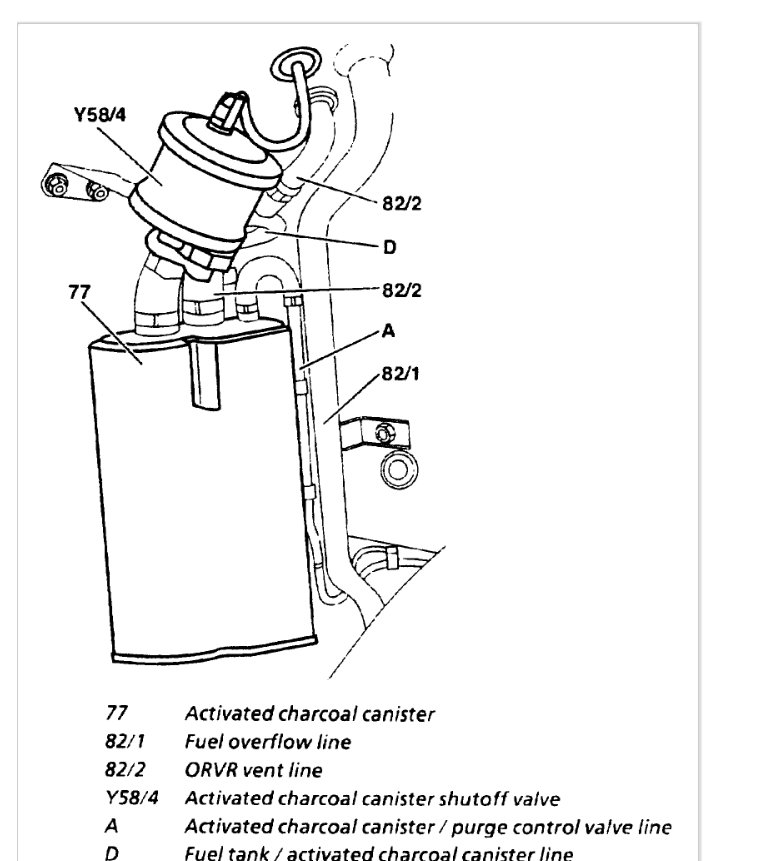

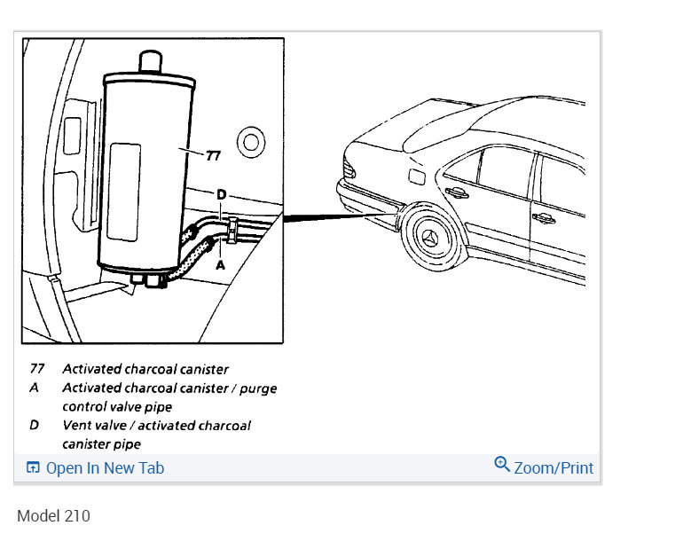

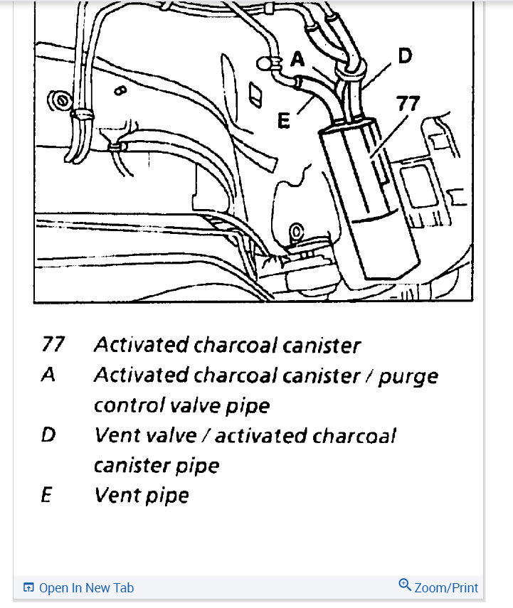

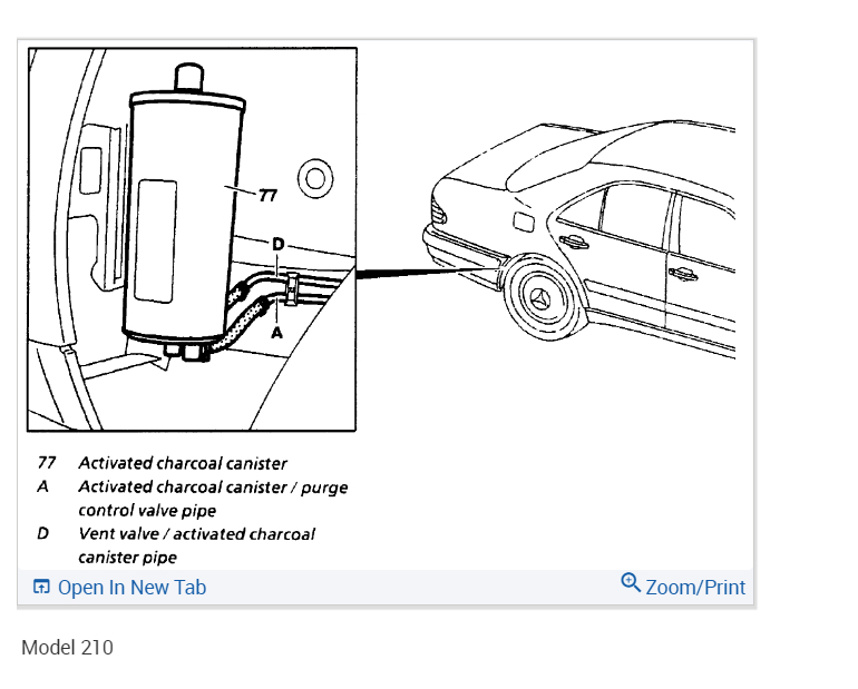

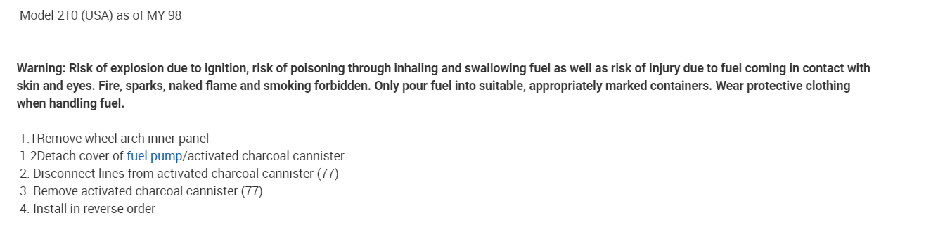

Yep, this sounds like it's because the EVAP vapor canister is bad. here is the location so you can replace it. Check out the diagrams (below). Let us know what happens and please upload pictures or videos of the problem.
