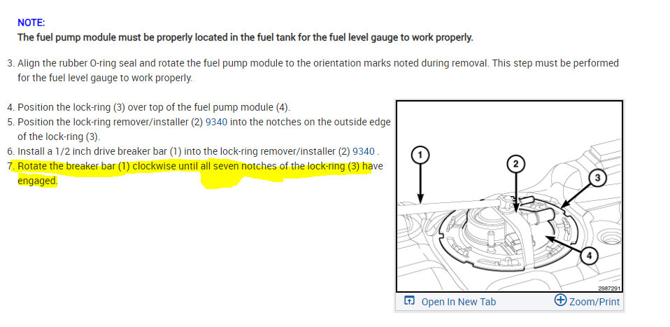

Put in a new pump assembly cause the fuel level was not showing. I went to put some fuel and i saw a spot underneath the car. Is there a common issue with these? No fuel on top from the hoses around the pump.

There really isn't anything common as far as a fuel leak. If you are seeing it under the vehicle, is it near the fuel tank? Have you inspected the fuel lines?
Let me know where you are seeing the leak. Also, let me know what size 4 cylinder this is. It came with a 2.0L, 2.4L, or a 1.4L turbo.

2.4l, right under the tank where the heat shield is. All lines on top at the pump are dry.

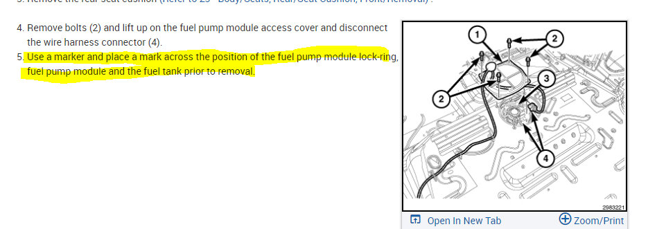

Is there any evidence of it leaking down the side of the tank? When you installed the new pump assembly, was the rubber gasket properly aligned and have all seven of the retainer (see pic 1 below) notches locked? Is the fuel pump module in the same position as the original one was? See pic 2. Those are the directions for removal. The three items need to be in the same position as when they were removed for the fuel level to read properly and to properly seal.

Yes, nothing is leaking from the top. I am sure. i sobe several pumps and familiar with the notches and ring.
