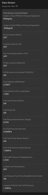

I am trying to post screenshots of a data steam that I was able to pull regarding fuel pressure.

It keeps saying the image was added, but it isn't showing for me. I will try one more time here and upload it to imgur too.
This was captured while the car was turning over..
https://imgur.com/a/kgnYogu

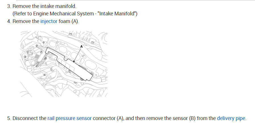

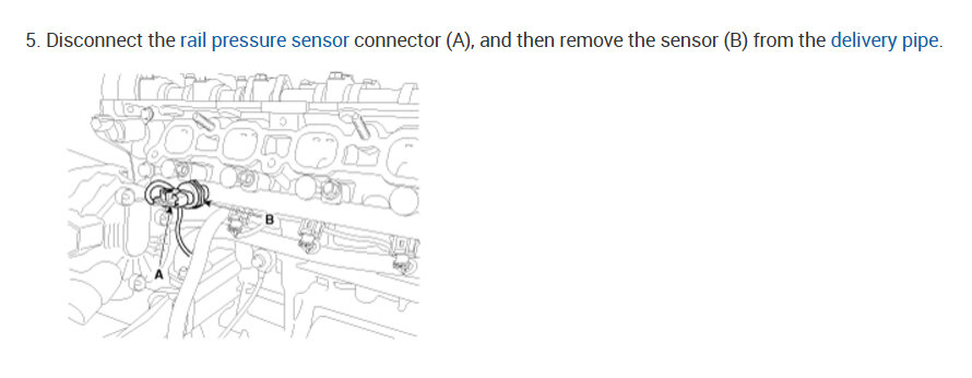

  • 55,676 POSTS
So, I have seen the fuel pressure sensor on the fuel rail cause this issue. I would start by replacing the sensor and then clear the codes once the repairs have been completed.
P0087 - Fuel Rail/System Pressure Too Low
P0193 - Fuel Rail Pressure Sensor Circuit High Input
Check out the images (below). Please upload pictures or videos in your response of any problems so we can see what to help you with.
Nov 25, 2024 at 4:37 AM

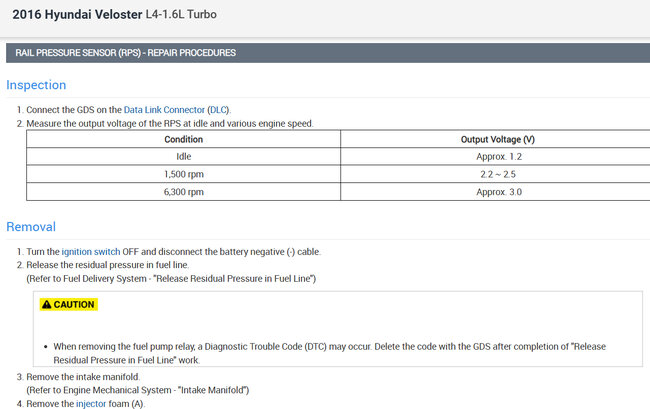

  • 55,676 POSTS

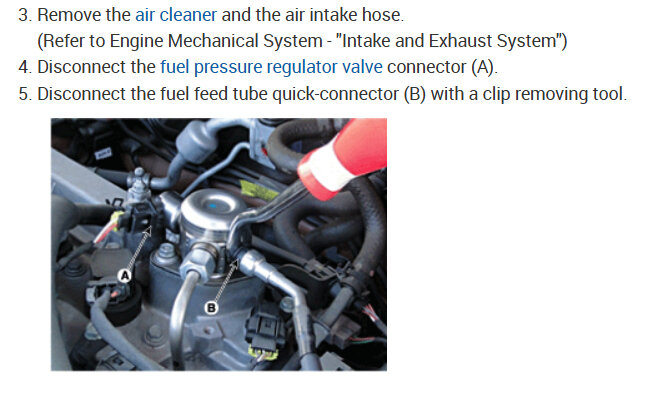

Okay, it can be the high pressure fuel pump causing it as well. Check out the images (below). Please let us know what happens at the repair shop.
