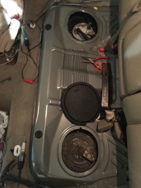

Okay, here is the problem: I was idling the car shut off no luck restarting it, I found a bad fuel pump it was frozen up. anyhow changed the fuel pump, now the issue is the gas gauge op 1/2 low or something to that effect. anyhow, I tried starting fluid I think it backfired one time, checked spark it was good, battery good, starter good. I see when I am cranking the motor the RPMs according to OBD reader are between 233 -300, I didn't power wire test at the pump. It has power the driver module shows power, but I was shocked to find on other side of fuel pump there is a fuel sender unit tested wires to it no power to any of the wire whether the key is off or in the on position or trying to start the car. I was wondering if I could use a jumper wire from the other pump to test the sender or what can I do? is it a wire issue bad sender unit or am I looking at wrong thing? Thank you all be in the spot with every reply, thanks. sorry once again like I said the other question I sent said it failed so I hope I am not sending same question twice. Oh and I forgot to mention while trying to start the car the rpm gauge shows rpms between 232 and 300 so with the rpms moving doesn't that show the crank sensor is working or can that still be dab inertia switch shows power in and out I just remembered this little bit of information so I figured better add it to post above

Yeah, the fuel pump I can hear run, but the fuel sender has no power. Can I make a temporary jumper to see if it is bad or would it be something else? The fuel pump is brand. new power into it I disconnected the hose and fuel spewed up like a water fountain. When looking at the car fuel pump is on passenger side then driver side is what looks like a fuel pump but was told secondary pump or fuel sender unit.

The sender should not have power, just the fuel pump. Can you upload a picture of what you are talking about? Also, did you check for spark?

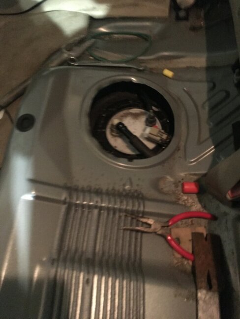

Top of picture is the Fuel pump bottom one is the one they call a secondary fuel pump or fuel sender unit. The one at the top has power at the plug the bottom one has no power at the plug no matter key on key off. I am trying to test when cranking and I took wire plug off of a few coils and tested for power at the coil plug but will that be the same as a spark test or do I need to pull the coil and do it that way instead? thanks for the help.

Thanks for the images. You will need to remove the coils to check for spark. Were you able to go over the wiring diagrams to see how the system works?
