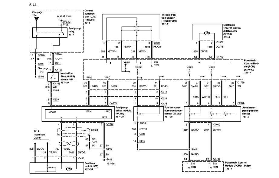

The fuel pump will not kick on. Replaced it with a new one. Still will not kick on. Replaced fuel pump module. Still will not kick on.

Did you verify power to the pump?

Here is a diagram for you.
Check the fuse listed for power on both sides. then go to the inertia switch.
