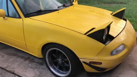

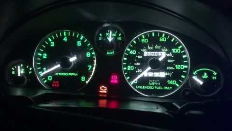

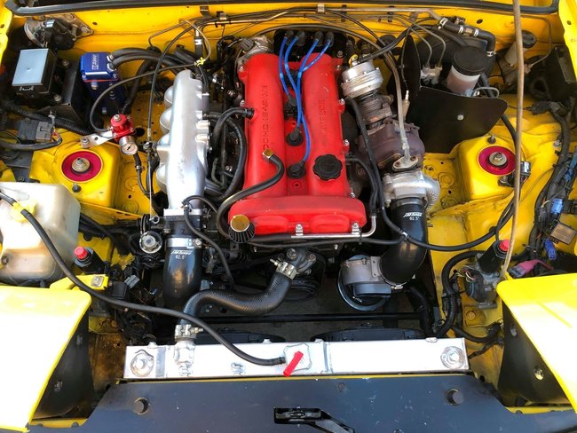

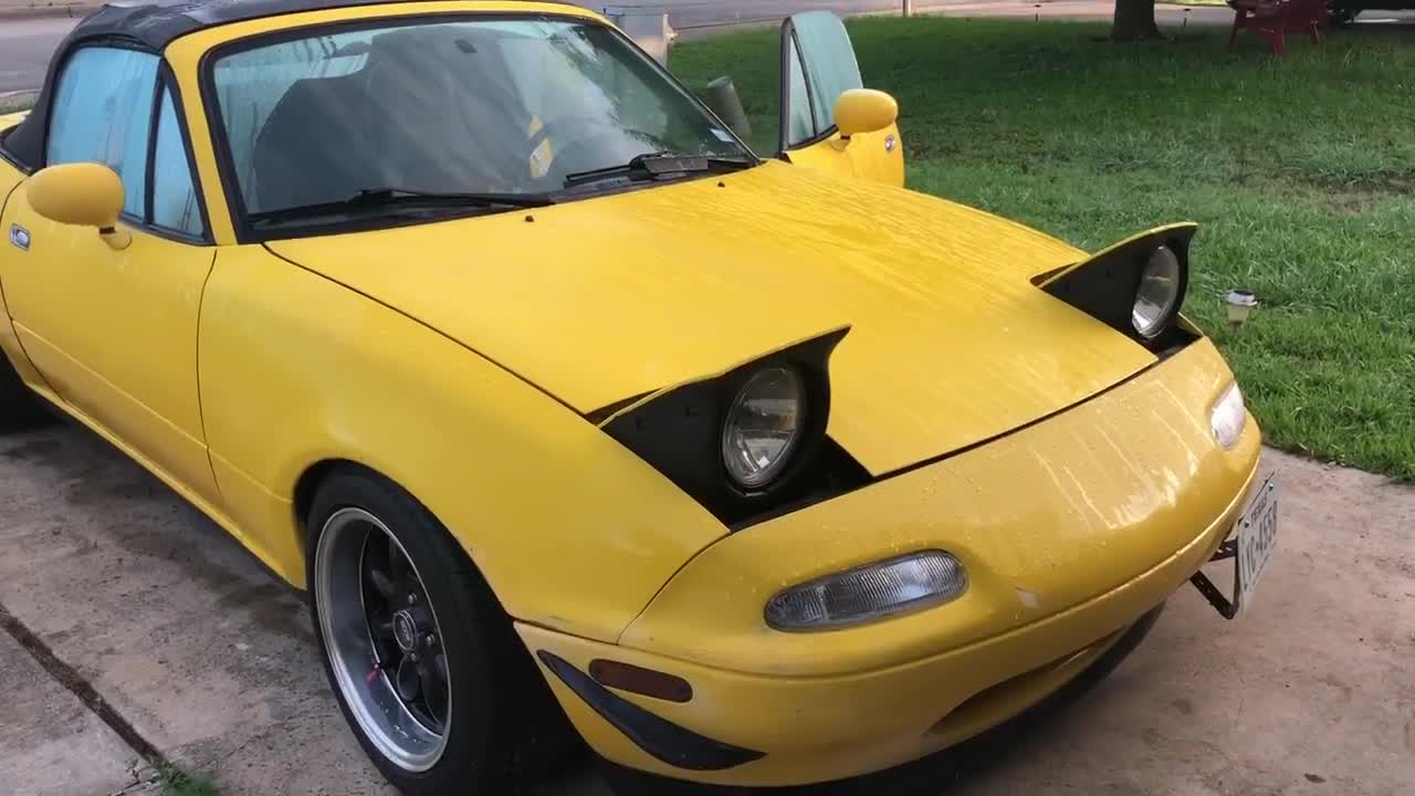

I bought the car listed above that was Turbo'd, car ran great when driving it for a week as a daily. Then one day, car shut off when coming to a stop, and wouldn't turn back on but eventually was able to pump the gas pedal and get it back home.
Since then car hasn't been able to maintain an idle. I can go outside, turn the car on and it'll sound fine. After a couple minutes the car will idle worse and worse until it just turns off. If I turn the car on, and even lightly touch the gas pedal, the idle will do the same thing and idle back and forth from 200 to 600 rpm range.
I was thinking it would be something fuel related like injectors or something but I have no idea how I would even diagnose this issue. I've replaced spark plugs and spark plug wires. all fluids are fairly new and look like they should. Car has fresh 93 pump gas.

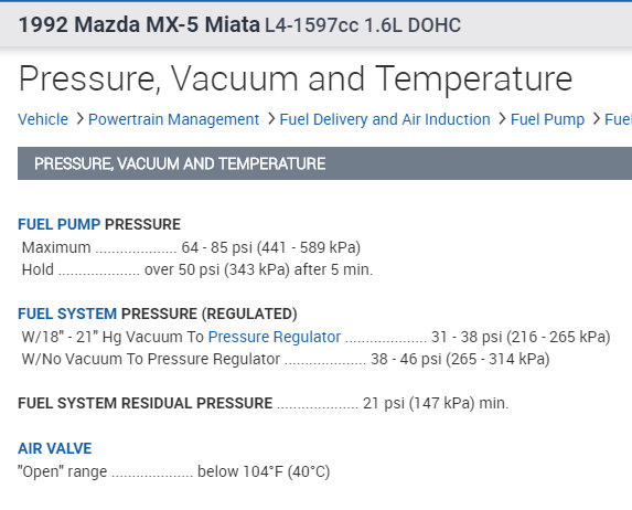

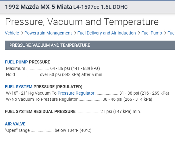

Have you tested the fuel pressure ? If you don't have a fuel pressure tester then most auto parts stores have a tool loaner program and can rent you one. Here is a tutorial showing what's involved:
Sounds like a weak/defective fuel pump. Get back to me after a fuel pressure test. I've attached a picture below with fuel system specifications.Hope this helps and thanks for using 2CarPros.
