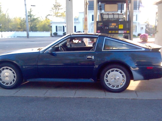

Car cranks, no start. The fuel pump works but do not know if it is getting full power, for the injectors to fire. Pump harness is damaged from moisture in rear hatch. Should I repair the wire to get full power to the injectors?
Or is it a bad ground also? Thank you, Gary
