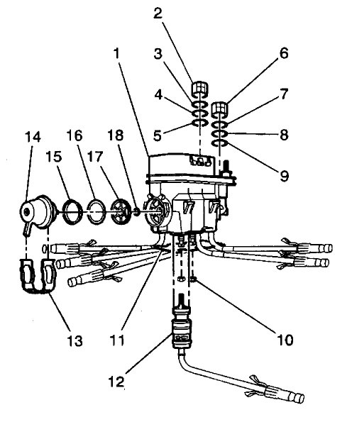

How many fuel injectors are in a V6 engine?
Sep 29, 2016 at 6:34 PM
JIS001
  • CAR REPAIR CONTRIBUTOR
  • 3,412 POSTS

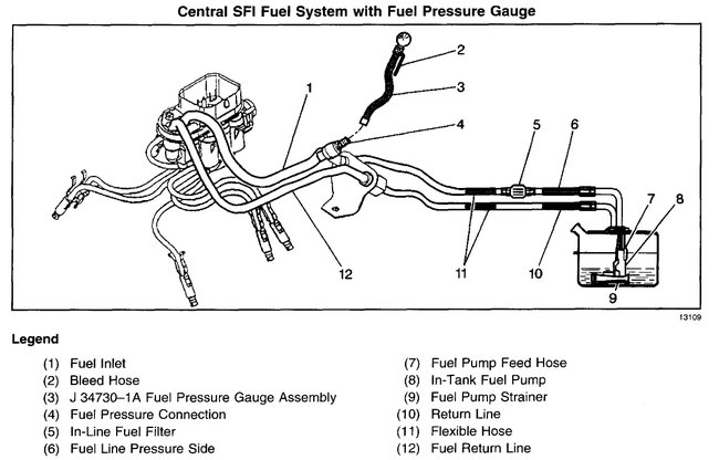

There are six injectors. One for each cylinder. You have the spider design underneath the intake plenum. Check out the diagrams (Below). Please let us know if you need anything else to get the problem fixed.
