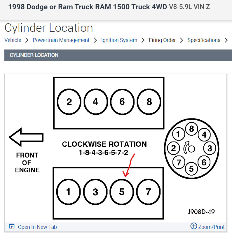

I don’t know the numbering for the injectors I need to replace one for cylinder 5 for misfire P0305. the numbers labels ripped off and don’t know what fuel injector goes to cylinder 5.

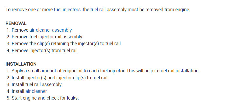

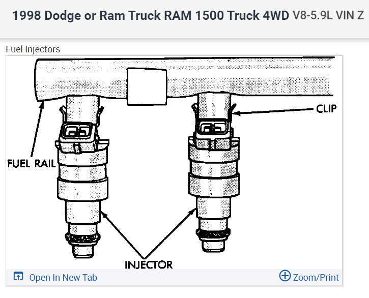

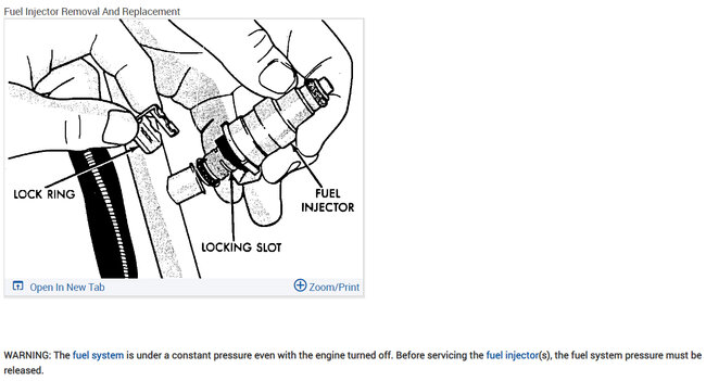

Here is the engine cylinder ID so you replace the correct fuel injector, also I have included instructions on how to do the job. Here is a generic guide to help you step by step with instructions in the diagrams below to show you how on your car.
https://www.2carpros.com/articles/how-to-replace-a-fuel-injector
Check out the images (below). Let us know if you need anything else.
