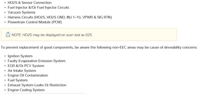

before you get into that be aware that it can be any of the things listed causing the problem. this includes air leaks, like engine grommets or holes in duct work leading to engine, or vacuum leaks. See pictures for testing it still can be a bad PCM as well. disregard first two pictures.

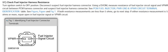

I have found some wiring diagrams and a couple of guises to help you get the problem fixed.
https://www.2carpros.com/articles/how-to-test-a-fuel-injector
and
Please run some tests and get back to us so we can continue helping you.
May 8, 2017 at 10:06 AM

I ran some test on the injector today (what I could), the first test was with a long screw driver and I did hear the clicking noise plain as day, I did the same with a different injector and I noticed a different sound of clicking, I didn't know if that mattered or not.
I also used a multimeter with the ohms setting with the ignition off, the harness gave a reading of 172.2, injector gave no reading.
So what should I do next? Thanks for your help!
Jun 25, 2017 at 5:13 AM

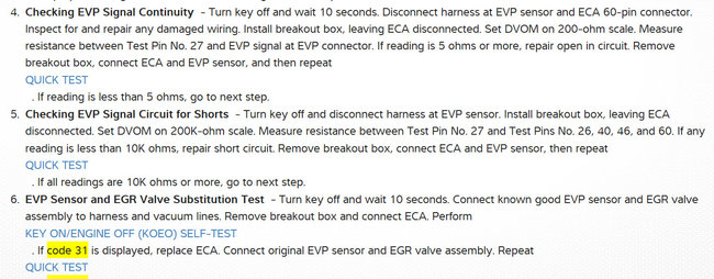

HMAC300
  • 48,601 POSTS
sunds like the harness is bad should only be 5 ohms from injector to pcm. tan wire and violet wire to ground should be same. also check for wire to be rubbing engine on block that may be problem. also check resistance of injector should be 11-17 ohms or around there.

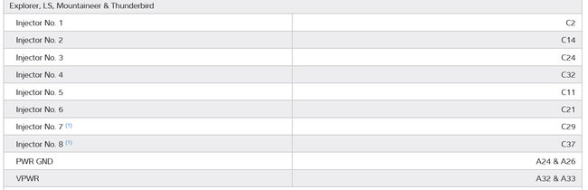

it cold be either if you check the wire back to pcm and it reads 5 ohms or less then it's the pcm probably but that you shold have verified first as a mechanic has to program the new one to your vehicle.check the tan wire to pin #2 on pcm if no reading or h igh on ohms then it s wire
Jun 28, 2017 at 2:33 AM
TMCINTOSH11
  • 176 POSTS
So would I have to disconnect the harness from the pcm? I'm not sure which one it is because I tried to follow the wires from the injector and they go down behind the motor and as far as I can tell it goes into the top harnessvon the pcm. I thought there would be another connection harness between the pcm and the injectors but I think the wires go straight into it, not sure. I don't suppose that cleaning some ground wires would help. Thanks!
Jun 28, 2017 at 8:30 AM
HMAC300
  • 48,601 POSTS
yes you disconnect the harness on the pcm and be careful not to bend any pins.removing and reinstalling harness. the plastic connector will be marked by numbers where wires are just make sure it's the correct color and number to check which I have given you previously. use dielectric compound when re installing for better contact. usually sold as bulb grease on counter at auto parts for around $2

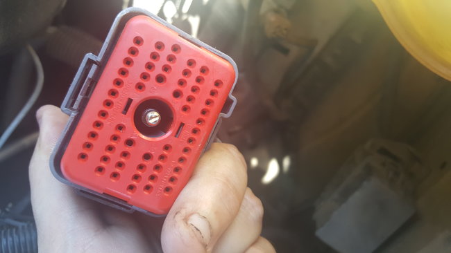

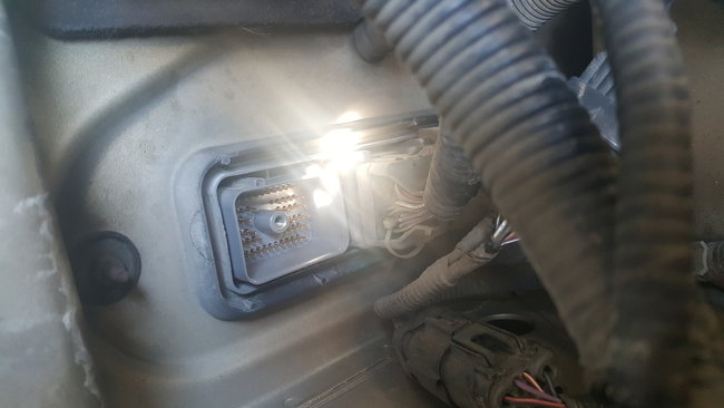

TMCINTOSH11
  • 176 POSTS
Im trying to get a reading on the pcm harness and Im having any luck, I don't think my multimeter pin won't fit down far enough to get a reading, I also couldn't get a readind on the pcm itself, am I doing something wrong? I took a picture of the pins and the harness to show you where Im at, is the battery suppost to be disconnected? Let me know, thanks!
Jul 2, 2017 at 1:09 AM
HMAC300
  • 48,601 POSTS
if your multimeter won't fit you'll need something that will like either a pin or maybe a paper clip to take the reading.

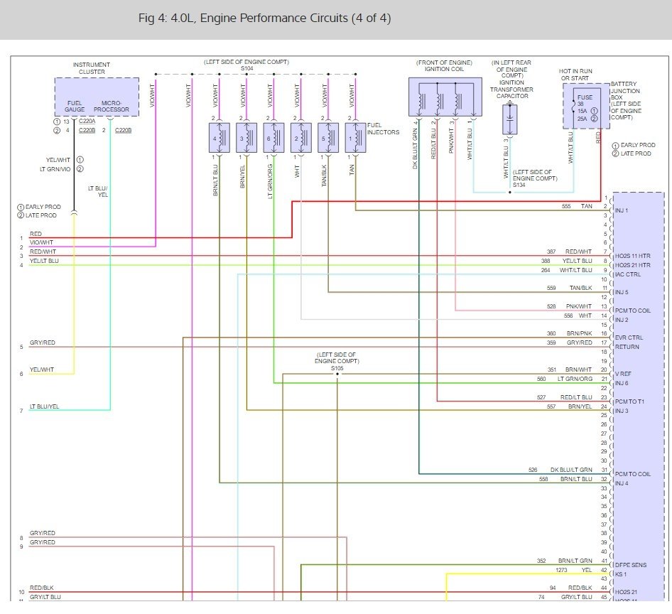

I dug through the wires on the harness to find the tan one you told me about and it went to the no. 2 pin hole and it didn't give me a reading on ohms, it was bundled with the other wires in really thick insulation, it runs all the way down to back behind the intake so following it is pretty hard. At least I know what I'm looking for now, thanks for all your help!
Jul 2, 2017 at 11:33 AM
  • 55,381 POSTS
Check the wiring diagrams on the third post you can see the wiring and where it goes.
Please let us know what happens, we are interested to see what it is.
Jul 2, 2017 at 12:02 PM
HMAC300
  • 48,601 POSTS
you should get 0 -5 ohms on wire if that is what you are getting it's ok if infinity then it's broke someplace

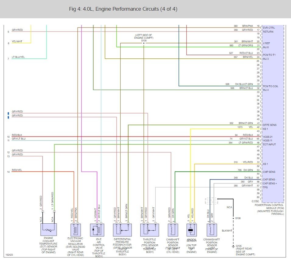

I looked at the diagram ken provided and it looks like the tan wire goes straight into the pcm and the purple wire goes to the idle air sensor ontop of the throttle body, the tan wire was the one that didn't light up the test light. If the wire is good then does that mean it's the pcm or should I run some tests else where? Thanks!
Jul 3, 2017 at 5:38 AM
