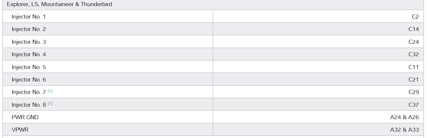

I recently found out that I have a problem with my SUV it is the xlt model that is related to the fuel injection circuit. I am not sure if it a harness or the injector itself but I just need to know how I go about getting to the injectors and harness for this model and if there is anything important I need to know when attempting to replace one of the two if not both if I decide to. It is giving me the P0201 code. by the way, thanks!

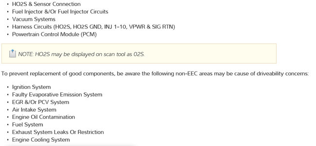

before you get into that be aware that it can be any of the things listed causing the problem. this includes air leaks, like engine grommets or holes in duct work leading to engine, or vacuum leaks. See pictures for testing it still can be a bad PCM as well. disregard first two pictures.

I have an update on the injector circuit problem, I ran a few test and I replaced the injector harness, so far nothing has changed, it accelerates a little better but for the most part it's still running rough at times and it's all pointing to the injector itself. I wasn't able to check for air leaks yet, I'm still trying to find a cheap and effective way, I was thinking of running smoke through the brake booster air line to check that, I also pulled the codes again and this is what came up:
P0301 cylinder 1 misfire
P0171 fuel system too lean (cylinder 1)
P0201 cylinder 1 injector curcuit malfunction
P1131 lack of HO2S-11 switching
That's all I have for now, I'm going to test the compression in cylinder 1 tomorrow to make sure that's ok, let me know what you guys think, thank you!

I ran some test on the injector today (what I could), the first test was with a long screw driver and I did hear the clicking noise plain as day, I did the same with a different injector and I noticed a different sound of clicking, I didn't know if that mattered or not.
I also used a multimeter with the ohms setting with the ignition off, the harness gave a reading of 172.2, injector gave no reading.
So what should I do next? Thanks for your help!

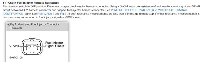

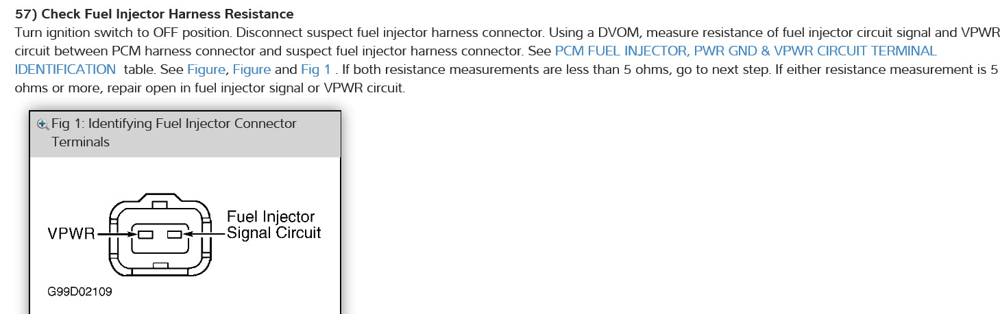

sunds like the harness is bad should only be 5 ohms from injector to pcm. tan wire and violet wire to ground should be same. also check for wire to be rubbing engine on block that may be problem. also check resistance of injector should be 11-17 ohms or around there.

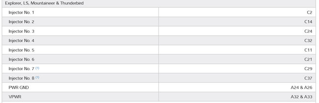

it cold be either if you check the wire back to pcm and it reads 5 ohms or less then it's the pcm probably but that you shold have verified first as a mechanic has to program the new one to your vehicle.check the tan wire to pin #2 on pcm if no reading or h igh on ohms then it s wire

yes you disconnect the harness on the pcm and be careful not to bend any pins.removing and reinstalling harness. the plastic connector will be marked by numbers where wires are just make sure it's the correct color and number to check which I have given you previously. use dielectric compound when re installing for better contact. usually sold as bulb grease on counter at auto parts for around $2

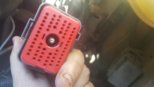

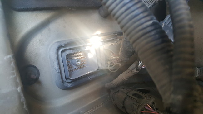

Im trying to get a reading on the pcm harness and Im having any luck, I don't think my multimeter pin won't fit down far enough to get a reading, I also couldn't get a readind on the pcm itself, am I doing something wrong? I took a picture of the pins and the harness to show you where Im at, is the battery suppost to be disconnected? Let me know, thanks!
Jul 2, 2017 at 1:09 AM
HMAC300
  • 48,601 POSTS
if your multimeter won't fit you'll need something that will like either a pin or maybe a paper clip to take the reading.
Jul 2, 2017 at 1:27 AM

Ok, I got a thin piece of copper and put it in the pin hole of the harness and it didn't give me a reading at all, I also had the battery disconnected, does this mean it's the wire? Thanks

I guess Im gonna assume it's the wiring since I didn't get a reading on the harness, I put it all back together after I put a dab of dielectric grease on the pins, it still runs the same. So should I be looking for a separate harness for the injectors or do they go straight into the pcm? Thanks!

first make sure it s the correct wire going to correct pin then do a reading again if no reading like ohm wise then start tracing the wire and connections then fix the wire if wire is pinched or broken

I dug through the wires on the harness to find the tan one you told me about and it went to the no. 2 pin hole and it didn't give me a reading on ohms, it was bundled with the other wires in really thick insulation, it runs all the way down to back behind the intake so following it is pretty hard. At least I know what I'm looking for now, thanks for all your help!
Jul 2, 2017 at 11:33 AM

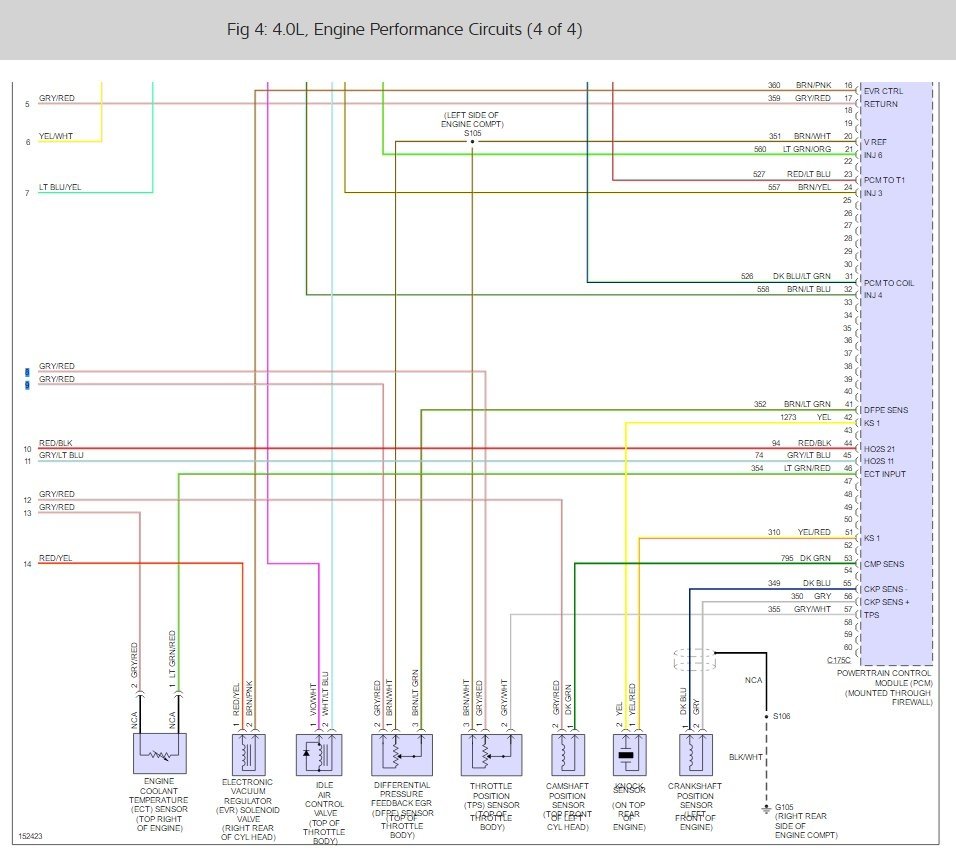

  • 55,694 POSTS

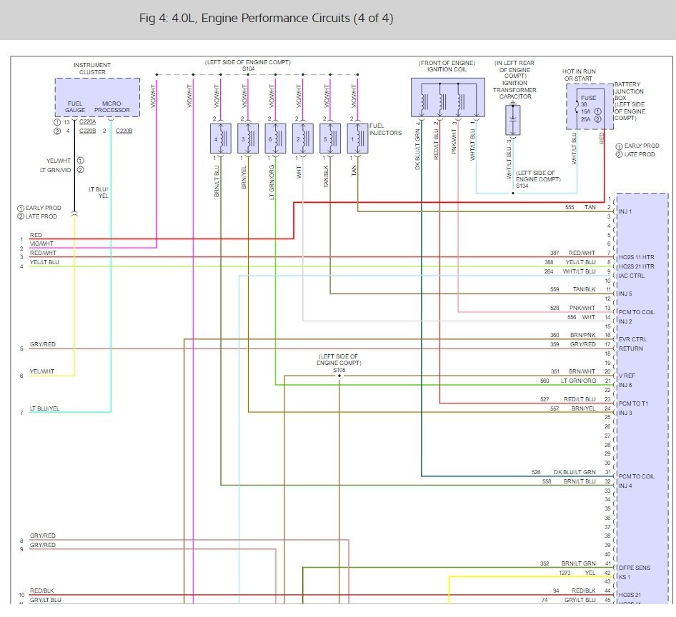

Check the wiring diagrams on the third post you can see the wiring and where it goes.
Please let us know what happens, we are interested to see what it is.
Jul 2, 2017 at 12:02 PM
HMAC300
  • 48,601 POSTS
you should get 0 -5 ohms on wire if that is what you are getting it's ok if infinity then it's broke someplace

Yeah I set my multimeter to the lowest setting on ohms and it it didn't budge, I even tested the multimeter to make sure it was working right and it was. I traced the wires from the injector as far back as I could and didn't notice any frayed wiring.

I looked at the diagram ken provided and it looks like the tan wire goes straight into the pcm and the purple wire goes to the idle air sensor ontop of the throttle body, the tan wire was the one that didn't light up the test light. If the wire is good then does that mean it's the pcm or should I run some tests else where? Thanks!
