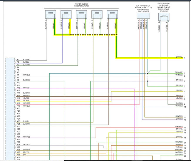

Car listed above will crank, getting fire and gas, but the injectors are not kicking on. Checked everything that I was supposed to, but everything comes back normal, but the injectors won’t come on, and I can’t figure it out.

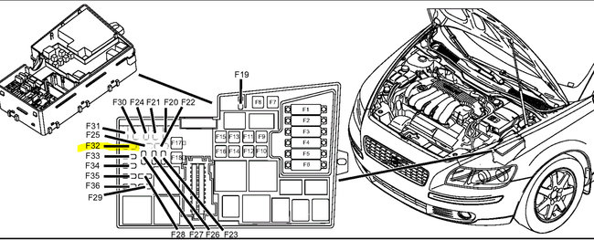

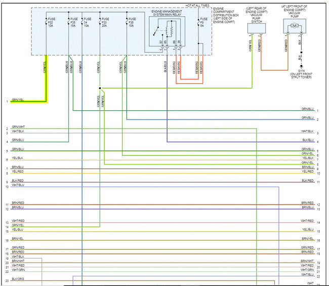

Is fuse 32 in the under-hood fuse box good? If you checked it, did you also check for power to and from the fuse?
Next, here is how it works. Power to all injectors is constant from fuse 32 with the key in the run or start position. From there, the PCM provides a ground path at specific times to each of the injectors to complete the circuit and fire the injector.
I attached the wiring schematic below showing the power supply. It's highlighted. If you are not getting power there, it's between the fuse and injectors. If you are getting power, then it sounds like there is no ground path being provided by the PCM.
Let me know what you find.
See pics below. The last pic identifies fuse location.
