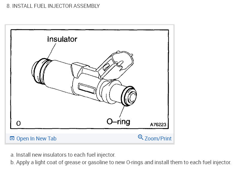

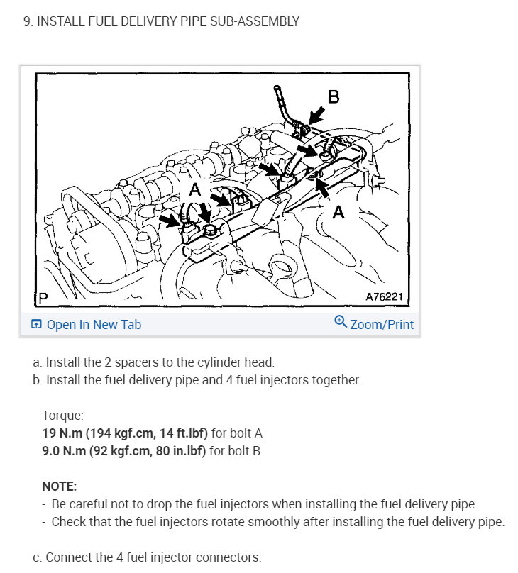

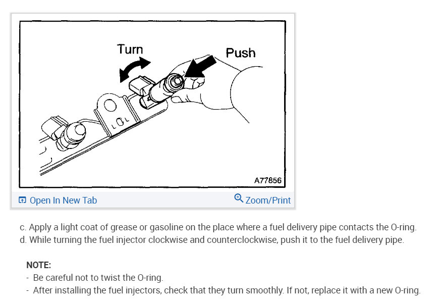

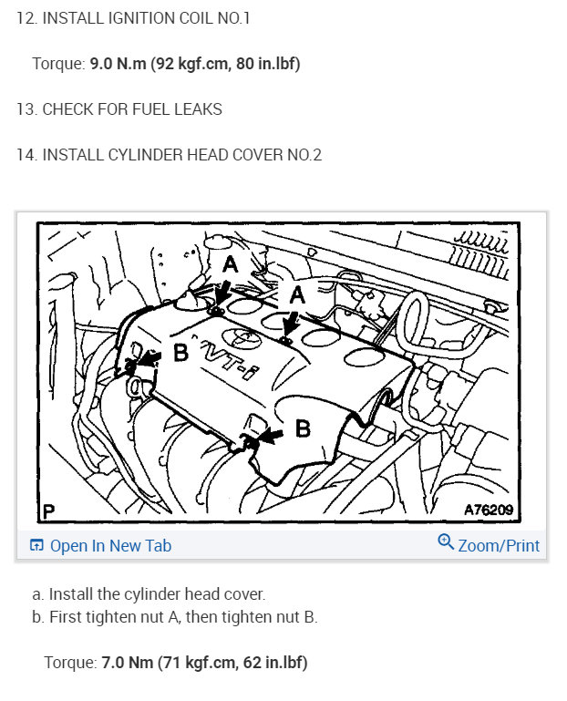

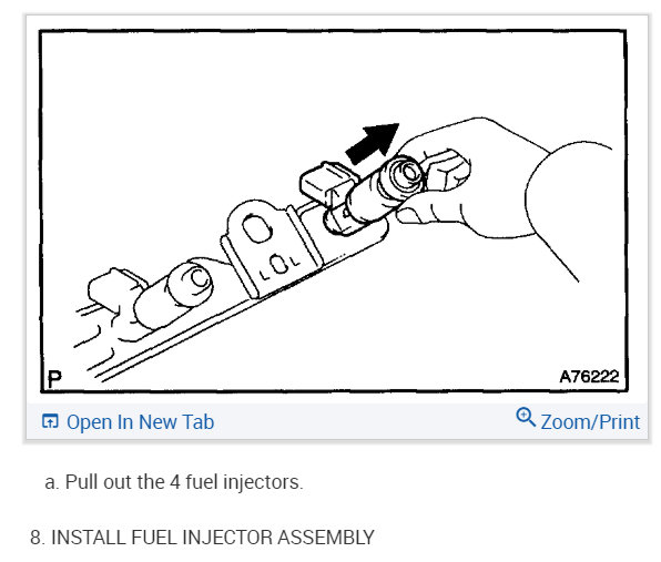

I replaced the fuel injectors on my car and I can't seem to get them to seal right. is there a torque spec or something that I'm not doing right that is it keeping leaking gas out the top? I've tried a different gaskets on it, I'm just not quite sure what to do with it anymore.
Feb 8, 2019 at 2:59 AM
SCGRANTURISMO
  • 4,897 POSTS
Fuel injectors should have nitrile rubber o-rings on top and bottom of the injector. When installing the injectors into the fuel rail and the intake manifold or head, wherever the bottom gets pushed into, you should lightly grease the o-rings and make sure that they go into where they are going snugly and solidly. Ensure they are pushed into their sockets all the way. Tighten the fuel rail fasteners to specs and you should have no problem with them leaking. I hope this helps.

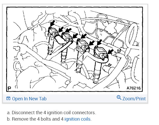

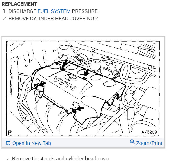

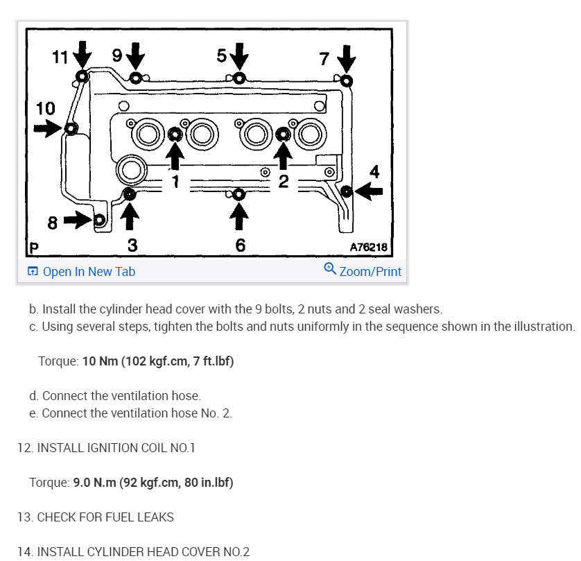

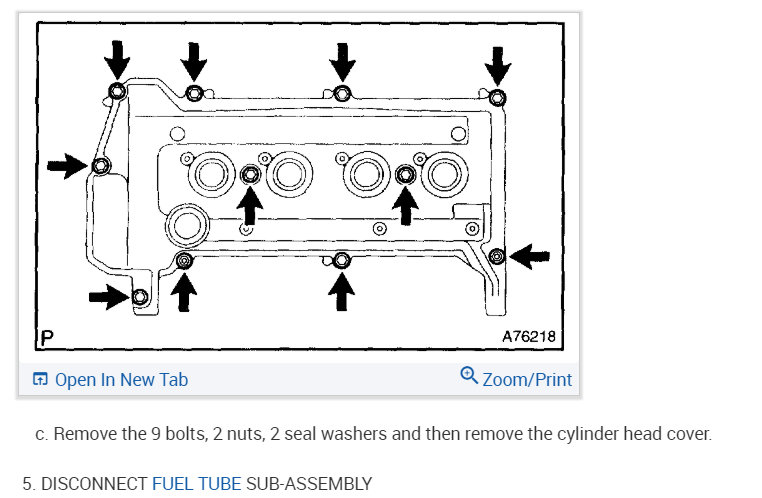

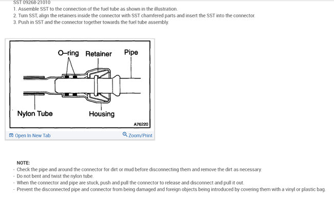

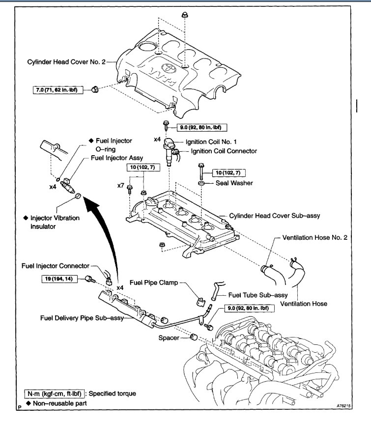

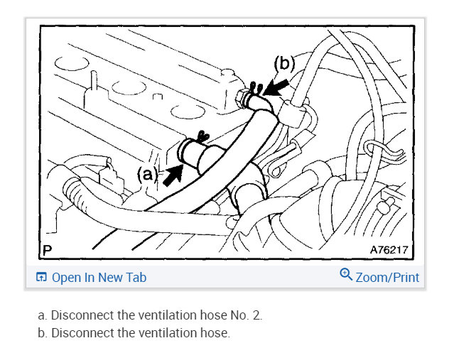

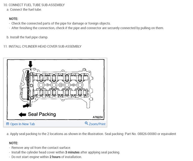

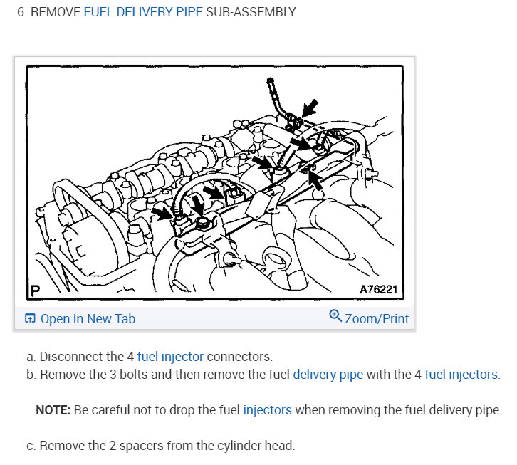

Here is a guide to help walk you through the steps of changing the fuel injector and instructions and diagrams below so you can see how to do the job on your car:
https://www.2carpros.com/articles/how-to-replace-a-fuel-injector

It was the top of the number two injector the o-ring was pinched. thanks for the help guys I really appreciate it.
