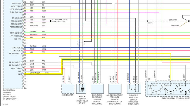

Hello, do you own a basic multimeter? There is either a short to ground on the control wires of the injectors and keeping them on, or they both shorted out and excessive current flow burned the fuel injector drivers in the ECM. I think the idea of the wires being shorted to ground is more likely, (hopefully), because the injectors control wires probably run together to the ECM. So, unplug the injectors, leave the key off, and check for continuity to ground with a multimeter on the control wires. These cars are very easy to work on, I owned one of these years ago. The ECM is located on the passenger side front of the engine compartment. I'll get you the diagrams and show you exactly what to test.
Jul 28, 2022 at 6:29 AM
AL514
  • 5,639 POSTS

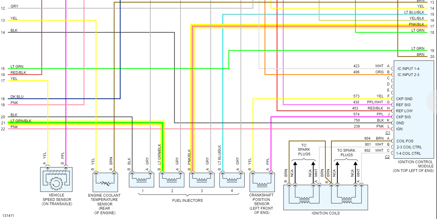

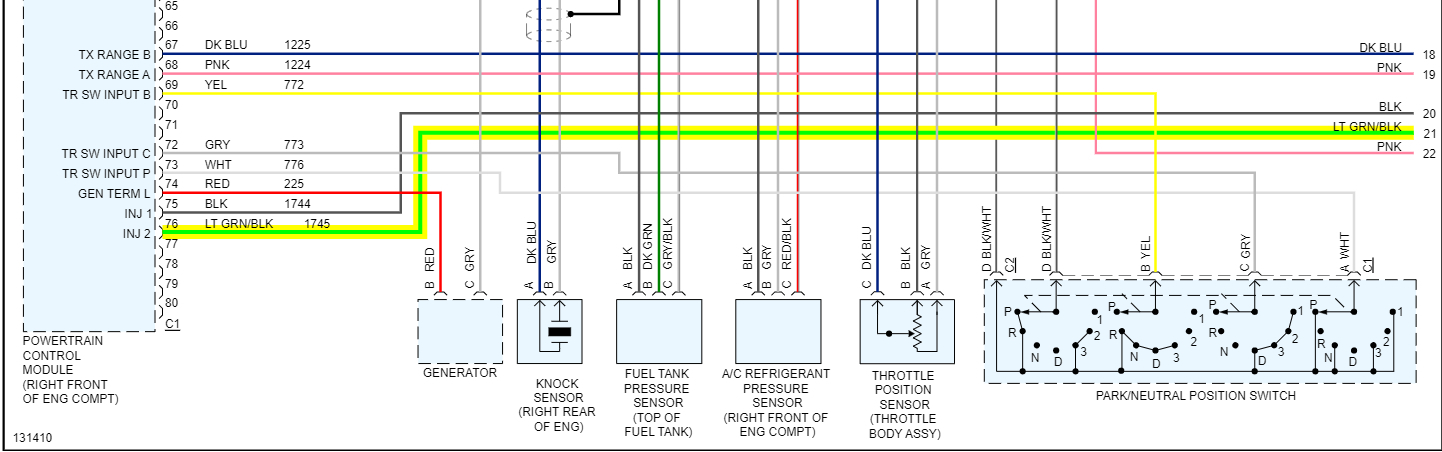

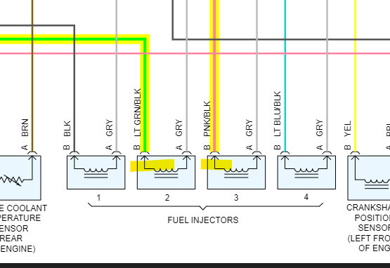

So, unplug Fuel Injector 2, set your multimeter on Ohms setting, just touch on meter lead to the light green/black wire of injector 2 (don't push the meter lead into the fuel injector harness you will spread the harness connector pins, so just touch the pin) and put the other meter lead on battery negative, it shouldn't read close to 0 ohms. If it does that wire is touching ground somewhere on the engine or frame before it gets to the ECM. If it does not read 0 ohms, it should read very high resistance or OL. Then check the resistance of the Fuel Injector itself, it should have a resistance reading of 12 to 14 ohms. Check them all this way. A shorted injector will burn the power transistor in the ECM and it will conduct all the time or not at all.. Has the Check Engine light been on? Are you getting any codes?
The pink/black wire is the control wire for injector three.

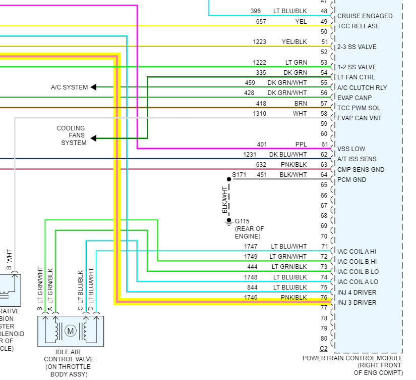

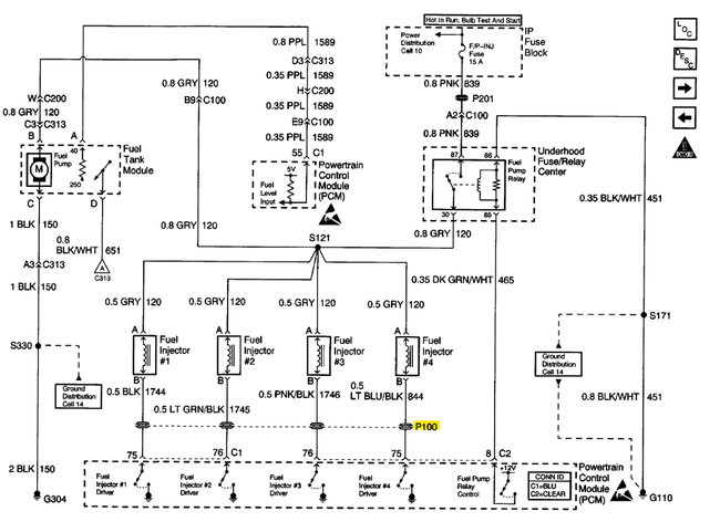

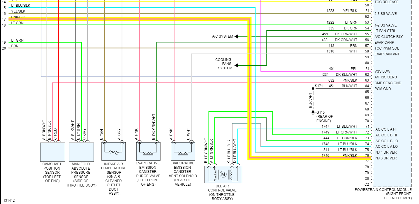

Okay, I'm not sure what you mean by free minute there. Let's start this again. You're getting a pulse on the control side of numbers 1 and 4, and on 2 and 3 the test light just stays lit. So, you're back probing the injector connectors for a pulse, so if 2 and 3 are just lighting the test light, that sounds like an open circuit in the control side of 2 and 3. The power feed is just going through the injector and lighting your test light, it's not being pulled to ground. So yes, you'll need to track down those control wires (2 and 3) and see where they are opened circuit or high resistance. I would think you are most likely going to find a corroded bulk connector somewhere. Unless some rodents got in there and chewed through a couple wires, that happens all the time, they love to chew on wires, I've seen that more times than I can count. Hopefully that's what it is, so there's no damage to the computer drivers.
This is the OEM diagram for the injectors circuit, it doesn't show any connectors, just right to the ECM, and knowing these ECMs, you might want to check the ECM connectors for corrosion. I know they keep the computers in the engine compartment, and they are not really protected from the elements very well. And considering the age of the car, it might be easier just to trace the wires right from the ECM out. I had some strange issues with one of these cars, I had to go and test right at the ECM to find the issue.
Let's hope it's just a wiring problem, which would be good.
The P100 highlighted in yellow is just a grommet, not a connector.

So, I just need to follow out the pink and black wire and the green light green and black wire and follow my way to the computer especially is what you're saying, right?
Jul 29, 2022 at 10:10 AM
AL514
  • 5,639 POSTS
Yes, if you have just power sitting on the control side of the injector and it's not pulsing, that means there's an open on those circuits or high resistance somewhere down the line. If they were both staying on, i.e. the driver had burned, and was keeping it on all the time. You would read 0 volts on the control wire because it was being pulled to ground. I know DC voltage is different than AC which is probably what you work with. I couldn't tell you much about AC voltage except that it's really bad for the ECM , and we just check for it is coming from a bad alternator. But yeah, the light green/black wire (2) and pink/black wire (3).

Yes, but unplug the ECM connector they go to and then you can check the circuit from both ends, ECM on one end and injector on the other. That continuity test will tell you if there's an open and the go ECM harness to Ground, and if there's nothing wrong that covers the wiring aspect of things. I'll find the ECM connectors. Just because these ECMs are easy to get to and unplug, just have the key off. This will be fast and easy cause both of these Injectors are the last 2 wires in connectors C1 and C2.
And were the 10volts on the feed side or the control side? Also, the Injector unplugged resistance was 17 ohms, is that correct? I'm just making sure we have all our information here clear. If you have only had 10volts on the feed with them unplugged I would be worried about that too. Unplugging the ECM will take it out the of picture so you're not reading any resistance through it to ground.
