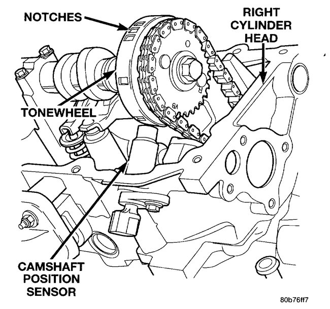

I can jump the injectors straight from the battery and they open up and spray fuel but not when I crank the engine. I have got 12 ohms across the injectors and 2-2.5 volts when cranking. Is that too much resistance? Not enough voltage? I cannot find any specs for this. I have got spark and pressure in the rail, but the injectors will not open unless I jump them. Any information would be appreciated because I am ready to take a hammer to it!
Oct 1, 2018 at 6:50 PM
  • 110,194 POSTS

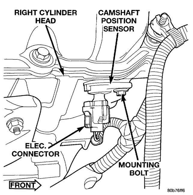

It sounds like you may have a problem with the camshaft position sensor (CMP). The camshaft position sensors (CMP) contains a hall effect device called a sync signal generator to generate a fuel sync signal. This sync signal generator detects notches located on a tonewheel. The tonewheel is located at the front of the camshaft for the right cylinder head. As the tonewheel rotates, the notches pass through the sync signal generator. The pattern of the notches (viewed counter-clockwise from front of engine) is: 1 notch, 2 notches, 3 notches, 3 notches, 2 notches 1 notch, 3 notches and 1 notch. The signal from the CMP sensor is used in conjunction with the crankshaft position sensor to differentiate between fuel injection and spark events. It is also used to synchronize the fuel injectors with their respective cylinders. I attached a two pictures of the unit and where it is located.
_____________________________________
Here are the directions for removal and replacement:
The Camshaft Position Sensor (CMP) is bolted to the front/top of the right cylinder head.
REMOVAL
It is easier to remove/install sensor from under vehicle.
1. Raise and support vehicle.
2. Disconnect electrical connector at CMP sensor.
3. Remove sensor mounting bolt.
4. Carefully pry sensor from cylinder head in a rocking action with two small screwdrivers.
5. Check condition of sensor O-ring.
INSTALLATION
1. Clean out machined hole in cylinder head.
2. Apply a small amount of engine oil to sensor O-ring.
3. Install sensor into cylinder head with a slight rocking action. Do not twist sensor into position as damage to O-ring may result.
CAUTION: Before tightening sensor mounting bolt, be sure sensor is completely flush to cylinder head. If sensor is not flush, damage to sensor mounting tang may result.
4. Install mounting bolt and tighten to 12 Nm (106 in. lbs.) torque.
5. Connect electrical connector to sensor.
6. Lower vehicle.

Keep in mind, a bad camshaft sensor should set a trouble code. I believe it is P0340. Check for trouble codes.
Let me know if this helps.
Oct 1, 2018 at 7:38 PM
DAVID7090
Hey Joe, thanks for the advice. It was not the CMP, but as I traced the circuit I found where the wiring harness had become pinched and burnt. I replaced the damaged wires and now she is purring like a kitten! Keep up the good work and thanks again for your help! -David7090
