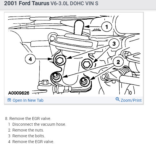

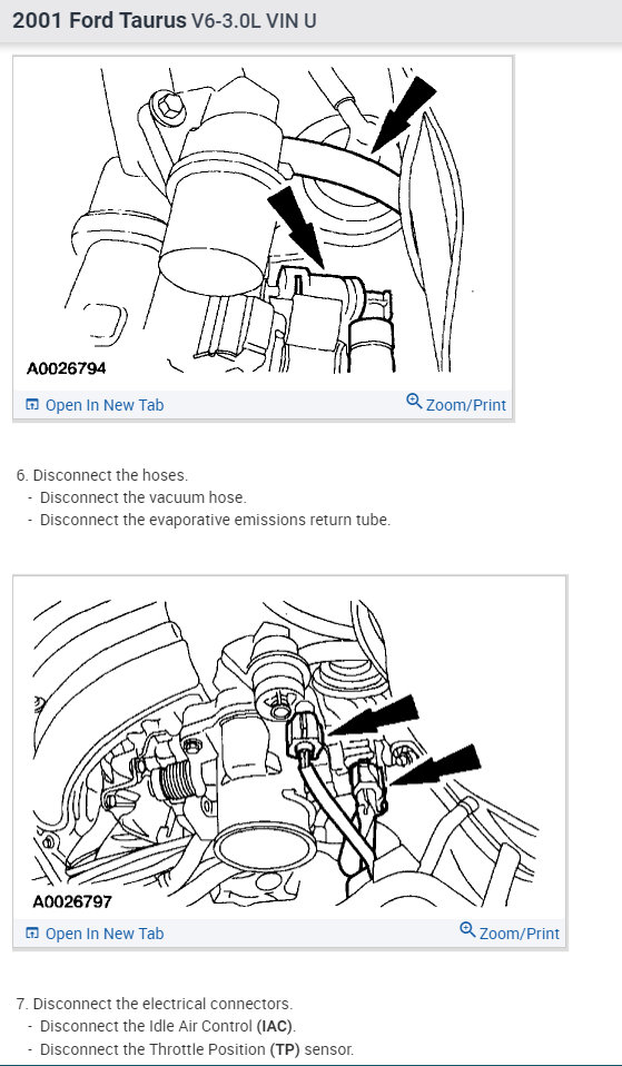

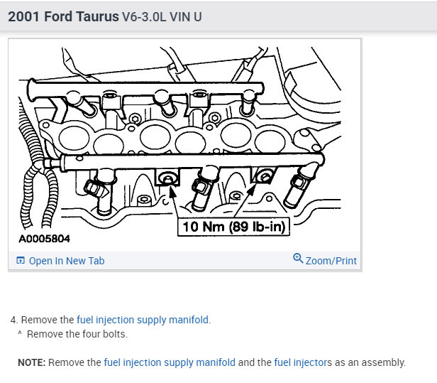

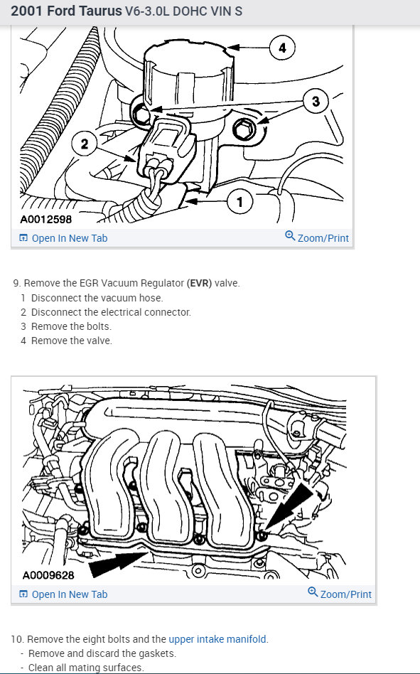

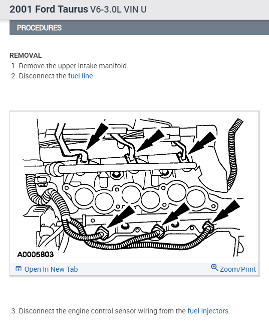

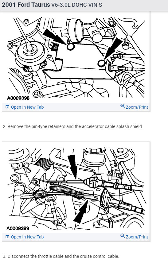

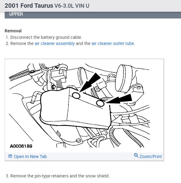

I want to replace cylinder 4 fuel injector on bank 2. Do I need to take off the intake plenum and loosen both fuel rails? Joe F. has helped me with a previous problem.
Jul 20, 2022 at 12:49 PM
SQM
  • 6,383 POSTS

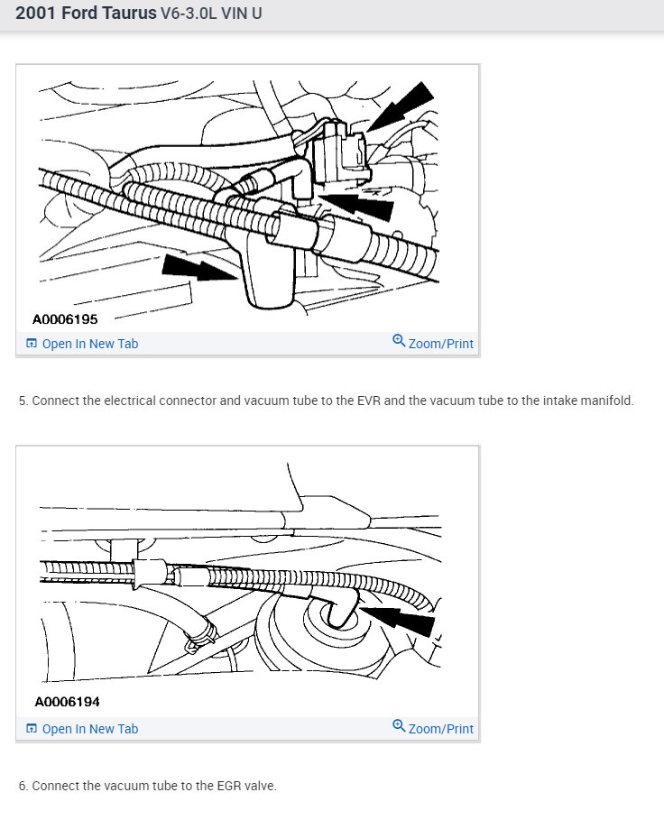

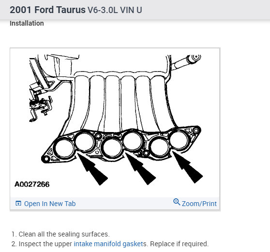

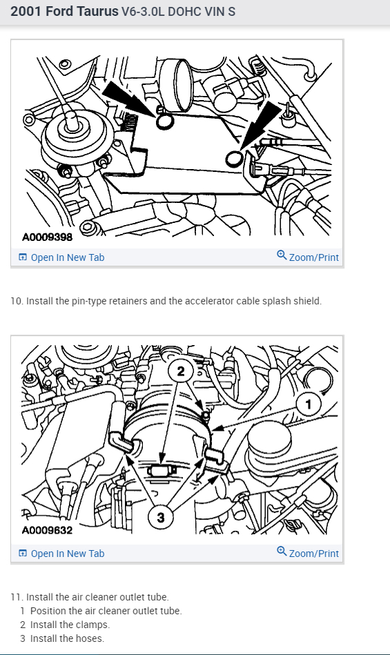

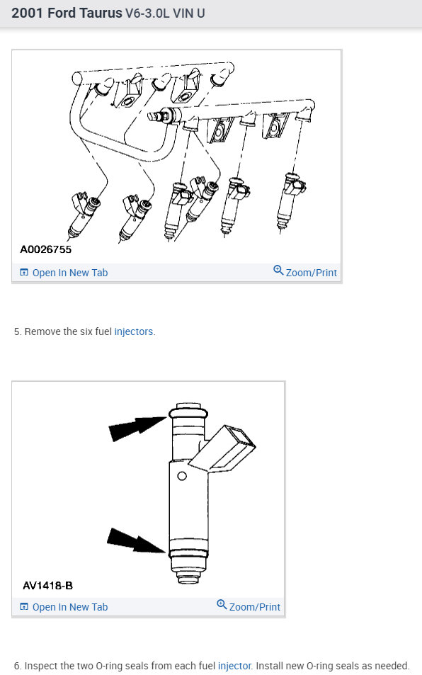

On this vehicle you will have to remove the fuel rail and the injectors all together then replace the desired injector.
I have attached the replacement procedure below.
Let me know of any questions.
https://www.2carpros.com/articles/how-to-replace-a-fuel-injector

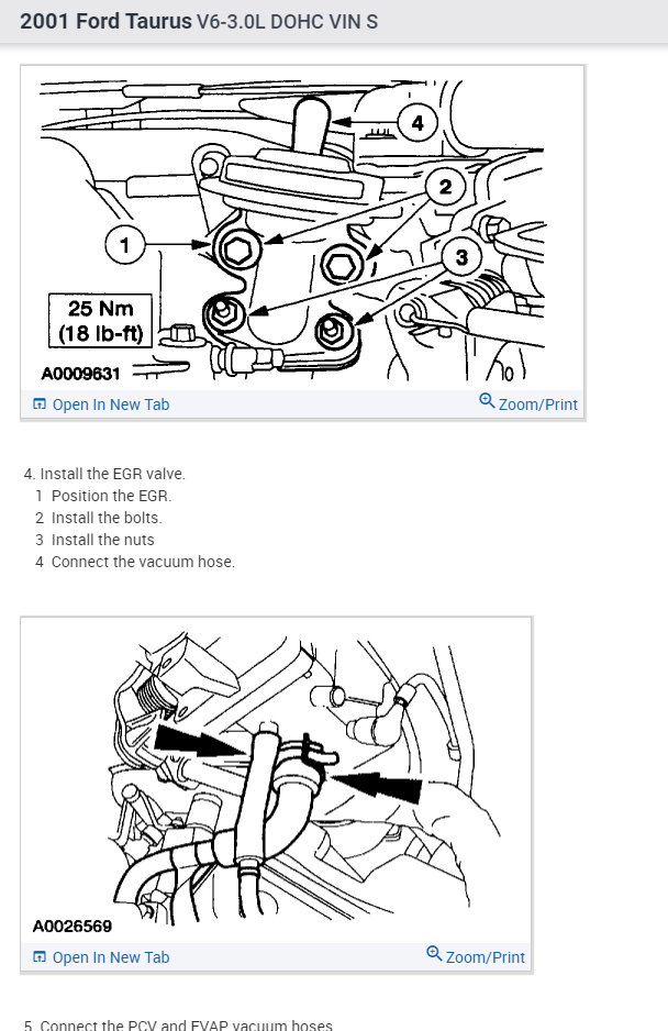

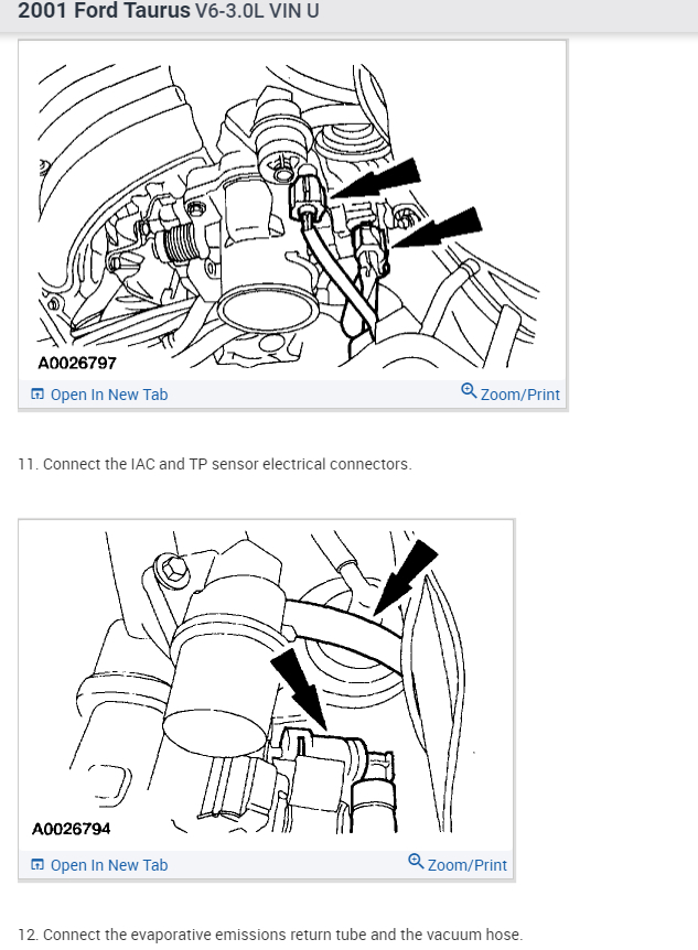

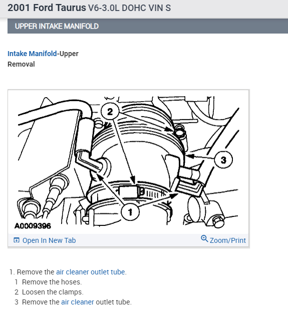

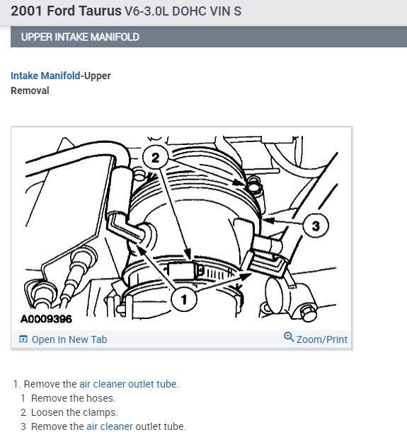

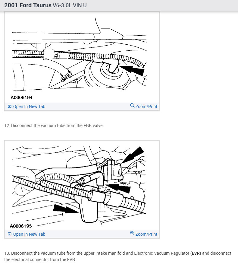

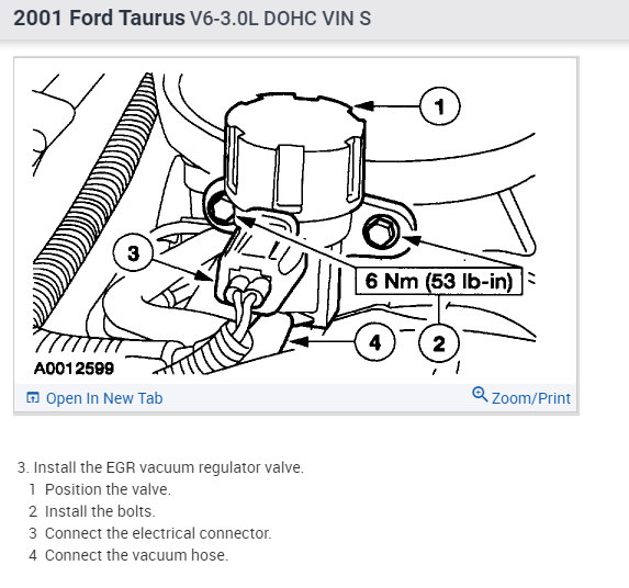

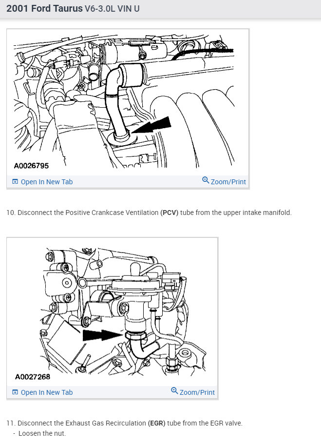

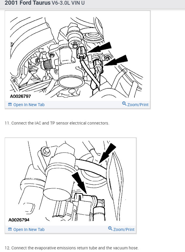

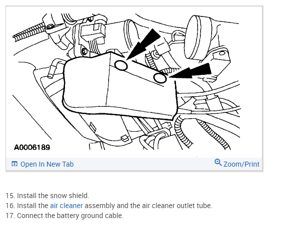

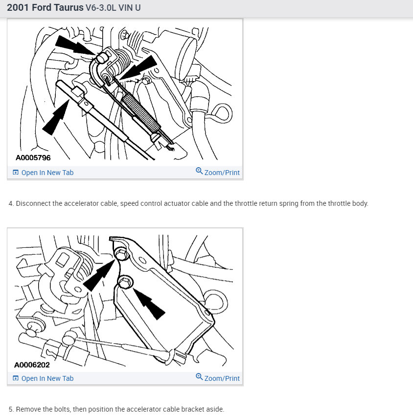

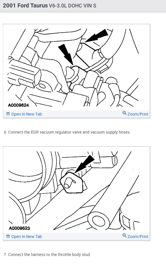

I asked about the intake plenum. You didn't mention it in your reply; so is it 'yes' or 'no'?
Jul 27, 2022 at 4:49 PM
SQM
  • 6,383 POSTS

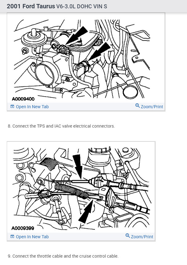

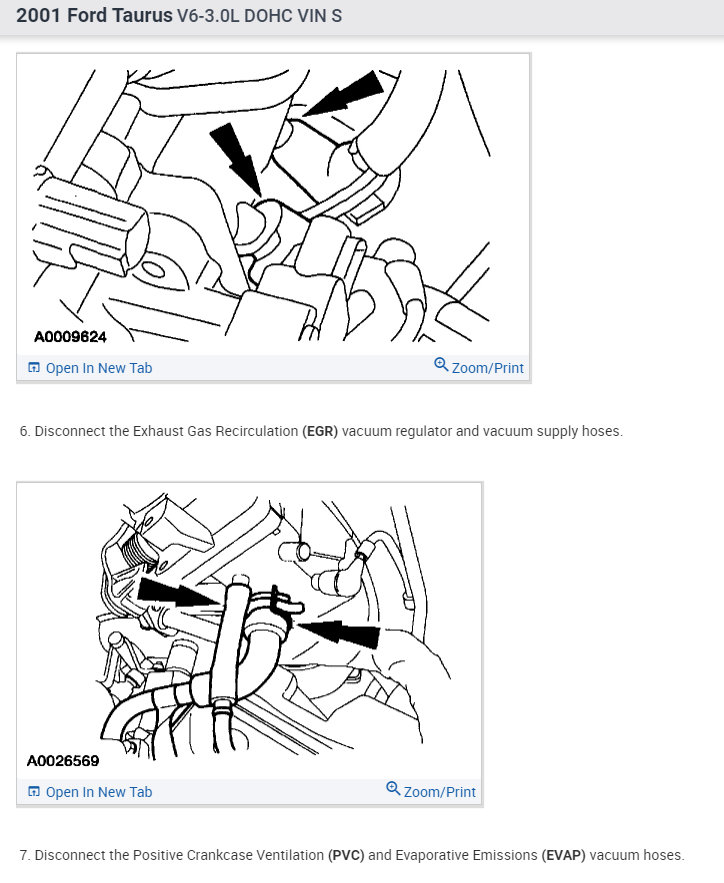

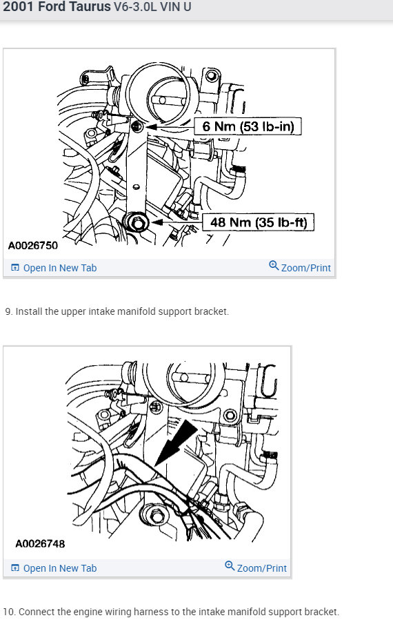

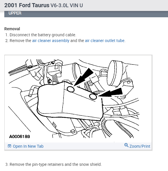

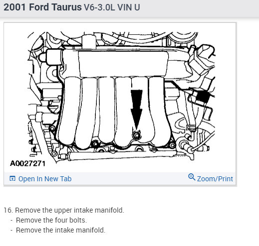

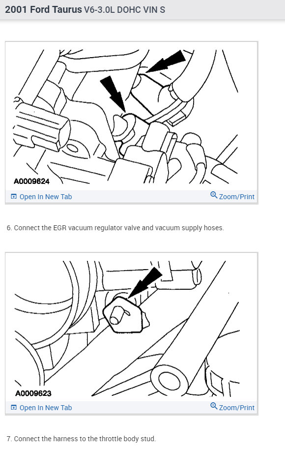

Yes, the plenum will need to be removed first.
See attached for the instructions.
Jul 27, 2022 at 8:24 PM
KUALUMNUS
  • 19 POSTS

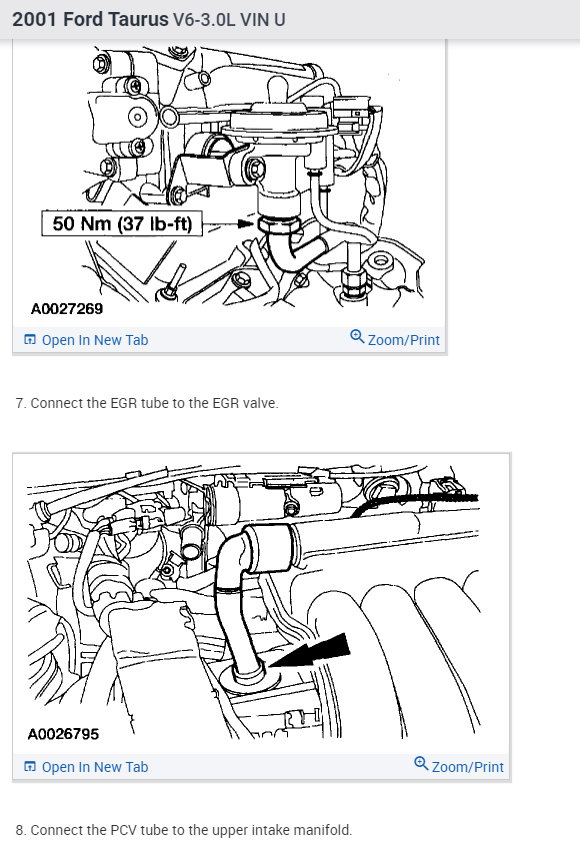

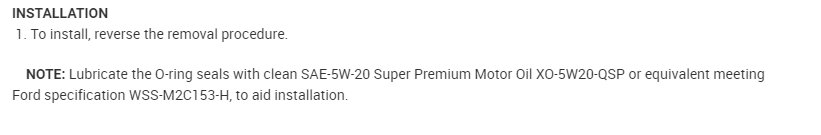

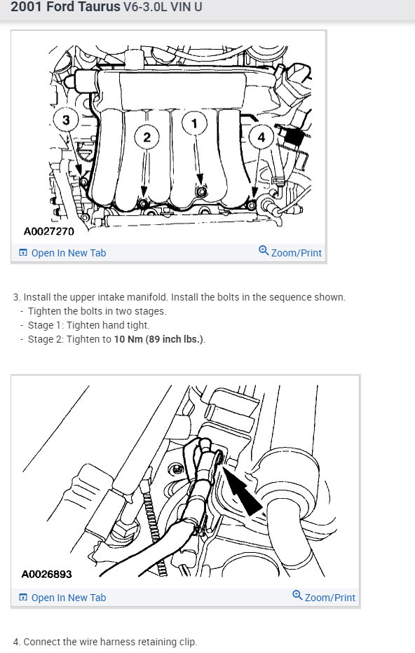

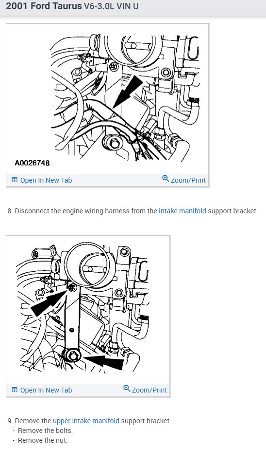

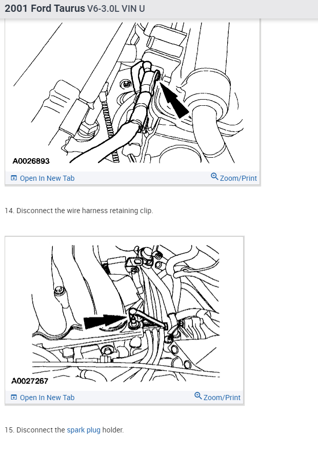

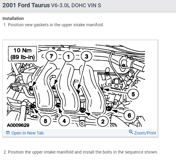

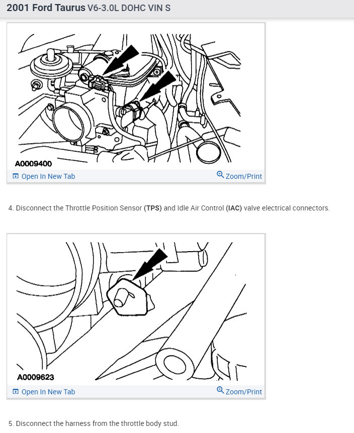

I don't have a DOHC motor. I had my mechanic replace the injector.
Aug 7, 2022 at 7:13 PM
SQM
  • 6,383 POSTS
Thank you for the update.

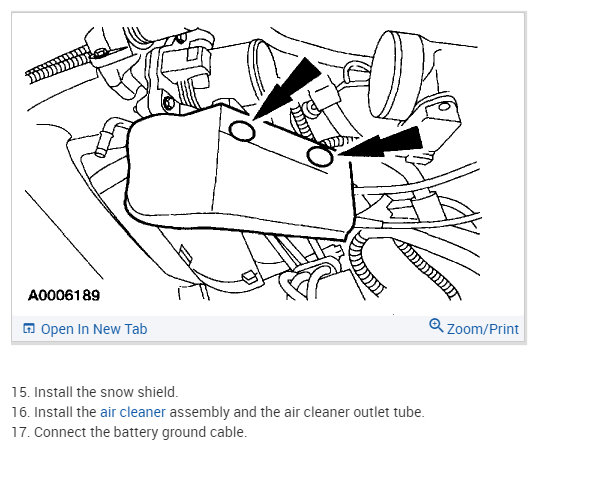

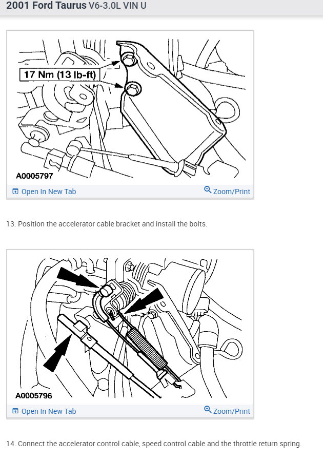

I have attached the upper intake replacement procedure for the OHV engine for anyone might be looking for that information.
Thank you for using 2CarPros.
