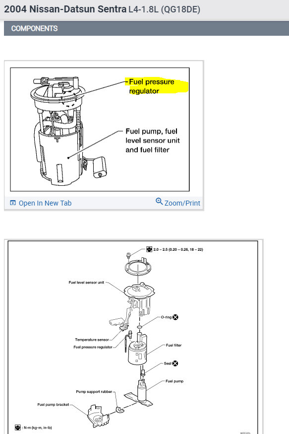

Just trying to find the whereabouts of the fuel injector pressure regulator please.
Jul 3, 2022 at 9:21 AM
SQM
  • 6,383 POSTS
The fuel pressure regulator is part of the fuel pump assembly. This vehicle does not have an inline regulator.

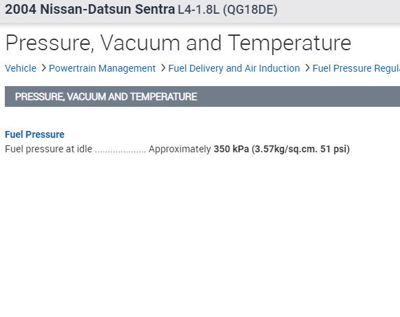

This vehicle should have 51 PSI of fuel pressure at idle.

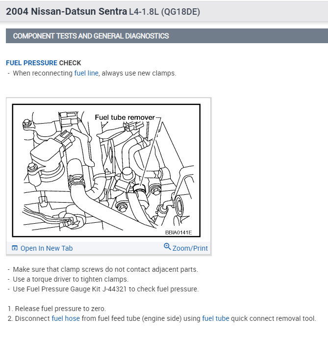

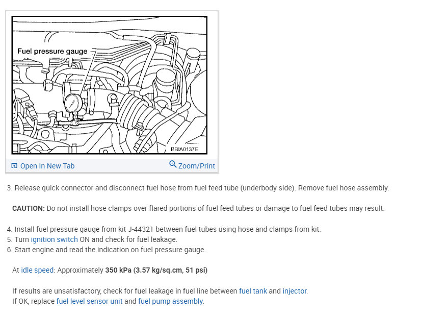

I have attached the fuel pressure test procedure below.
