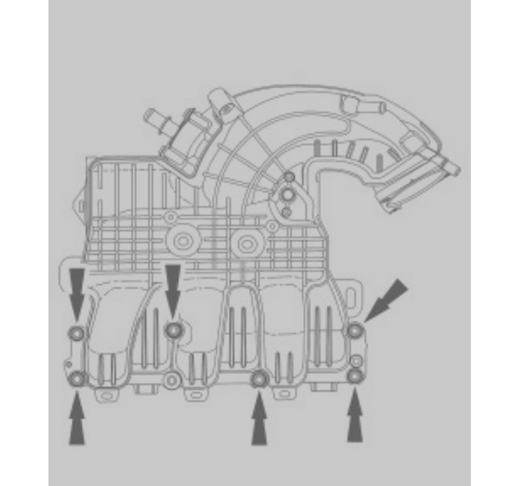

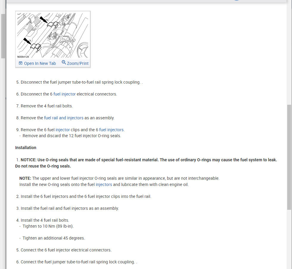

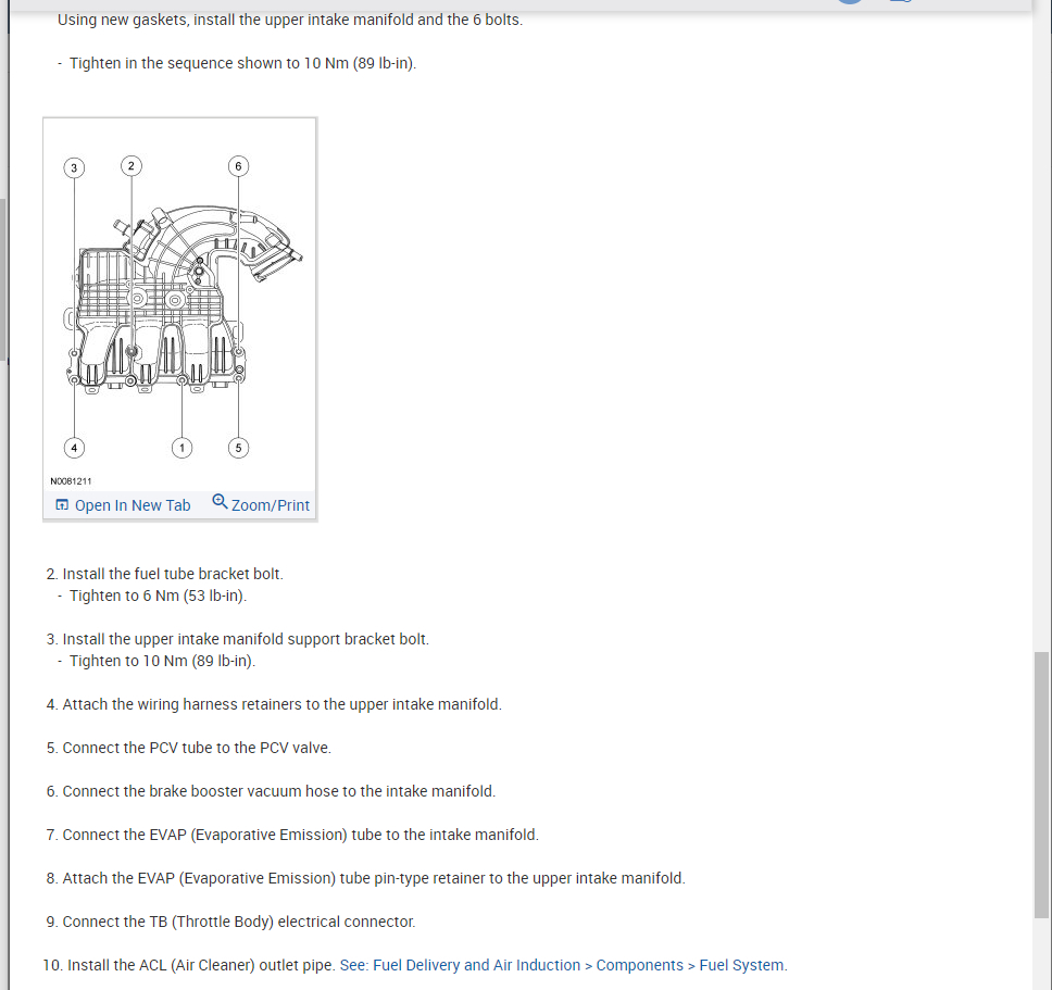

I'm having a cylinder four misfire and trying to replace the fuel injector for that cylinder, but unable to locate where the fuel injectors are.
Jul 1, 2021 at 5:03 AM
SQM
  • 6,383 POSTS

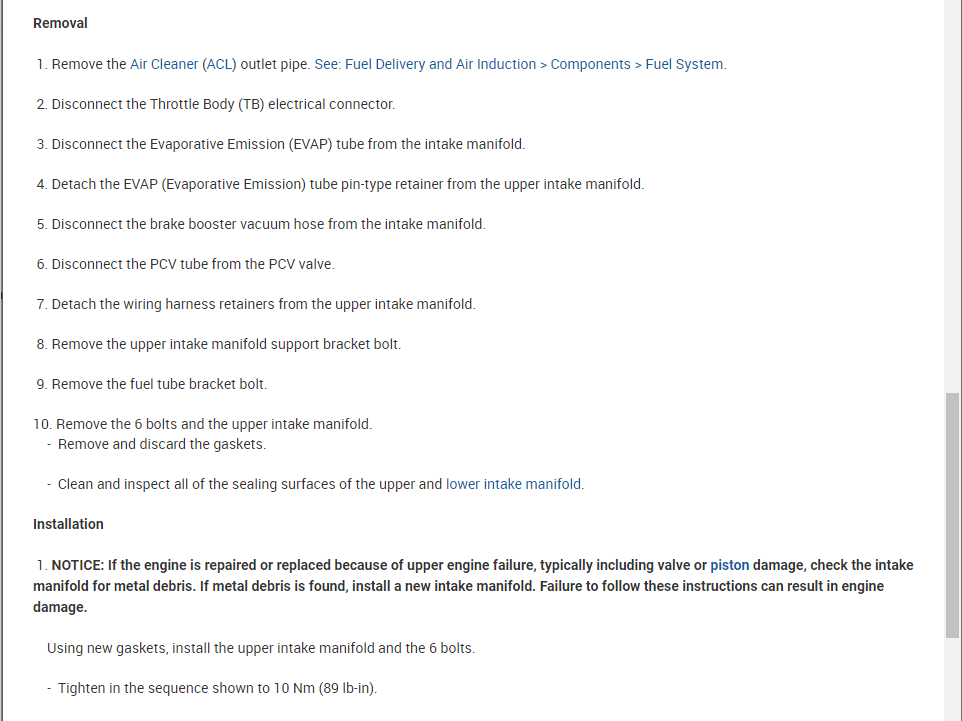

The fuel injectors are located under the intake manifold. To access it you will have to remove the intake manifold.
Jul 1, 2021 at 5:58 AM

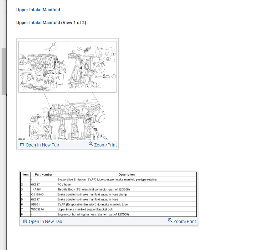

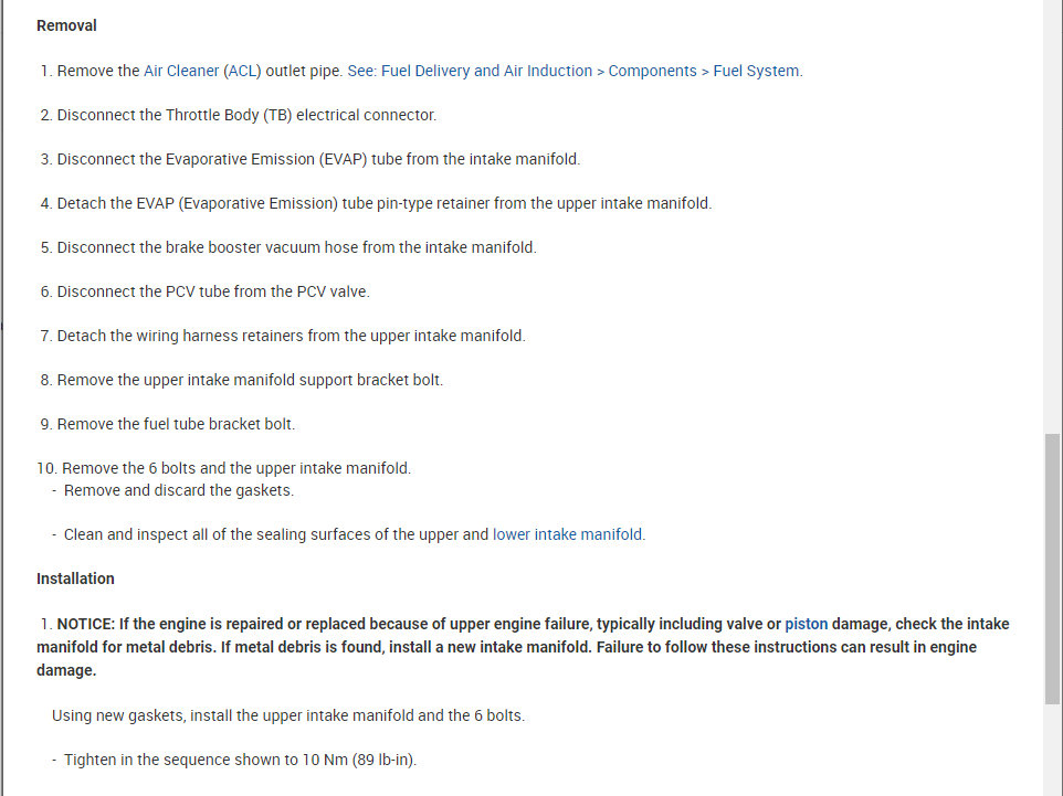

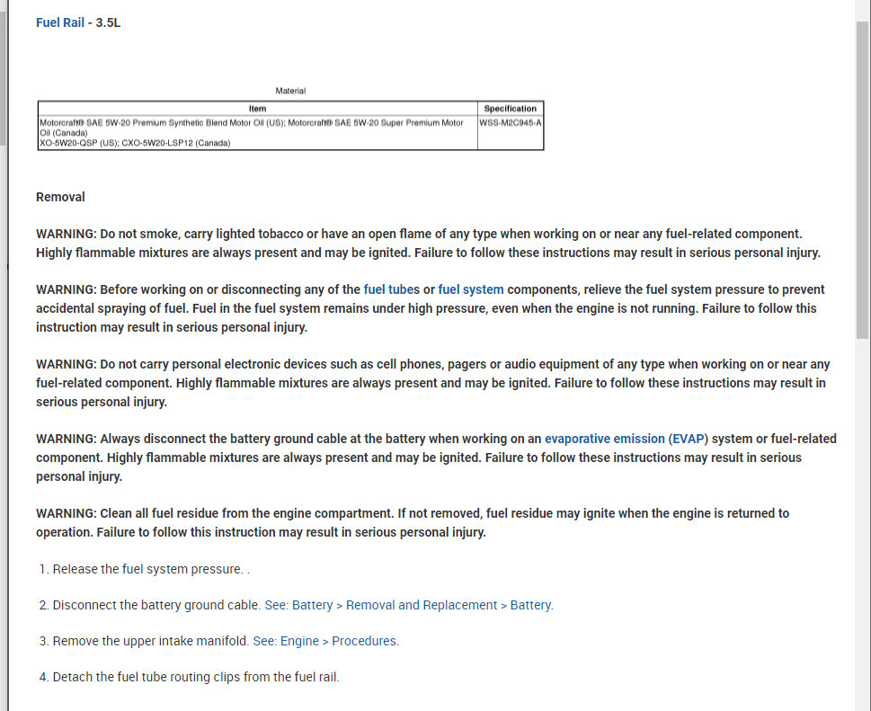

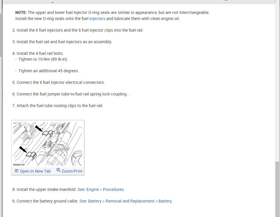

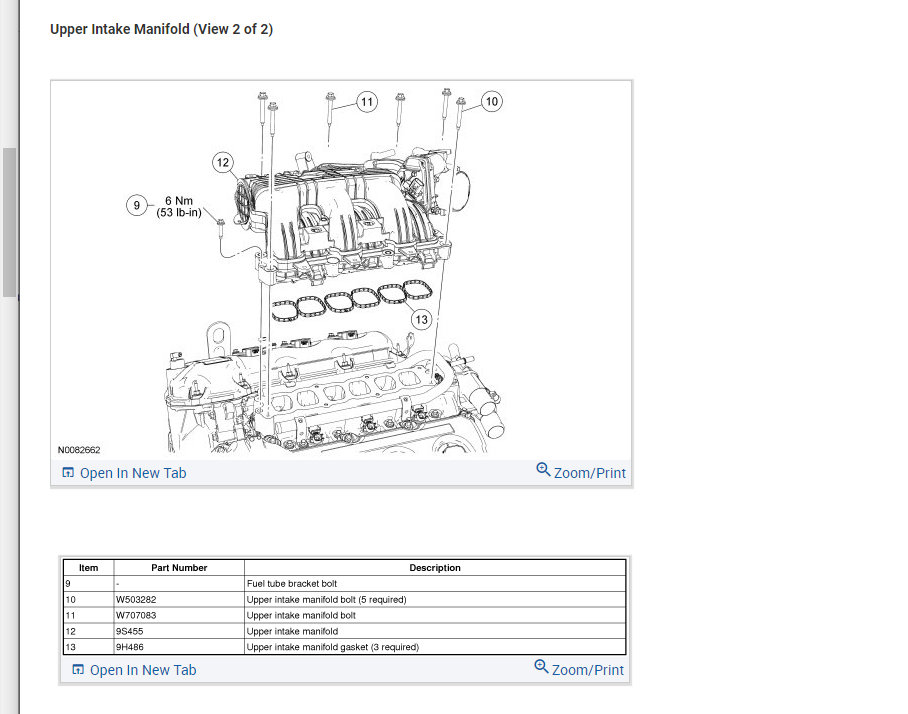

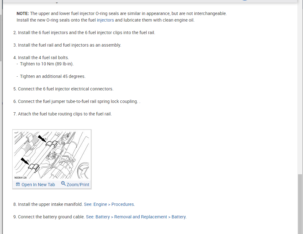

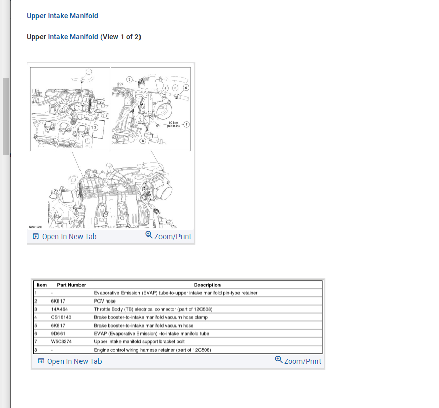

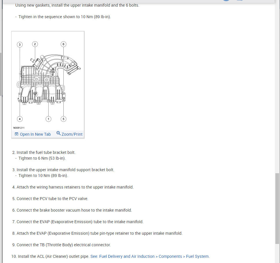

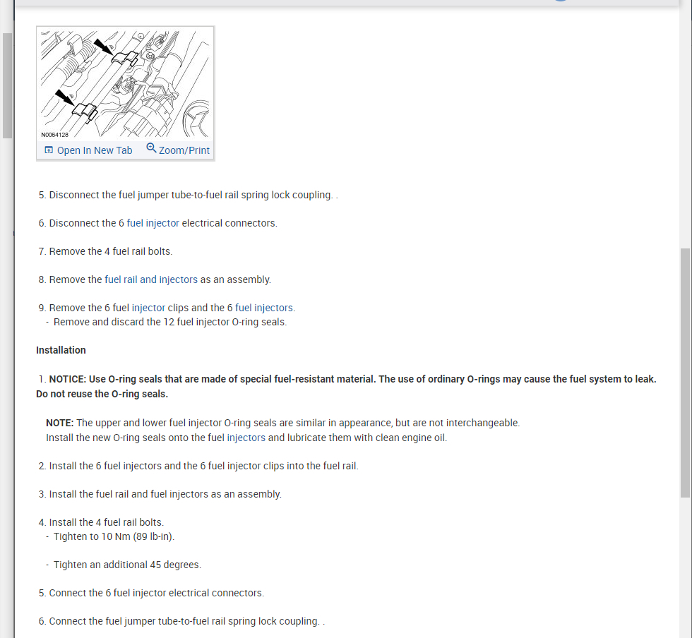

These injectors are under the upper intake manifold. I will attached the complete process for this but here is a guide that will help with replacing injectors:
https://www.2carpros.com/articles/how-to-replace-a-fuel-injector
Below is the process from the manual on how to remove the fuel rail/injectors and upper intake manifold.
Please run through this material and let us know if you have questions. Thanks
