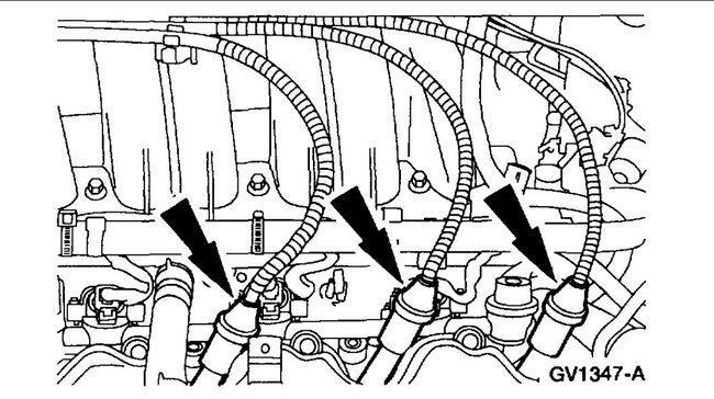

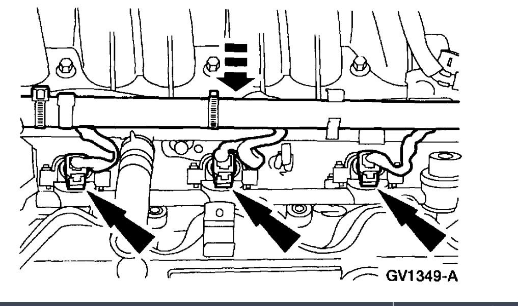

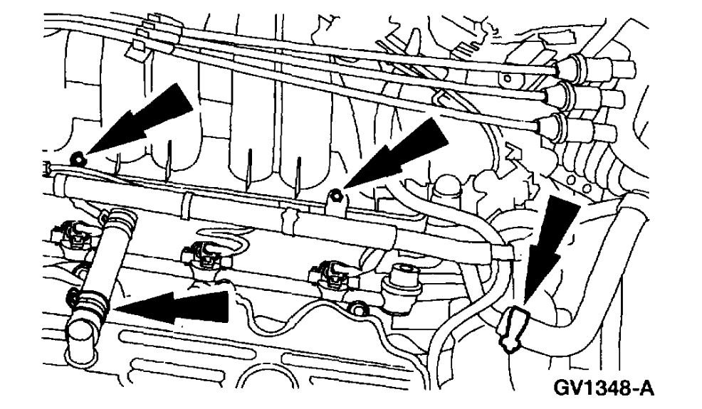

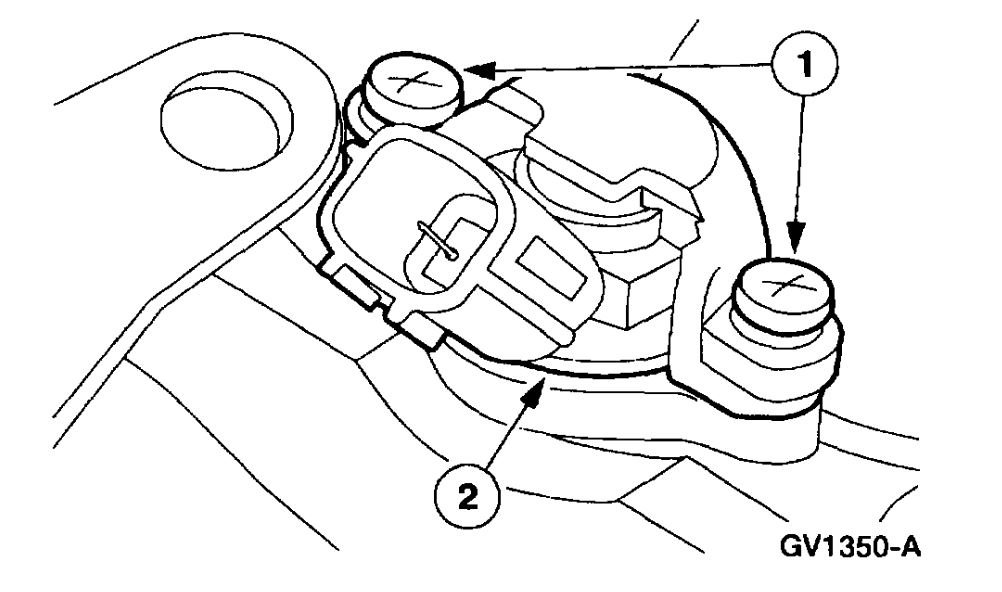

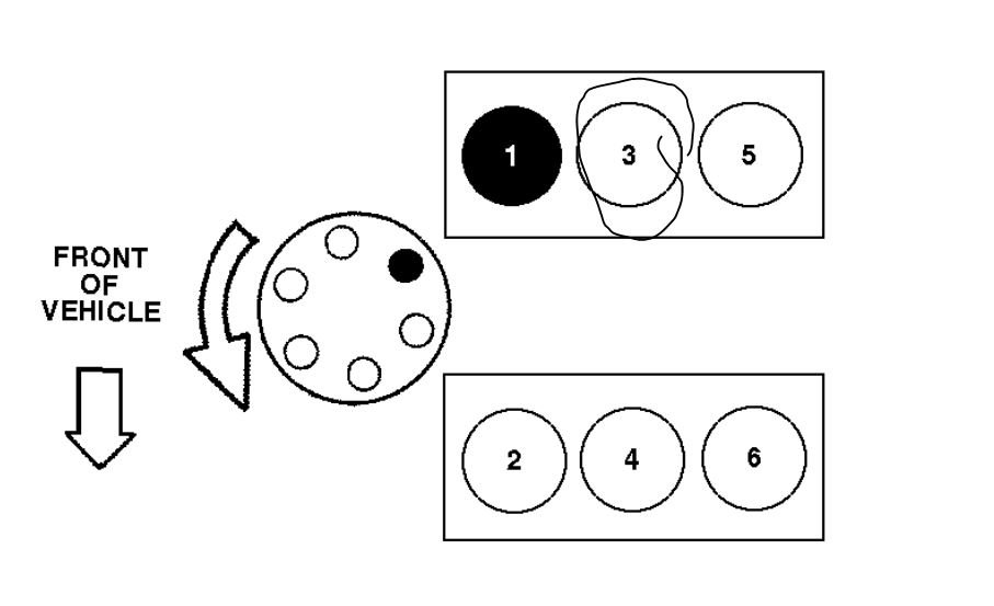

Hi, I have the van listed above which has a cylinders three misfire p0303 code, trying to replace fuel injector. Can you tell where is fuel injector three located. Thanks
Nov 3, 2019 at 6:56 AM
Good evening,
Number three is the center cylinder at the rear or closest to the firewall.
I attached some pictures for you.
Nov 3, 2019 at 9:31 AM
JUSTINJJOHN11
It helped, thanks.
