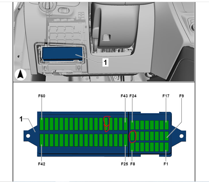

Where is the Fuel injector fuse located?
2017 VOLKSWAGEN JETTA
161,000 MILES • 1.4L • 4 CYL • 2WD • MANUAL
JASON DEZIEL
Fuel injector fuse location on the car listed abovce TSI.
Jan 20, 2023 at 10:38 AM
  • 110,240 POSTS

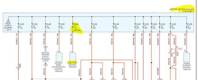

There are two fuses that power the fuel pump module. See pics 1 and 2. Both are in fuse panel C (bottom left of dash).

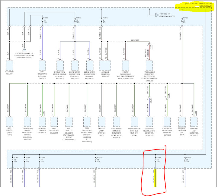

If you look at pic 3, I circled the fuses to help locate them. Note that when you check a fuse, first make sure the fuse is good. If it is, then you should always confirm there is power to and from it.
Let me know if this helps.
