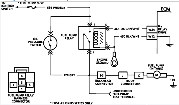

Car has set 10 years. No fuel going to throttle body. Turned key on no fuel moving, have line off at throttle body. Thanks

Yep, after 10 years, the fuel tank will need to be removed and flushed out and the fuel pump and fuel filter replaced. Fuel turns to goo after that much time.

I was asking where the fuse was for fuel pump and fuel injector fuse?

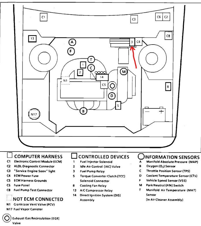

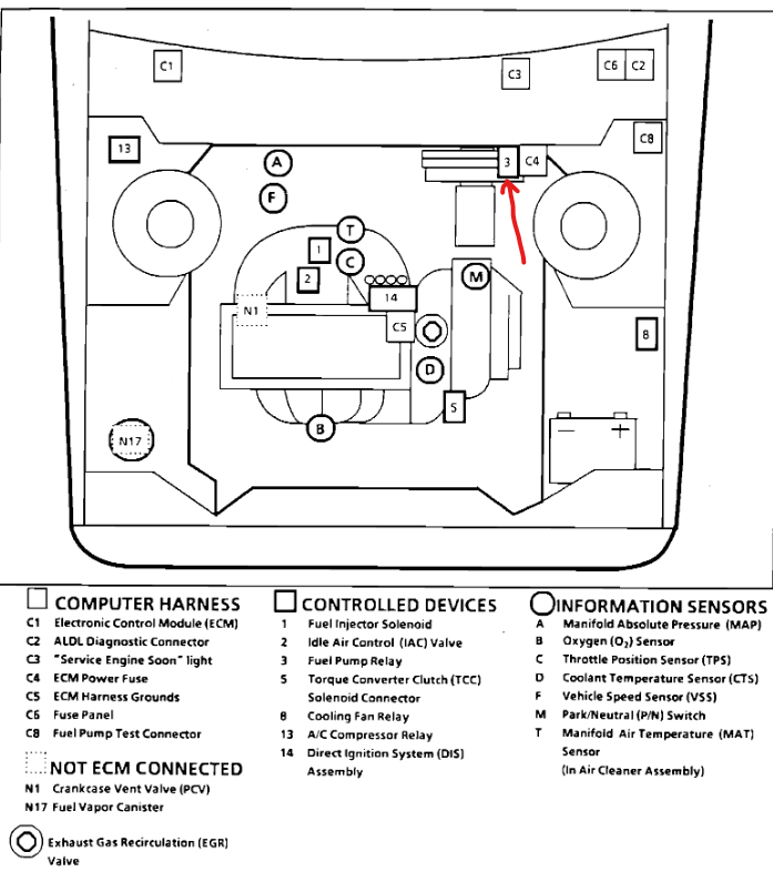

My bad, here is the location of the fuel pump relay and the fuse is a little harder to find by if you have power to the #1 terminal of the relay the fuse is okay. Check out the images (below). Let us know how it goes

I'm assuming this is under the dash? Thank you

Yes, I believe so, this car only has one fuse panel correct? If so then the fuse should be there.
