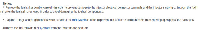

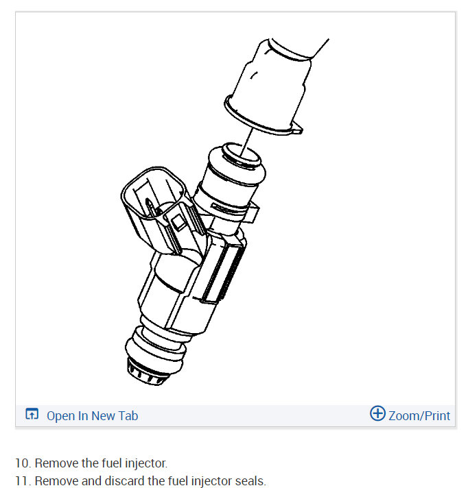

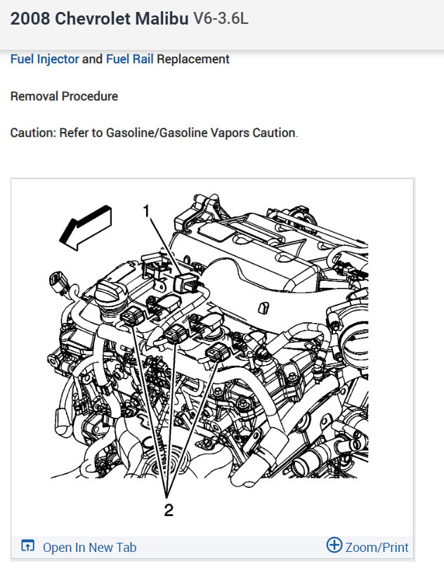

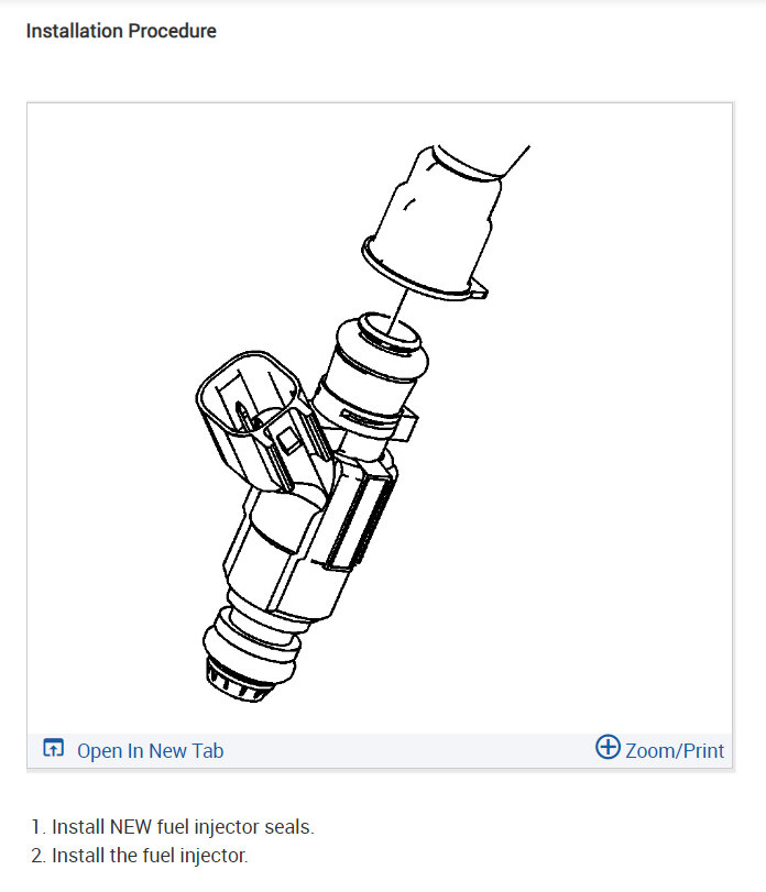

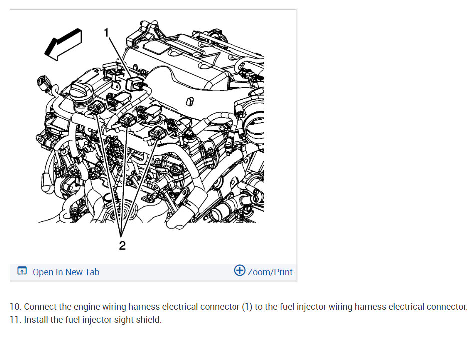

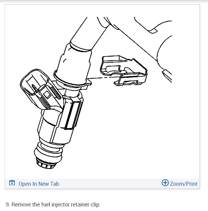

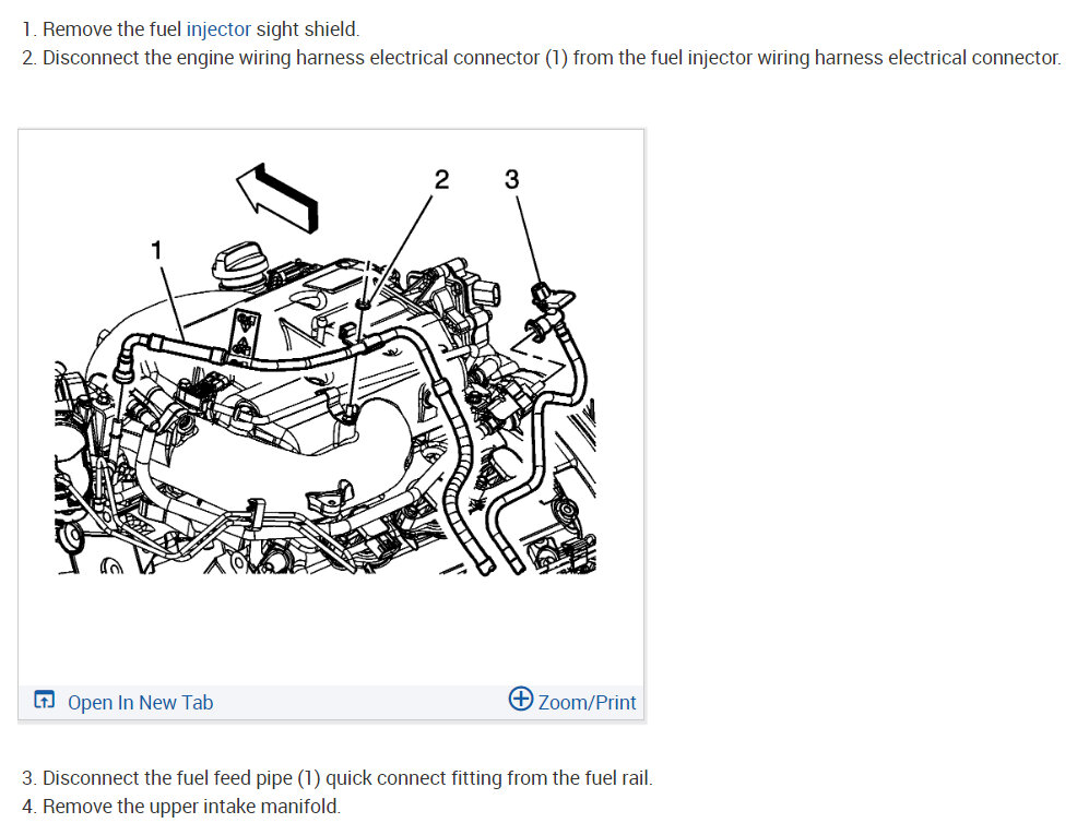

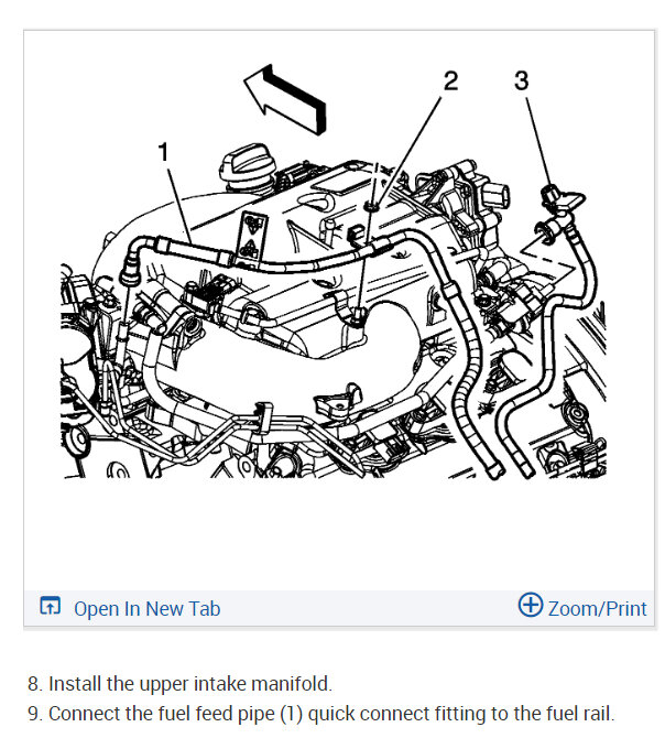

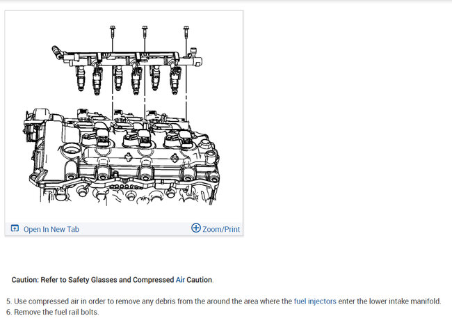

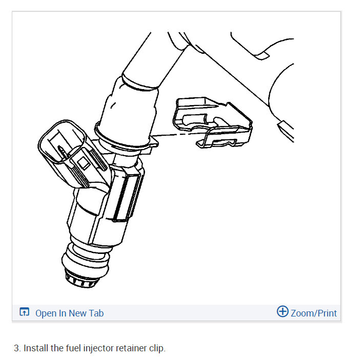

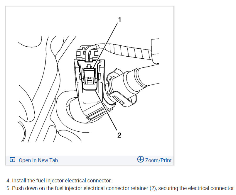

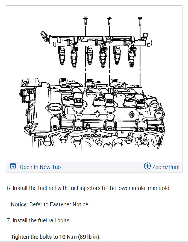

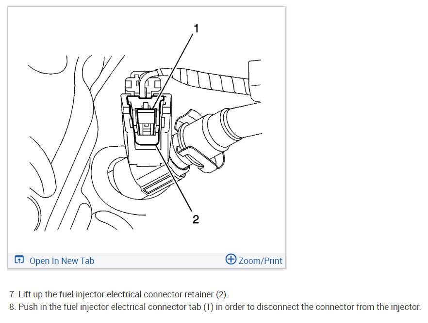

Now unplug the injectors 1, 3, 5 and replace the fuse, then plug the injector one at a time until the fuse blows, this will be the bad injector. Here is how to change the bad fuel injector out. Check out the images (below). Please let us know what happens.
