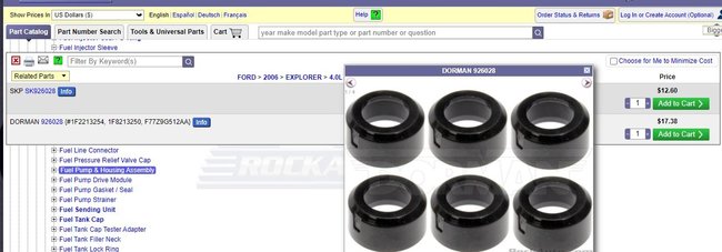

Installed new injector adapter cups as I am installing the fuel injectors, I am having trouble getting two of the injectors back in, so I started inspecting the adapter cups and just as I thought two of them are sitting at an angle. I am not sure how to get them out and try again without damaging them. I do not have a special tool to use, so how can I fix this problem so my injectors will go in?

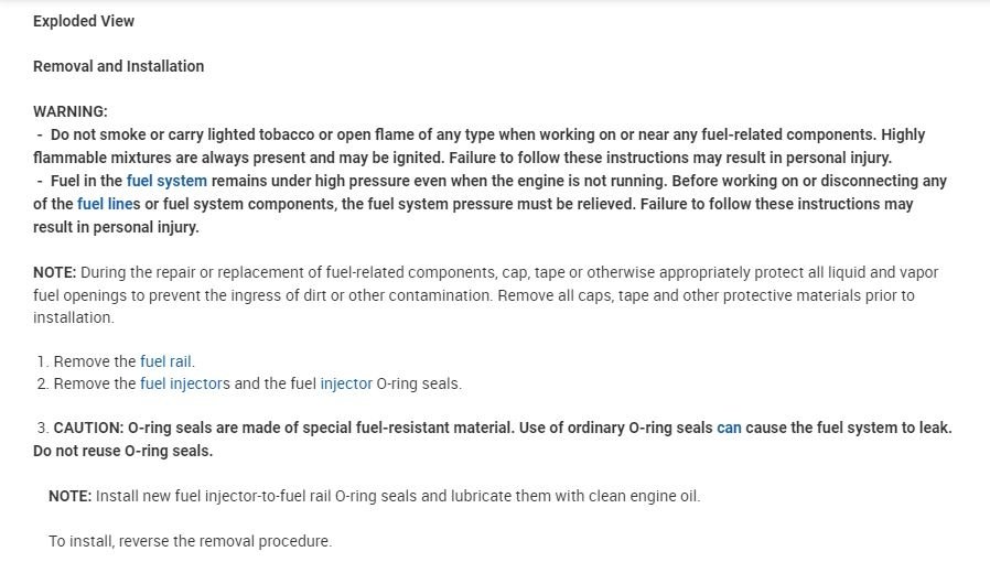

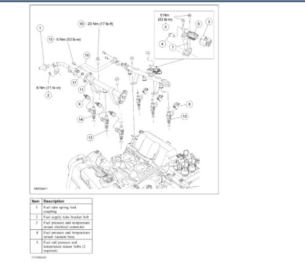

You cannot remove them without destroying them. You will need to get another set on sleeves for this.
https://www.2carpros.com/articles/how-to-replace-a-fuel-injector
Use Vaseline as lube when installing.
