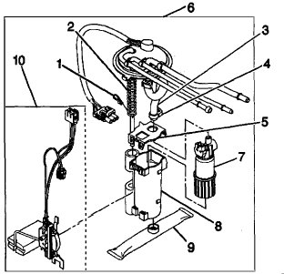

Fuel injection or fuel filter
1990 OLDSMOBILE CUTLASS
38,000 MILES
SOUTHWIND90
If it has a fuel filter where is it located on the car listed above it is the Supreme international model?

This can be one of two models Cutlass, a Ciera or full size Cutlass. The Ciera is located on the frame rail on the driver's side in front of the rear wheel. I have attached a picture of the full size Cutlass location for your review.
Let me know if this helps.
