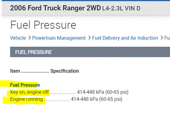

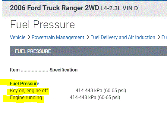

Let me ask you a question. Have you checked the fuel pressure at the engine? That will provide us with knowing if it is a pressure regulation issue. All you need is a fuel pressure gauge. Most parts stores will lend one to you. Here is a link that shows in general how it's done:
The attached pic shows the manufacturer's specifications are for pressure. The port should be on the fuel rail itself.
Since the engine has 200,000 on it, there is a chance that you even have an injector leaking down when you turn the key off. With that many miles, the fuel wouldn't have too much trouble getting past the piston/rings and into the oil. It's just a theory at this point.

Sounds good. When you perform the pressure test, watch fuel pressure drop off when the key is turned off. It should hold pressure for some time before slowly dropping off about 10 psi. If it drops fast, then we will need to check the injectors.
