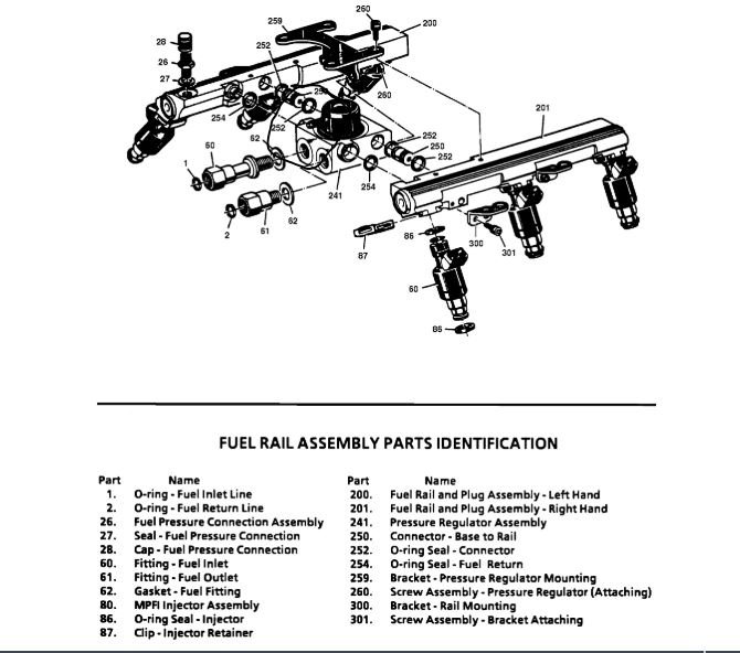

What do I need to replace to fix the fuel from going in the air filter.

Good afternoon,
Does the car run?
How did you discover the fuel in the air filter?
Is it liquid fuel or vapors?

It cranks just fine and liquid gas was in the air filter when I opened the air filter lid.

Check the fuel pressure regulator on the fuel rail. Turn on the key and remove the vacuum line and see if there is fuel there.
Image (Click to make bigger)
