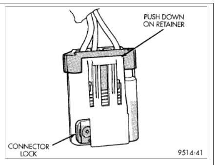

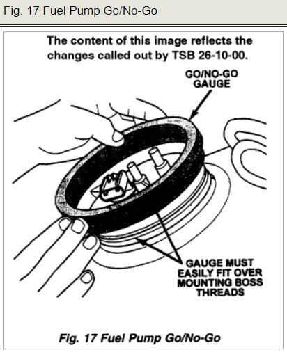

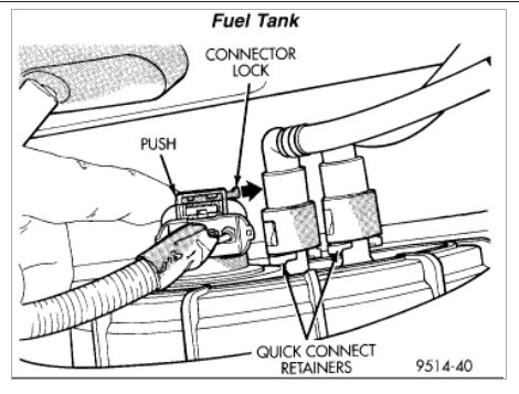

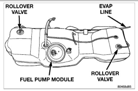

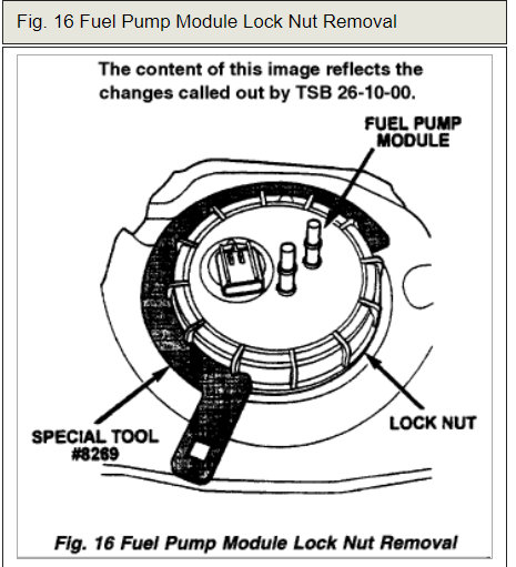

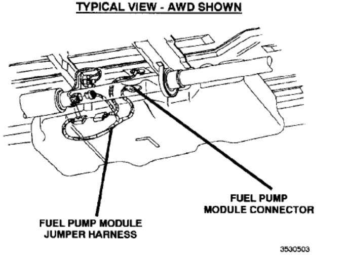

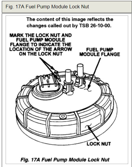

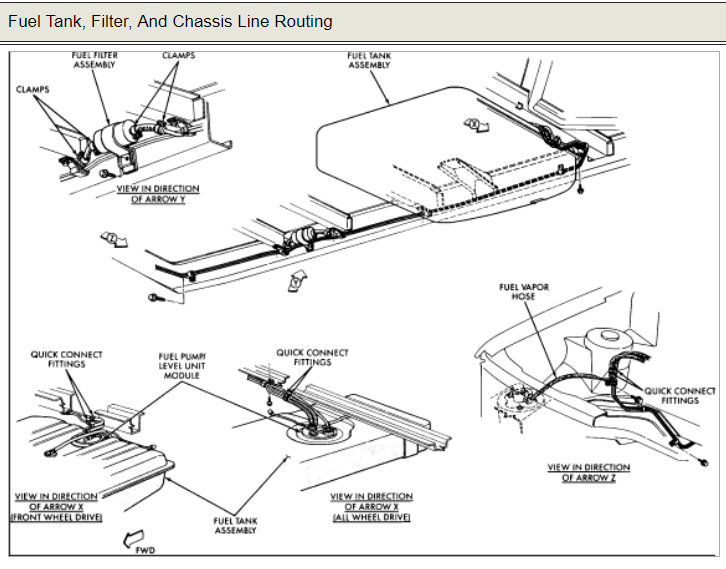

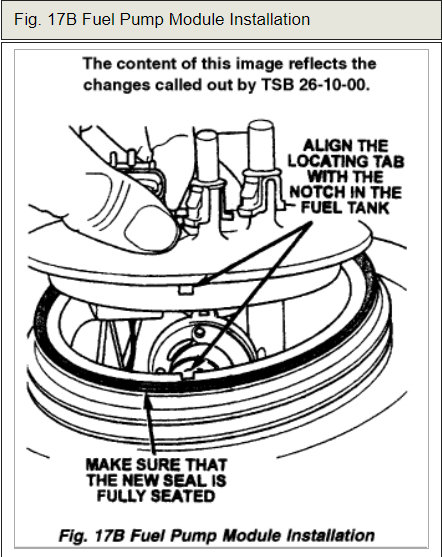

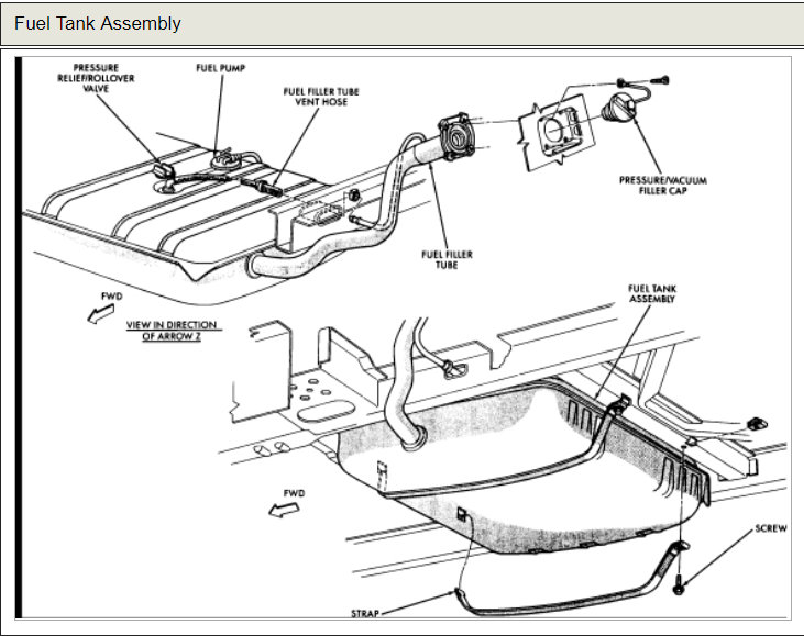

Fuel guage is all over the place. Almost goes with bumps in the road. Mostly sits on "E" with the idiot light on. Doesn't drive strange, at least with this problem and as far as i can tell. I have no problem with determining mileage but it does get kinda annoying especially when it is having a rough day and the dinger goes off every 5 seconds. This is fairly rare though.
Sep 12, 2020 at 5:44 PM
  • 55,423 POSTS
This is common when the fuel level sensor goes out. I have included instruction in the diagrams below to help you fix it. You will need a new fuel pump module. Check out the diagrams (below). Please let us know what happens.
