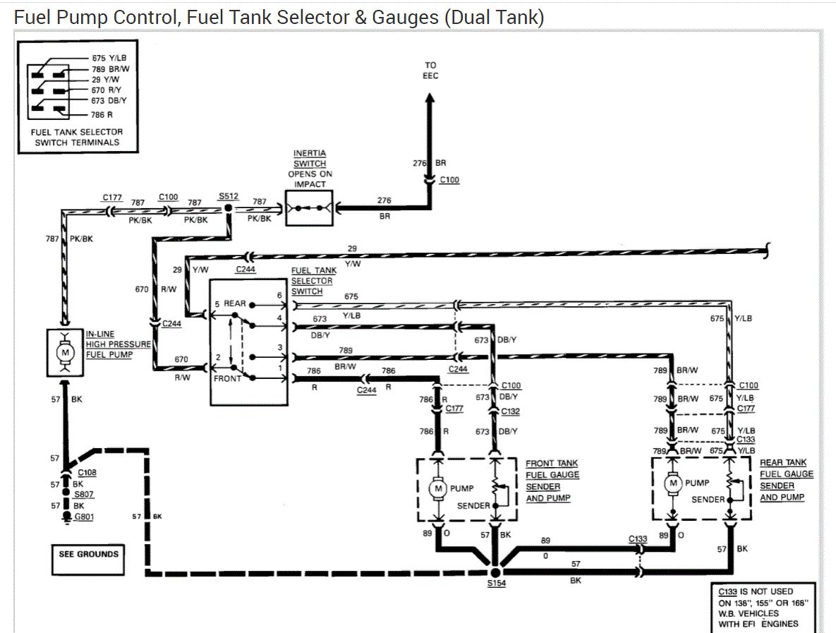

fuel guage is on full. dual tank selector switch not working. when i connect a test light to guage wire it and the selector switch works. when i take test light off it stops working. the guage wire reads 7 volts. Is it supposed to have power?
Sep 18, 2021 at 8:48 AM
  • 110,248 POSTS
I need to get a better understanding of which wires are causing it to work.
Take a look at the attached pic. It is the wiring schematic for this vehicle. Can you identify which you are referring to?
