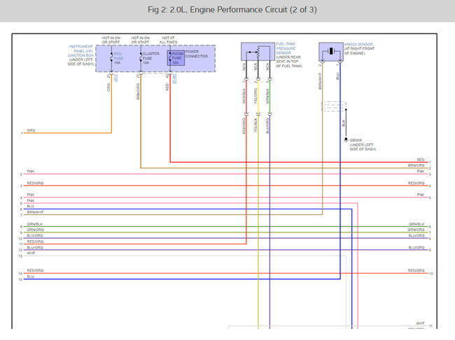

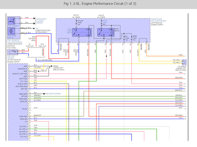

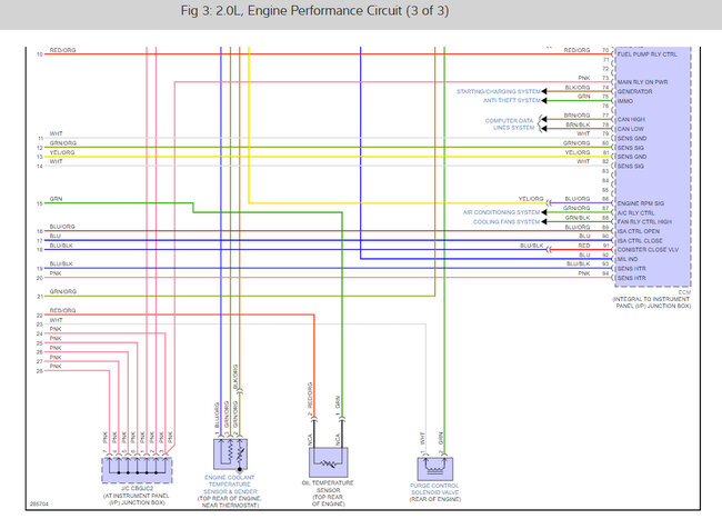

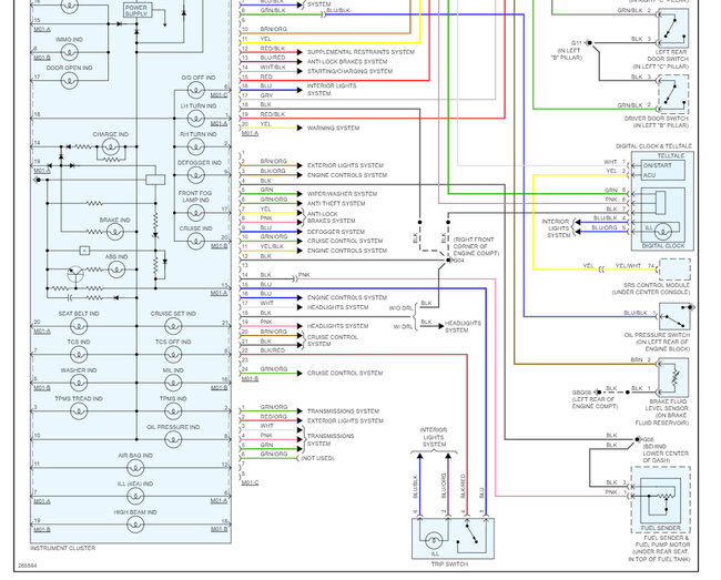

I need a wiring diagram to chase non-working fuel gauge?
156,000 MILES • 4 CYL • 2WD • AUTOMATIC
CHULOW
Install new pump that comes complete with gauge float
and still does not work. Any testing tips and wiring diagrams would help.
Feb 20, 2023 at 11:22 PM
  • 55,748 POSTS

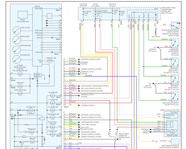

Sure, got them right here, but it sounds like the instrument cluster is not working because of your last question about the speedometer. Anyway, here are the wiring diagrams needed. One wire goes the cluster, and the others go through the PCM. There is a chance that the PCM is bad causing both issues. Please let me know and check the images below for the diagrams.
