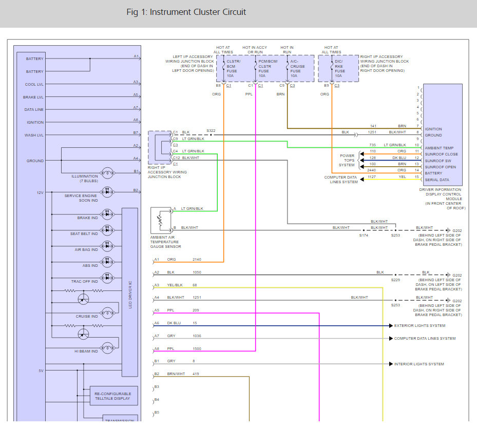

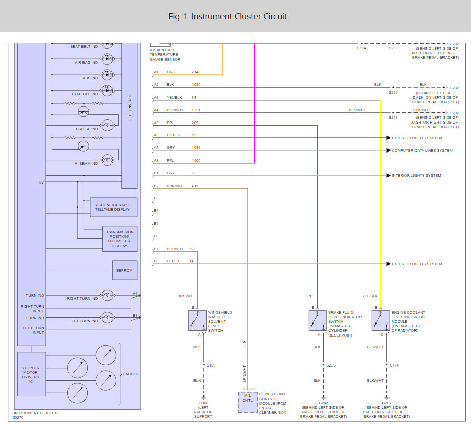

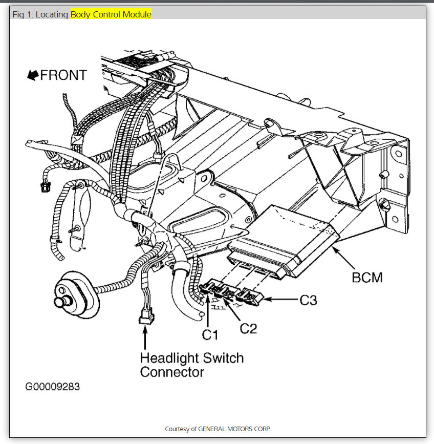

Fuel gauge, temperature gauge and speedometer not working in dash. New cluster was put in and still nothing. Took out backhand cleaned connections. Still not working? BCM?
Jul 30, 2017 at 7:25 AM
  • 55,770 POSTS
I would do a power and ground test to the cluster to start. Here is a guide and some wiring diagrams to help get you started:

If everything checks out here is the location of the BCM
Please run some tests and get back to us we are interested to see what it is.
