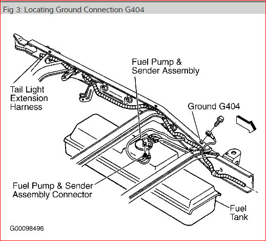

Fuel gauge not working properly
1999 GMC YUKON
204,000 MILES
MARC VAN ALSTINE
Jumping gauge.
Dec 6, 2018 at 5:53 AM
DANNY L
  • 5,648 POSTS
Hello, I am Danny.
That is a fairly common problem on the 1988-1998 Trucks/Tahoe/Suburbans. The first thing to look for is to check the fuel pump wiring harness and clean up the ground wire. I have attached a tutorial for you as well as a picture. Hope this helps and thanks for using 2CarPros.
