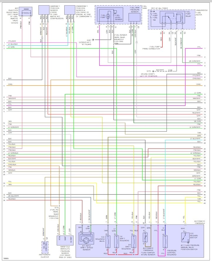

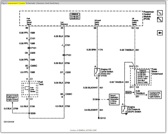

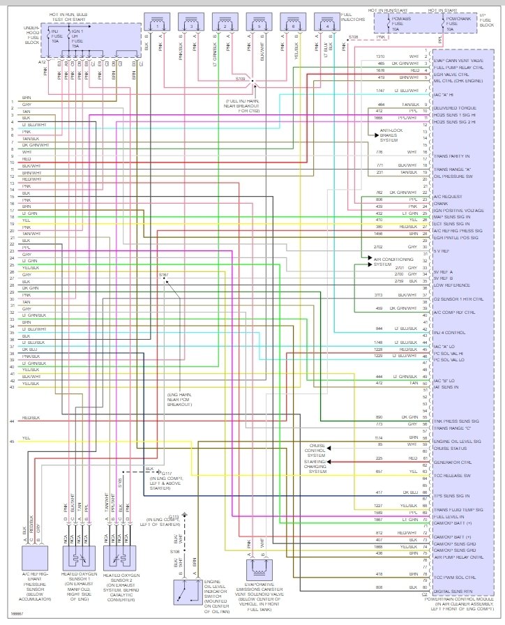

  • 55,781 POSTS
I followed the wiring for you and the sender feedback signal goes straight into the main PCM computer. So if the pump sender doesn't help the computer itself may be bad, here are the wiring diagrams.
