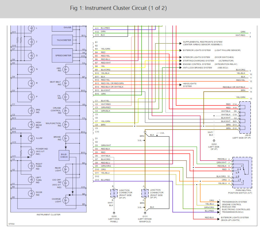

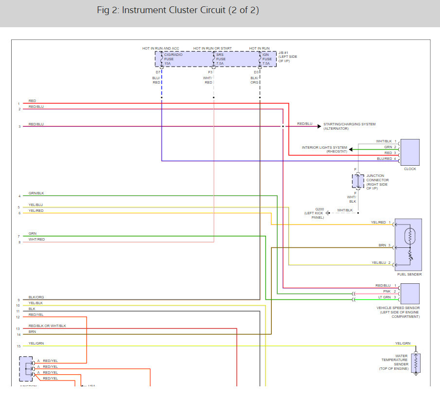

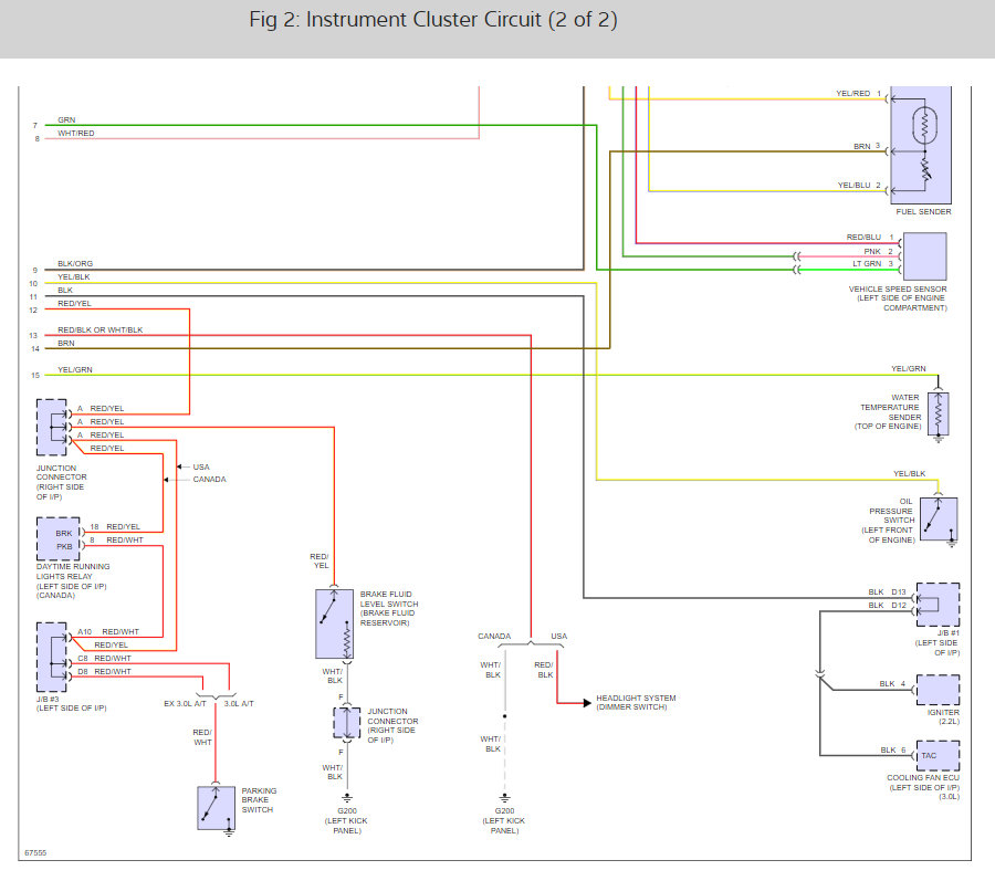

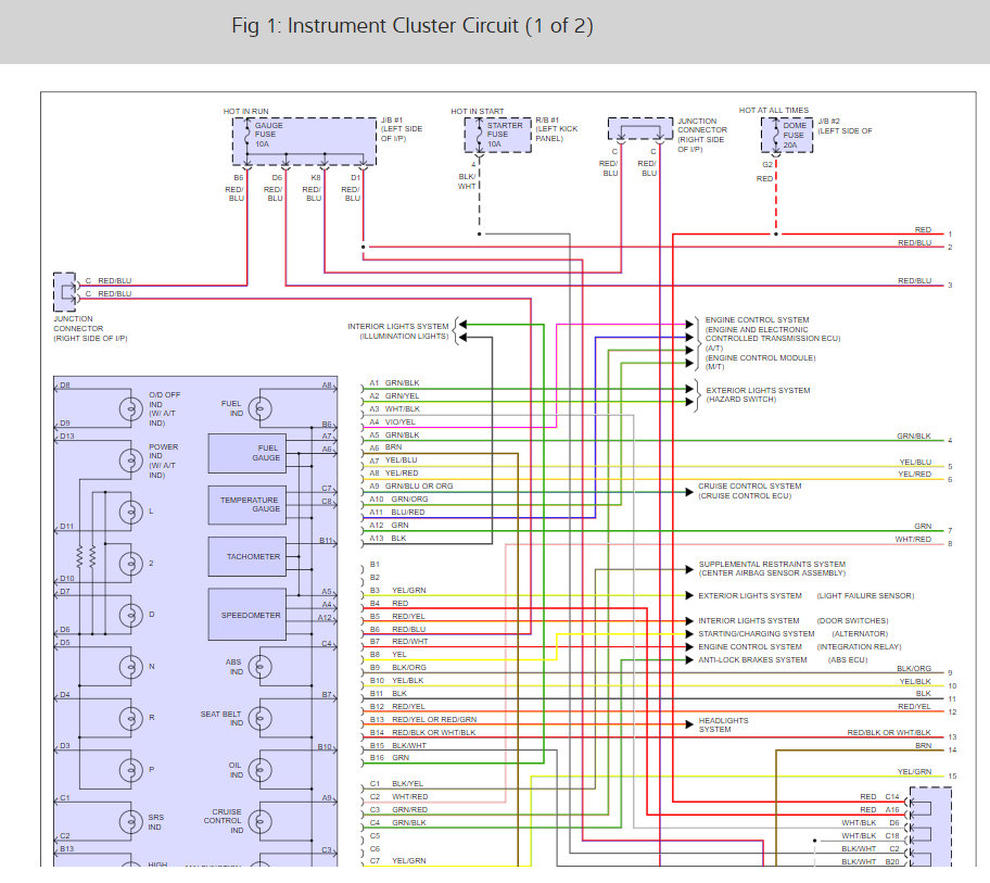

Hi, I have a question please. The fuel gauge is stuck on full, the fuel sensor has been replace gauge still shows full. Can you please tell me if there is a fuse or relay that may fix the problem? Also, where on the car would I find them? Please, thank you.
Jul 26, 2018 at 12:18 PM
  • 55,691 POSTS
It sounds like you have an open circuit between the sender and the fuel gauge. Here is a guide and the wiring diagrams so you can test and confirm the issue:
