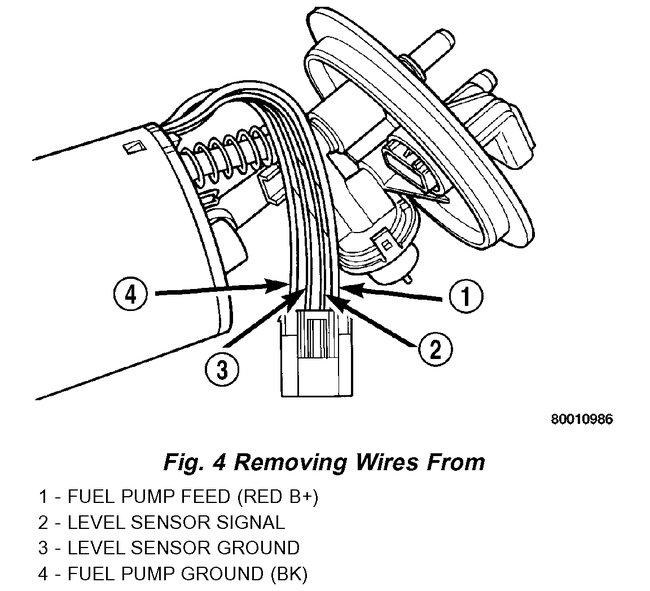

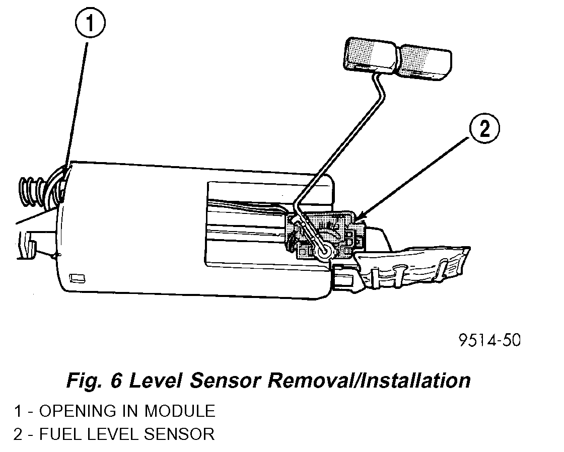

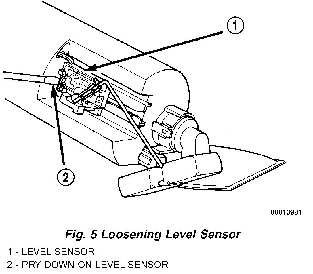

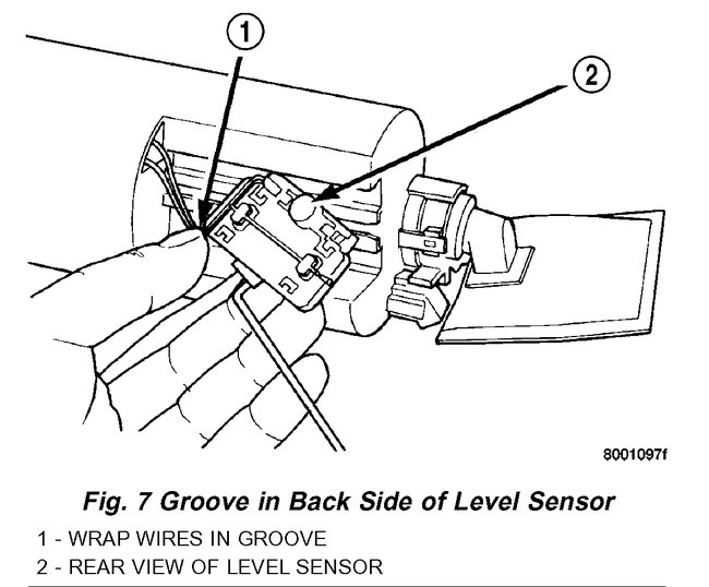

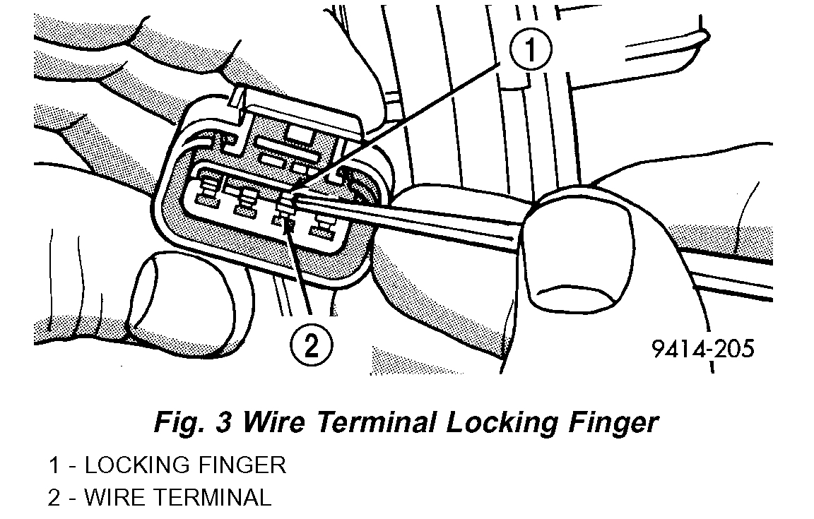

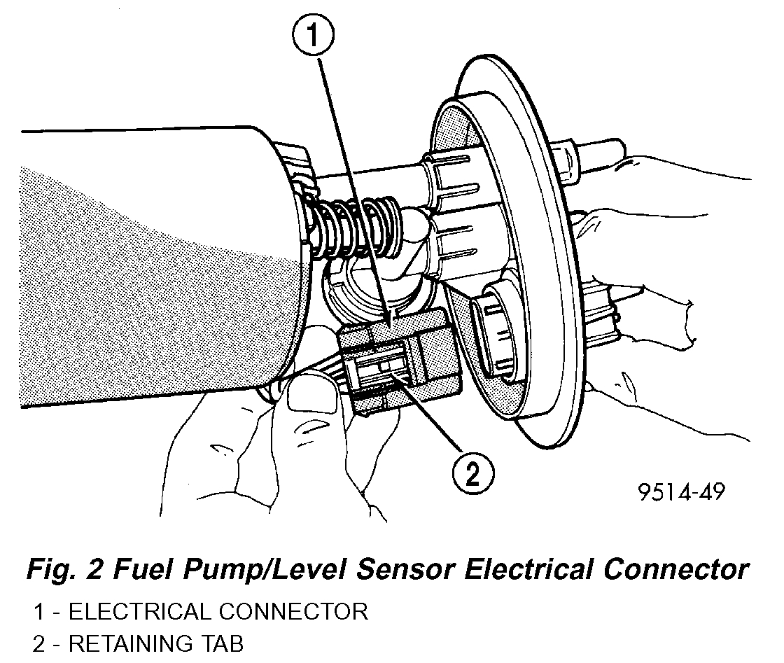

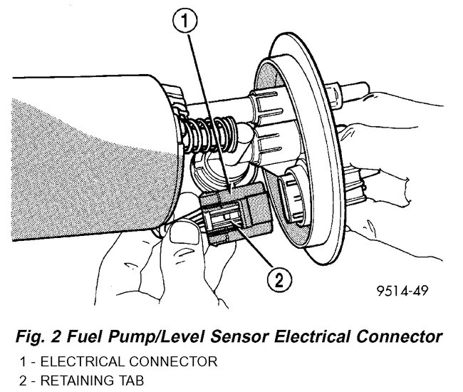

I had to change the fuel pump and fuel filter on my van. Because it just stop running out of the blue. now I got it back running but I think my fuel gauge level is not working right. As just start moving yesterday from being a fuel tank to 3/4 of a tank but I lost a lot of gas when I change it out and as had only 3/4 of the tank when the van stop running. How to I figure out if the fuel gauge level is working right?

If you fill the tank, does the gauge change? Also, did you replace only the pump or the entire unit including the level sensor?

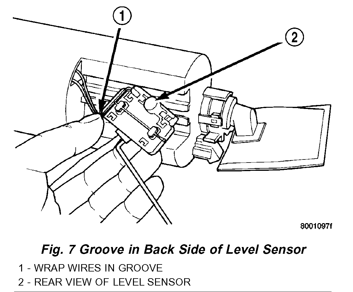

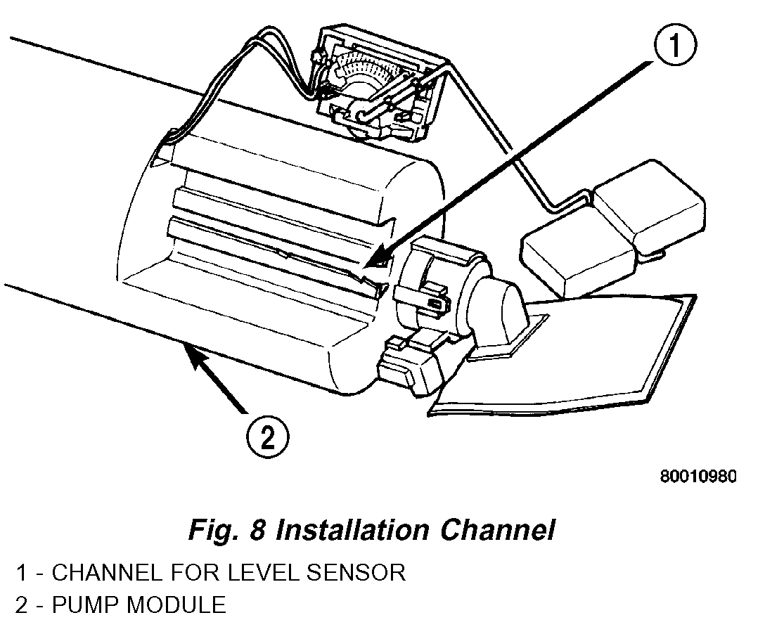

I'm not sure if it was the entire module or only the pump. Here are the directions for the fuel gauge sender if only the pump itself was replaced. Look through the directions and see if there is anything you missed. If the entire module was replaced, then you need to fill the tank and see if the gauge is accurate. The float in the tank is attached to a rheostat which is what sends the signal. It is possible that the float arm was bent, is stuck, or the rheostat itself is bad.
The attached pictures correlate with the directions.

Fig. 2 Fuel Pump/Level Sensor Electrical Connector
pic 1
1. Depress retaining tab and remove the fuel pump/level sensor connector from the BOTTOM of the fuel pump module electrical connector (Fig. 2)
NOTE: The pump module harness on TOP of flange is not serviceable or removable.
2. Pull off the locking wedge.
Fig. 3 Wire Terminal Locking Finger
pic 2
3. Using a small screwdriver lift locking finger away from terminal and push terminal out of connector (Fig. 3).
Fig. 4 Removing Wires From
pic 3
4. Push level sensor signal and ground terminals out of the connector (Fig. 4).

5. Insert a screwdriver between the fuel pump module and the top of the level sensor housing (Fig. 5). Push level sensor down slightly.
Fig. 6 Level Sensor Removal/Installation
pic 5
6. Slide level sensor wires through opening fuel pump module (Fig. 6).
7. Slide level sensor out of installation channel in module.

Fig. 7 Groove In Back Side Of Level Sensor
pic 6
2. Wrap wires into groove in back of level sensor (Fig. 7).
Fig. 8 Installation Channel
pic 7
3. While feeding wires into guide grooves, slide level sensor up into channel until it snaps into place (Fig. 8) . Ensure tab at bottom of sensor locks in place.
