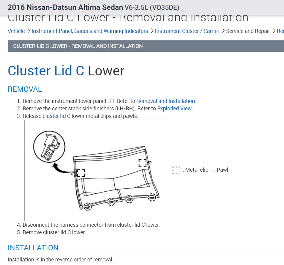

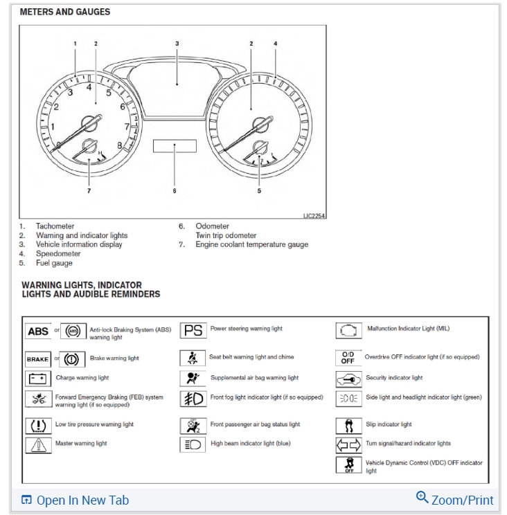

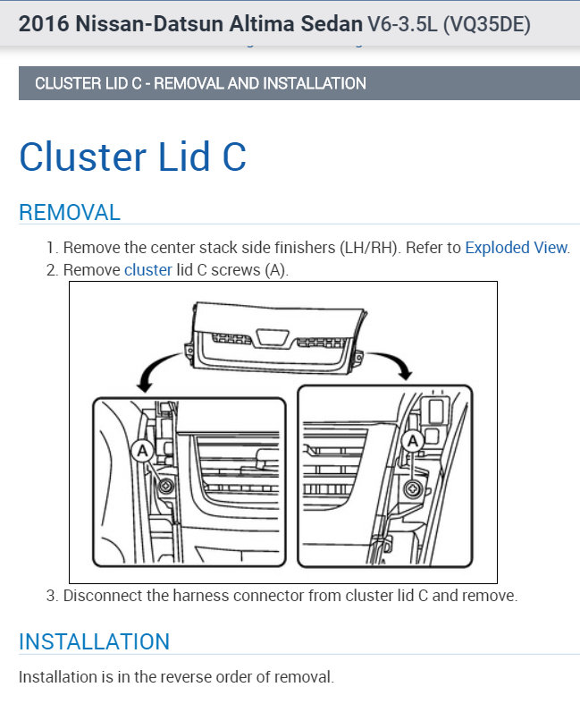

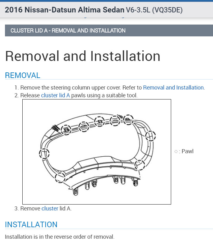

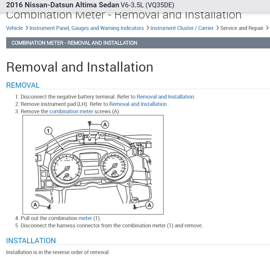

The fact that the miles to empty is correct shows us the float is reading properly. This mean the cluster is probably bad which is common. Here is a video of a cluster replacement on a similar car with diagrams below to show you how on your car:
https://youtu.be/_HEC44xENxw
You will need to note the cars mileage and the VIN so the re-builder can reprogram the new unit for you. Check out the diagrams (below). Please let us know what happens.
