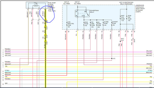

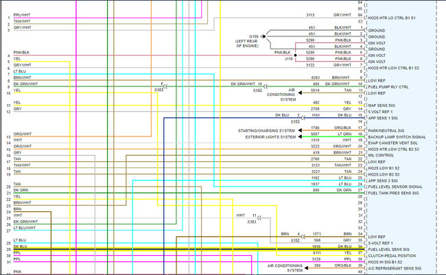

When you first turn the key to on in the morning, the dash does a self test and sweeps the gauges to test them. Can you see if the fuel gauges goes to full and empty and then settles to the correct level?
Most of the time, it is the sender unit but must be verified. How you can tell is to remove the connector for the fuel module. The gauge should go full in one direction. Then take a jumper wire and ground the wire to the sender and it should go full the other direction. If it passes that test, it is the sender unit itself.
I attached the wiring diagram of the sender unit for you. The color of the wire is marked for you in the diagram to be left open and grounded as I suggested.

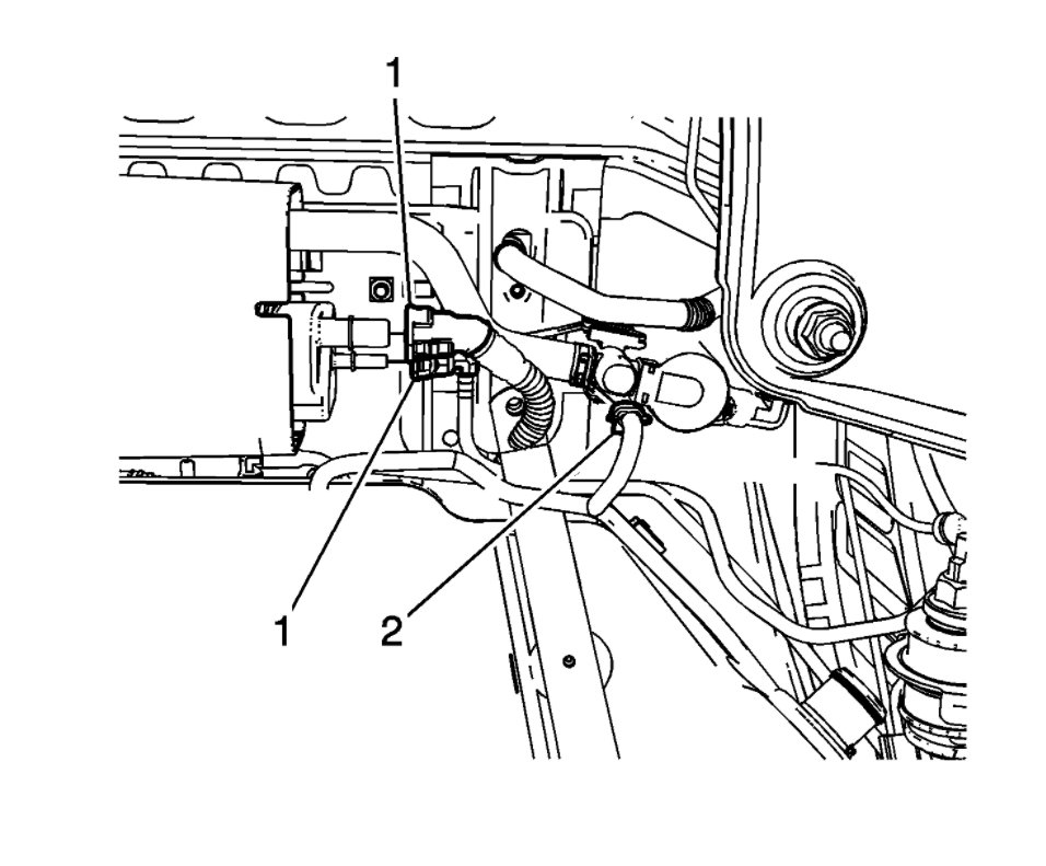

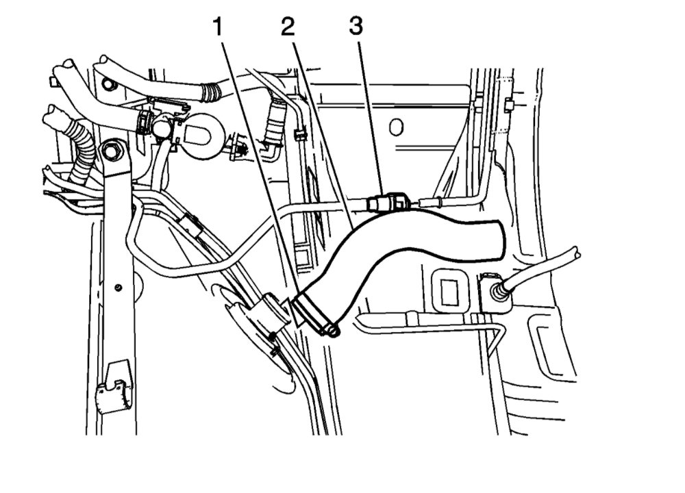

8. Disconnect the evaporative emission lines (1). Refer to Plastic Collar Quick Connect Fitting Service (See: Fuel Line Coupler > Removal and Replacement > Plastic Collar Quick Connect Fitting Service).
9. Disconnect the vent solenoid electrical connector (2).
10. Loosen the hose clamp (1) and remove the filler tube (2).

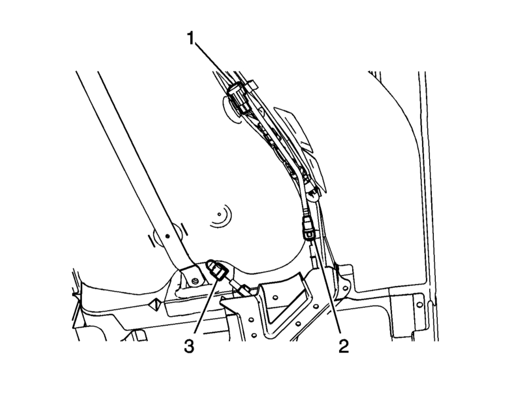

11. Disconnect the evaporative emission line (3). Refer to Plastic Collar Quick Connect Fitting Service (See: Fuel Line Coupler > Removal and Replacement > Plastic Collar Quick Connect Fitting Service).

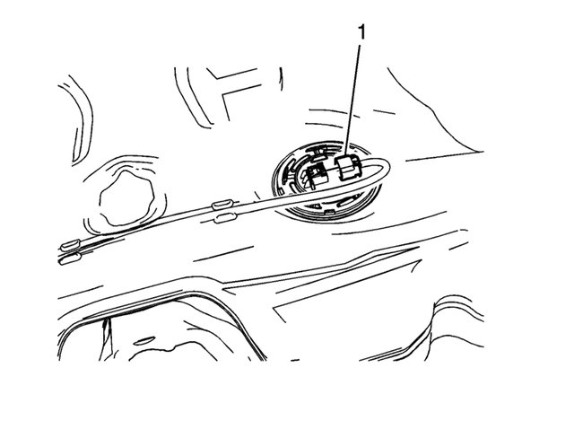

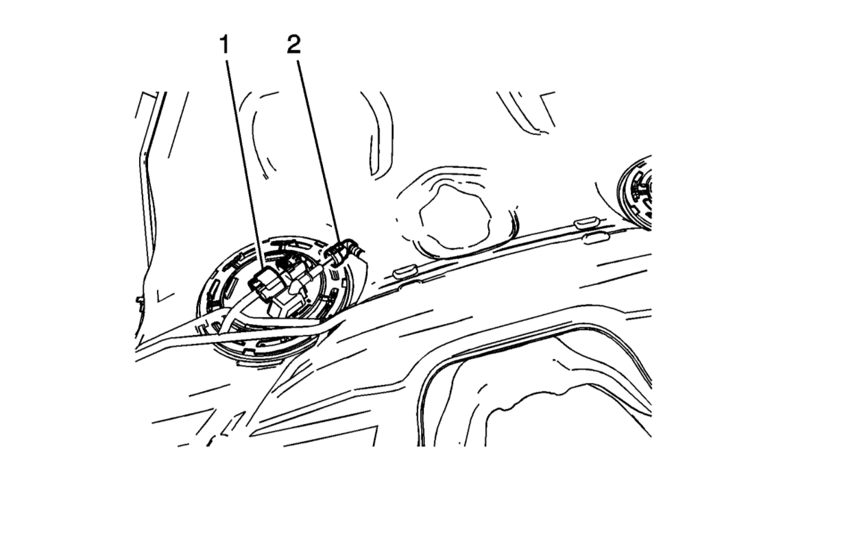

12. Disconnect the fuel tank electrical connector (1).
13. Disconnect the fuel feed line (3) and evaporative emission line (2). Refer to Plastic Collar Quick Connect Fitting Service (See: Fuel Line Coupler > Removal and Replacement > Plastic Collar Quick Connect Fitting Service) and Metal Collar Quick Connect Fitting Service (See: Fuel Line Coupler > Removal and Replacement > Metal Collar Quick Connect Fitting Service).

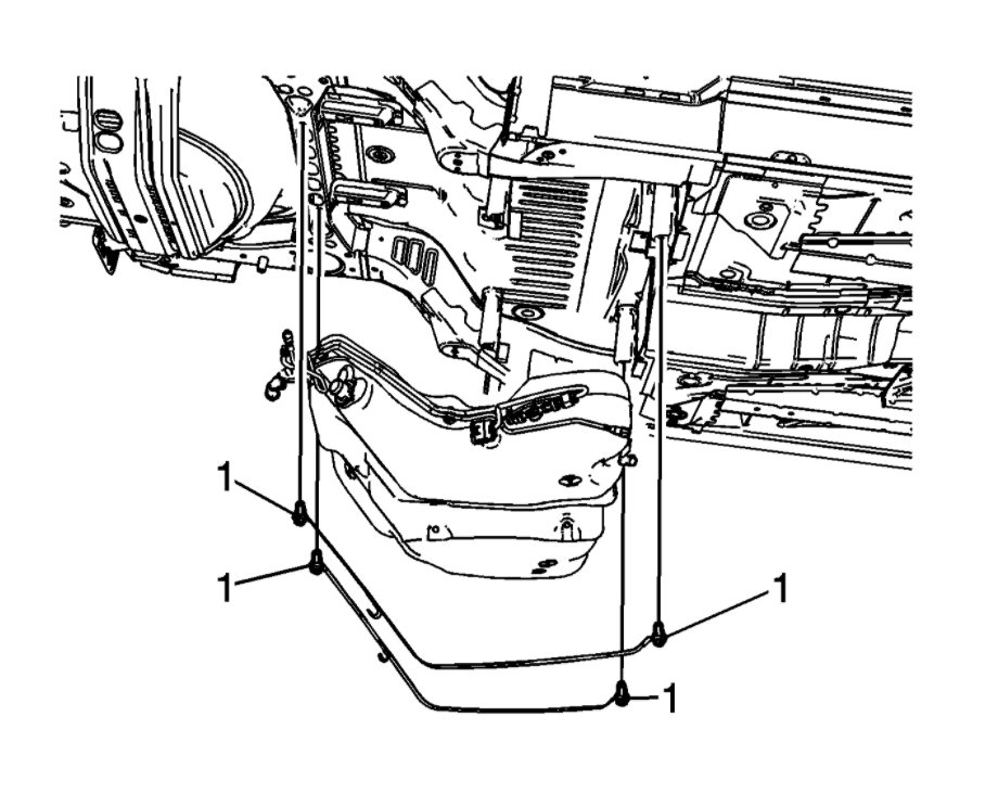

14. Support the fuel tank with a suitable jack.
15. Remove the fuel tank strap bolts (1).
16. Remove the fuel tank.

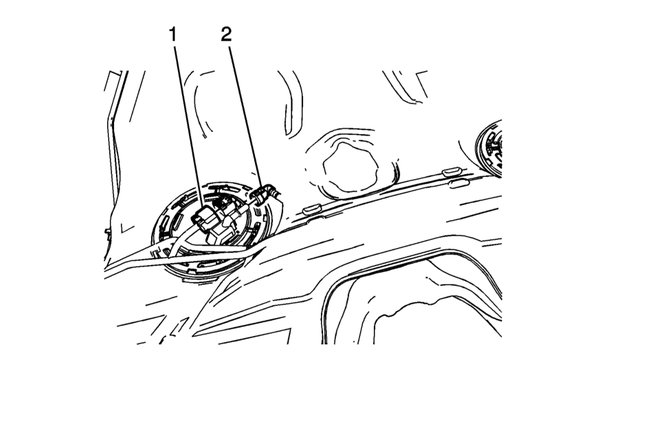

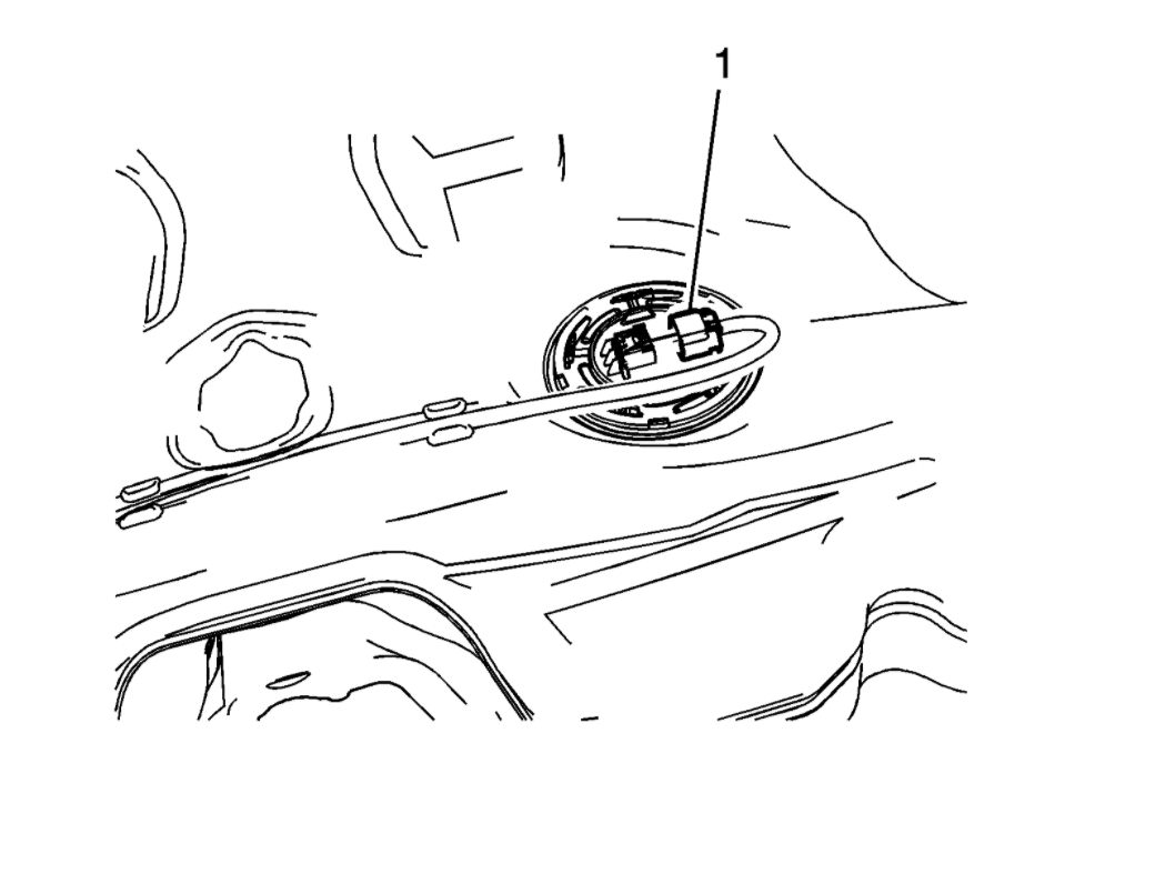

1. Fuel pump module. Refer to Fuel Tank Fuel Pump Module Replacement - Right Side (See: Fuel Pump > Removal and Replacement > Fuel Tank Fuel Pump Module Replacement - Right Side).
2. Fuel level sensor. Refer to Fuel Level Sensor Replacement - Left Side (See: Fuel Level Sensor > Removal and Replacement > Fuel Level Sensor Replacement - Left Side).
