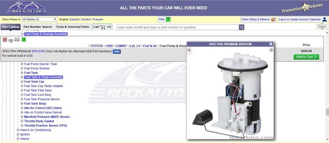

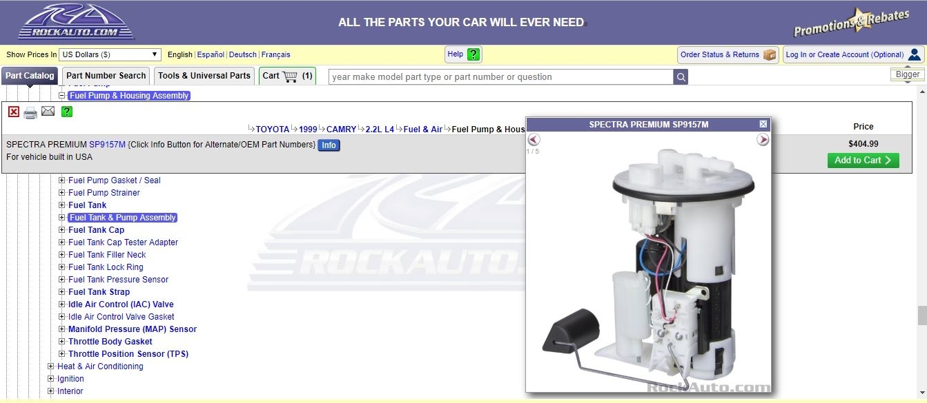

You will need to replace the sender unit in the tank.
I posted one from rock auto. It is not cheap. The only other way is a used one which I never recommend.

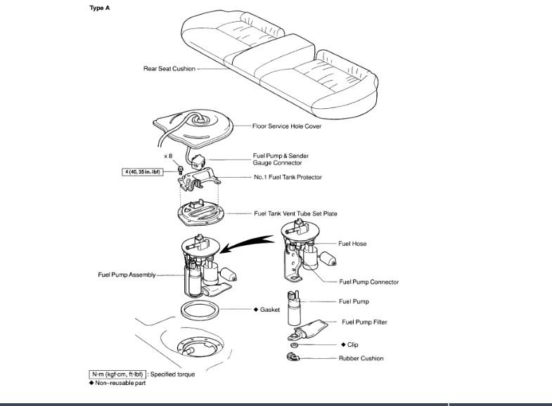

1. REMOVE REAR SEAT CUSHION
2. REMOVE FLOOR SERVICE HOLE COVER
a. Take out the floor carpet.
b. Remove the service hole cover.
HINT: At the time of installation, please see the items. Check for fuel leakage.
3. DISCONNECT FUEL PUMP & SENDER GAUGE CONNECTOR
4. REMOVE NO.1 FUEL TANK PROTECTOR
Remove the 2 bolts and No.1 fuel tank protector.
Torque: 4 N.m (40 kgf.cm, 35 in.lbf)

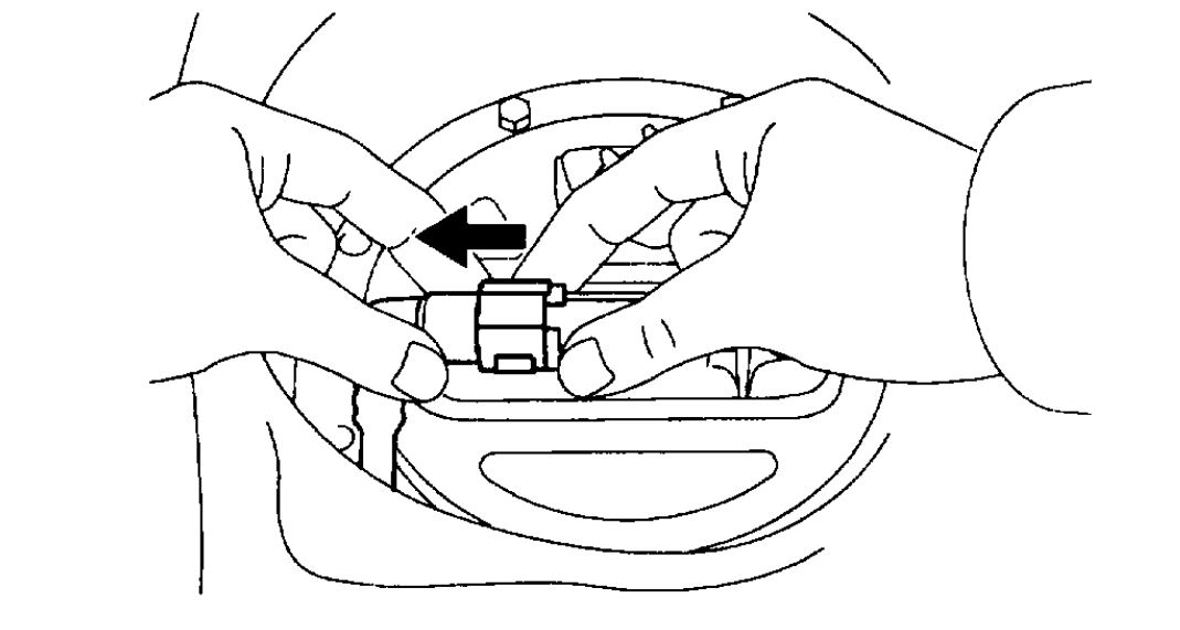

5. DISCONNECT FUEL TUBE (FUEL TUBE CONNECTOR)
CAUTION:
- Perform disconnecting and connecting operations of the fuel tube connector (quick type) after observing the precautions.
- As there is retained pressure in the fuel pipe line, prevent it from splashing inside the vehicle compartment.

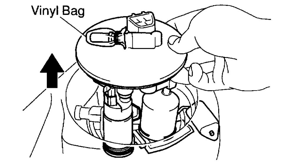

6. REMOVE FUEL PUMP ASSEMBLY FROM FUEL TANK
a. Remove the 6 bolts and fuel tank vent tube set plate.
b. Pull out the fuel pump assembly.
c. Remove the gasket from the pump assembly.
NOTE:
- Do not damage the fuel pump filter.
- Be careful that the arm of the sender gauge should not bent.
HINT: At the time of installation, please see the items. Install a new gasket to the pump assembly.
