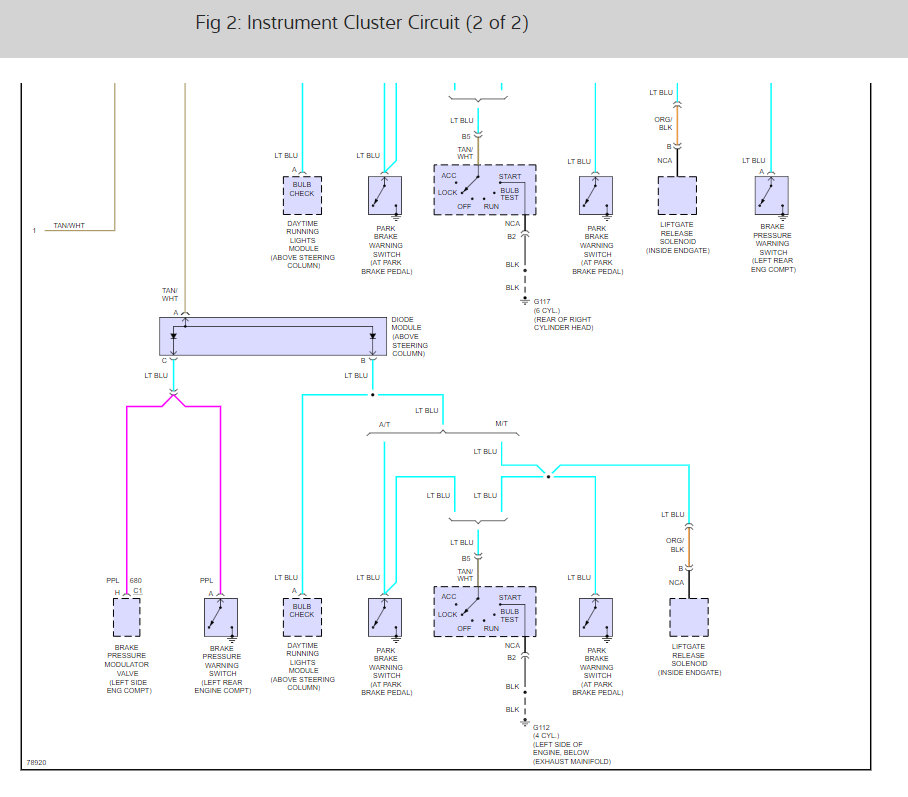

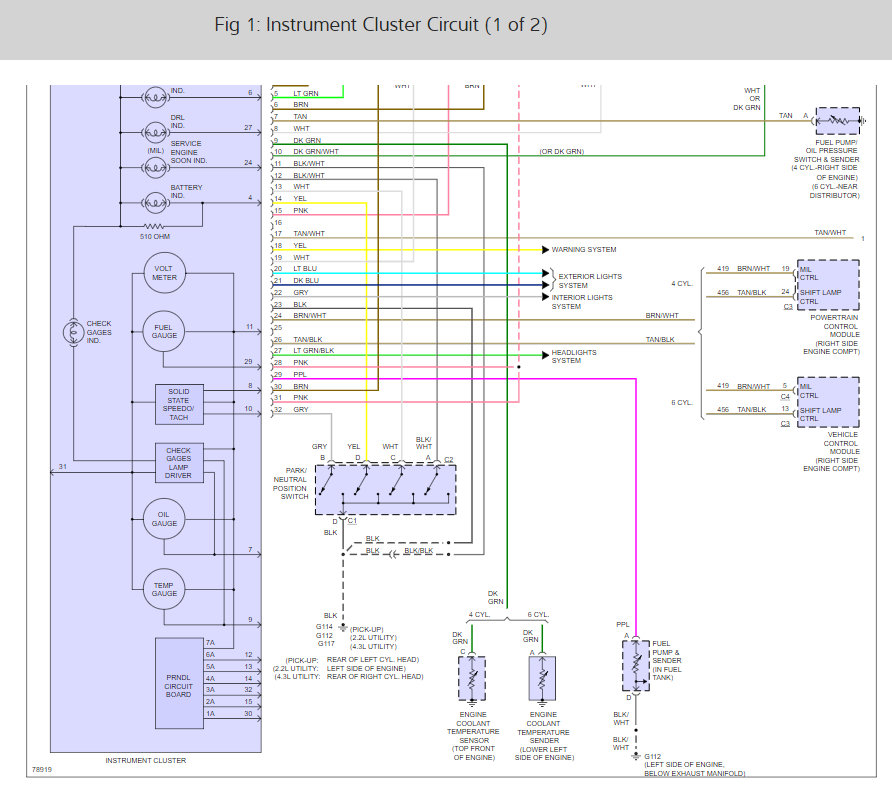

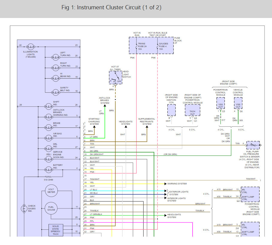

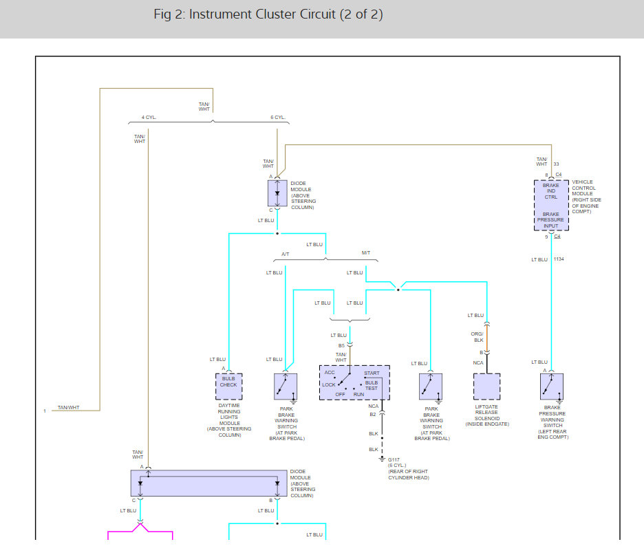

It sounds like one of the cluster grounds has a bad connection. Here is a guide and the instrument cluster wiring diagrams so you can see what wires to test:
