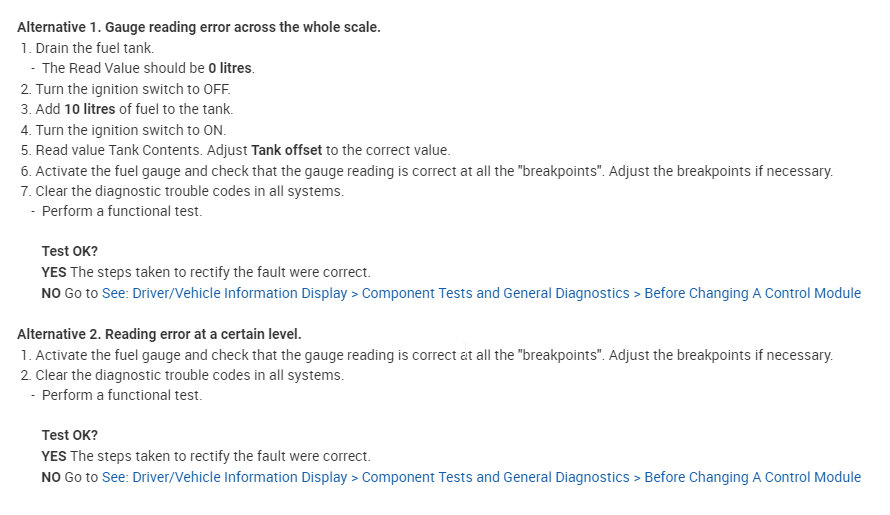

i have changed the fuel pump ,fuel filter,and my fuel gauge is still not working proper. when I changed the filter it was working for about a week then it happen again. next i am going to try the fuel pressure sensor. help
Sep 18, 2019 at 10:37 PM

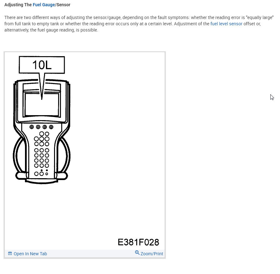

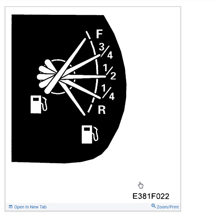

Depending on what the issue is, you can adjust the gauge so this may be your issue. I attached the procedure. You will need a proper scan tool so if you don't have one, it may be worth paying someone to try this procedure.
Let me know what you find and we can go from there.
