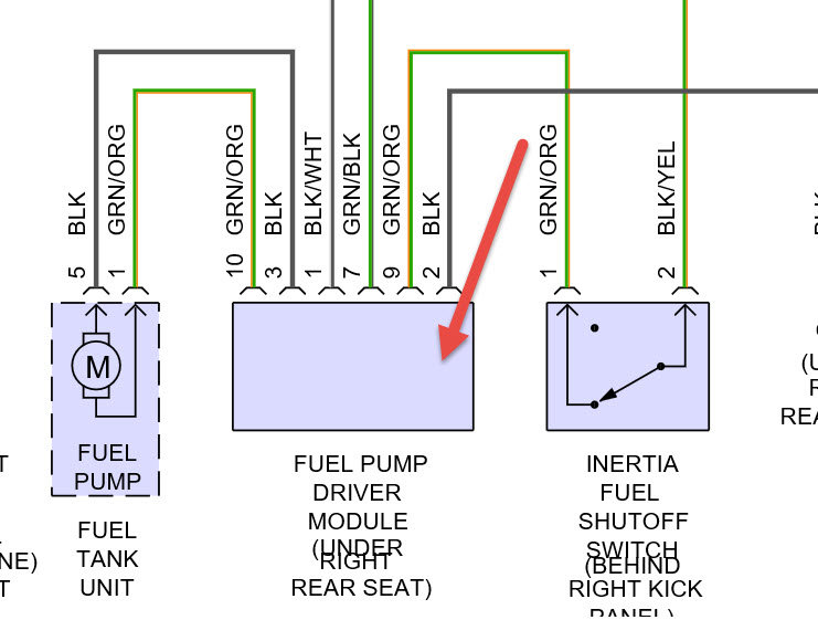

My vehicle occasionally stalls as if I have run out of fuel but not. My mechanic has changed the fuel pump twice as well as the fuel filter. Again as soon as the air condition is put on, the car becomes so heavy for want of better word that when you accelerate. it does not seem to pull as it should unless you again switch off the air-condition. My car has a manual transmission.

if this is a diesel we have not information on it as most here in USA have a 2.0l, but ours has a fuel pump module driver which the mechanic may have to scan for codes as that controls the fuel pump so that may be your cause other than that. we do not have any information for this. see picture.

My vehicle is petrol engine Ford focus. My Mechanic has remove and cleaned IAC valve with choke carburetor cleaner as directed. I tried the vehicle thereafter on a shorter distance and it was cool. I'm yet to travel with it to finally confirm its success. Once again many thanks for your information.
