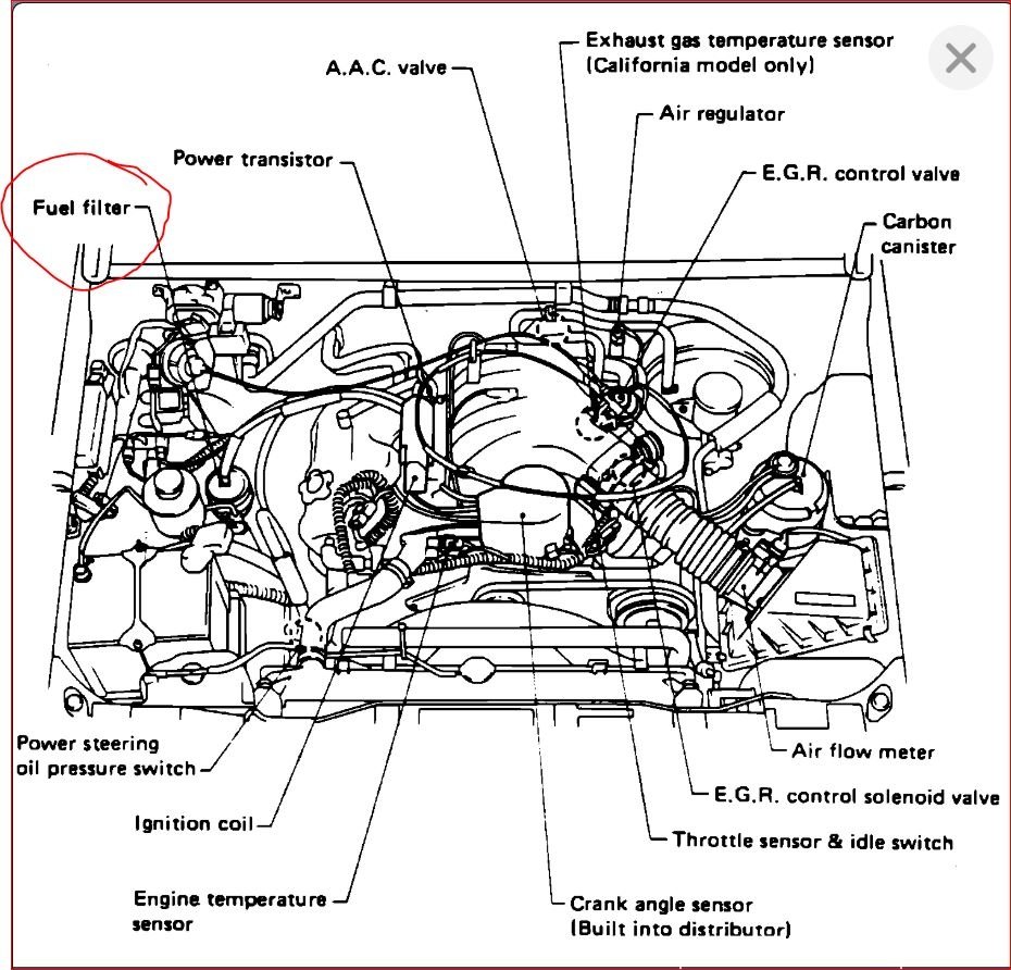

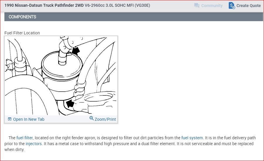

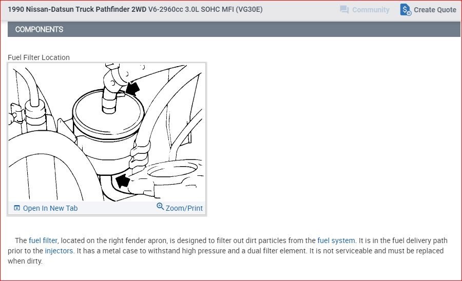

Does my vehicle have an online filter? Also how many filters are there?

Hi Belinda,
I have attached the document showing the position and tells you the location of the fuel filter. It looks like this is the only one that is in your vehicle.
Please let me know if you need any more information. Thanks.
