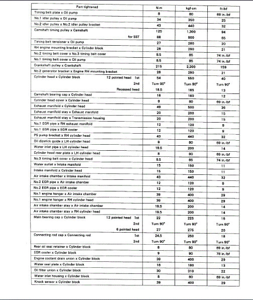

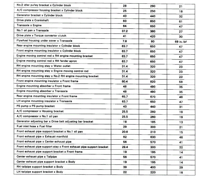

Is there some sort of a chart that you can provide that has all the torque specs for this car? It would really come in handy whenever I'm working on my car.
Thank you!
Cheers!
Monday, August 3rd, 2020 AT 1:35 PM
  • 52,797 POSTS
I attached the torque specs below for you.

Are you sure these are all the torque specs for my car? For instance, I don't see the specs for brake components and suspension components just to name a few.

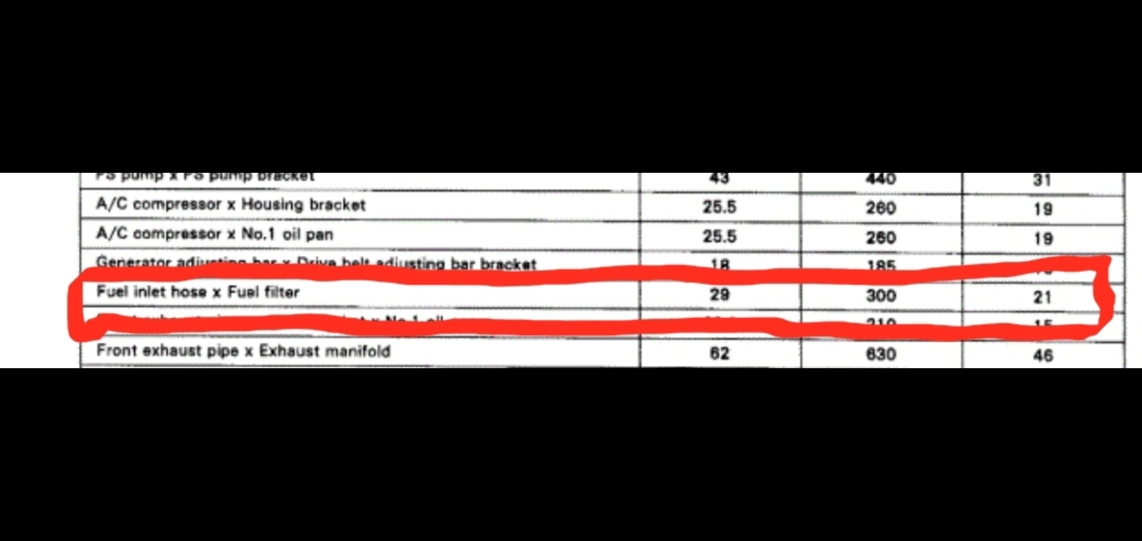

By the way, the torque spec for the fuel filter flare nut - is what I have circled in the attached picture what you were referring to? If not, then which one is it on that chart?
In terms of absolutely not using anti-seize on the fuel filter flare nut- is it because it would contaminate the fuel or are there other reasons? Just as nuch as there are people who oppose the use of it, there are people who do advocate it, so I was just wondering what the downside is?

  • 52,797 POSTS
The never seize will corrode the line and fitting.
I gave you the reading fr the replacement line which is not the same as the OEM. The OEM is a heavier line versus the steel line from the parts store.
You could probably get a service manual that will list all the torque specs for all the areas of the car. A Haynes manual would most likely have them. There are so many torque specs.
I can only deal with the specs for the system we are talking about for this thread. If you like, start a new question for nothing but torque specs and I can get them for you.

  • 121 POSTS
So, there is only a difference of 1 ft-lbs between the OEM and the replacement line?
Monday, August 3rd, 2020 AT 2:52 PM
  • 52,797 POSTS
Yep.
Does not seem like much but it makes a difference.
Monday, August 3rd, 2020 AT 3:04 PM

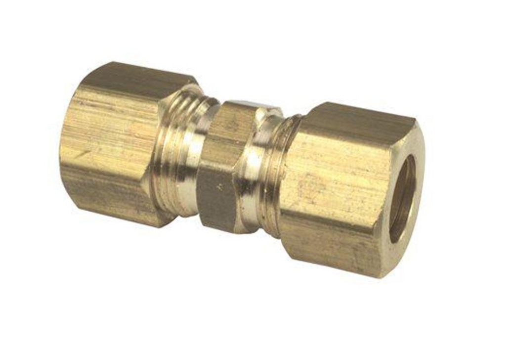

What about the compression fitting - how tight should it be or is there a recommended torque spec for it? I have attached a picture of it.

  • 52,797 POSTS
For what? That is what I told you not to use. Using that in a 20+ year old line will not seal. It will crush the old line and will leak.

If you remember, you also mentioned that it was worth a try, but to keep an eye on it. I have also asked around some people who have used that method on their very old cars to see how it has been holding up for them, and they have said that they haven't experienced any problems or leaks. Nevertheless, I'm willing to give it a shot and see how it goes. If it fails, I already have my backup plan of assembling my own fuel line with a new steel line that is available in auto parts store.

  • 52,797 POSTS
There is no torque spec for it.
You just make it tight. Make sure you inspect it when you get it running to be sure it is not leaking.
