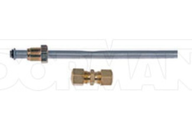

Alternatively, I was thinking of cutting the fuel line close enough to the fuel filter and connecting a fuel line with a compression fitting that comes already flared with the fitting as shown in the attached picture, instead of replacing the entire fuel line. Does that sound like a good and safe resolution? It's a fuel line repair kit and the part # is Dorman 800-151.Thank you!

I am not a fan of those kits. The coupler attaching to a 25 year old line does not sit well with me. It may crush and not seal causing a leak. It is worth a try but make sure you keep an eye on it.

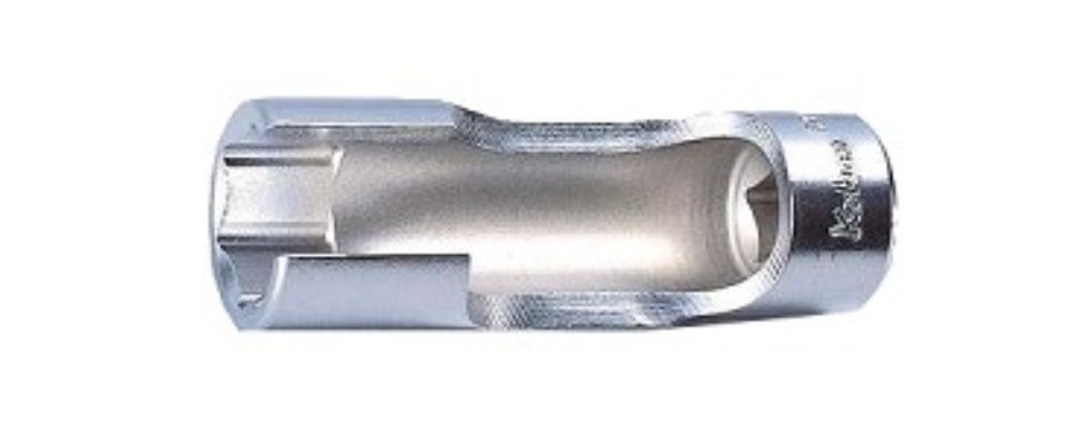

Since using a socket on the flare nut is not an option, how would one use a torque wrench on an open-end wrench or on a flare nut wrench?
Aug 3, 2020 at 4:54 AM
The 6 point socket has a 3/8 hole in the end for attaching a 1 or 3 inch extension so you can use the torque wrench.
Flare nut socket is what you need and a 3/8 torque wrench.
Aug 3, 2020 at 5:04 AM

Can you please show me a picture of what you mean?

AVALON1995
  • 121 POSTS
Oh, okay! A crowfoot flare nut wrench is what I had in mind as well. When you mentioned a flare nut "socket," I thought you might be referring to the attached picture.
Thank you!
Aug 3, 2020 at 5:41 AM
That would work as well.

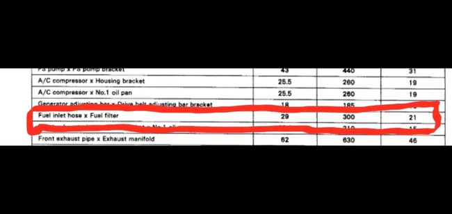

Are you sure these are all the torque specs for my car? For instance, I don't see the specs for brake components and suspension components just to name a few.
By the way, the torque spec for the fuel filter flare nut - is what I have circled in the attached picture what you were referring to? If not, then which one is it on that chart?

The never seize will corrode the line and fitting.
I gave you the reading fr the replacement line which is not the same as the OEM. The OEM is a heavier line versus the steel line from the parts store.
You could probably get a service manual that will list all the torque specs for all the areas of the car. A Haynes manual would most likely have them. There are so many torque specs.

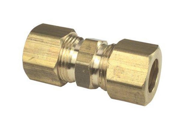

What about the compression fitting - how tight should it be or is there a recommended torque spec for it? I have attached a picture of it.

For what? That is what I told you not to use. Using that in a 20+ year old line will not seal. It will crush the old line and will leak.
Aug 3, 2020 at 10:12 AM
AVALON1995
  • 121 POSTS
If you remember, you also mentioned that it was worth a try, but to keep an eye on it. I have also asked around some people who have used that method on their very old cars to see how it has been holding up for them, and they have said that they haven't experienced any problems or leaks. Nevertheless, I'm willing to give it a shot and see how it goes. If it fails, I already have my backup plan of assembling my own fuel line with a new steel line that is available in auto parts store.
So, how tight should the compression fitting be or is there a recommended torque spec for it?
Thank you!
Cheers!
Aug 3, 2020 at 10:39 AM
There is no torque spec for it.
You just make it tight. Make sure you inspect it when you get it running to be sure it is not leaking.
