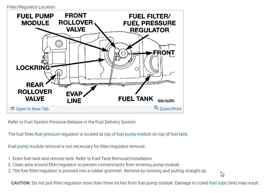

In this vehicle can you remove just the fuel filter or do you have to remove the whole fuel pump? So I guess is the fuel filter one single module with the pump or can they be dismounted from each other?
Apr 6, 2020 at 7:58 AM

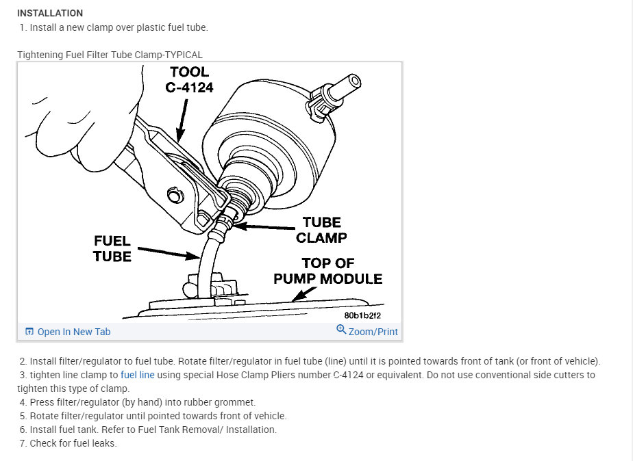

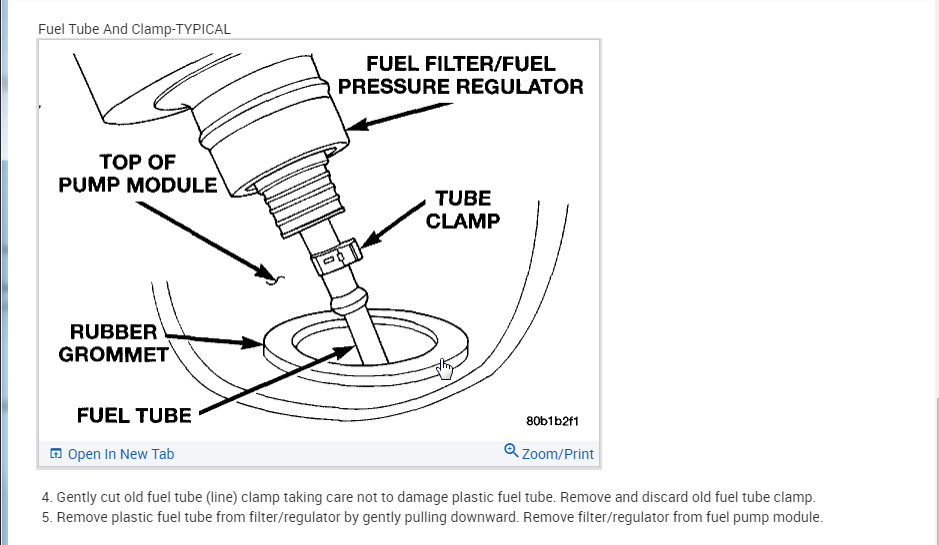

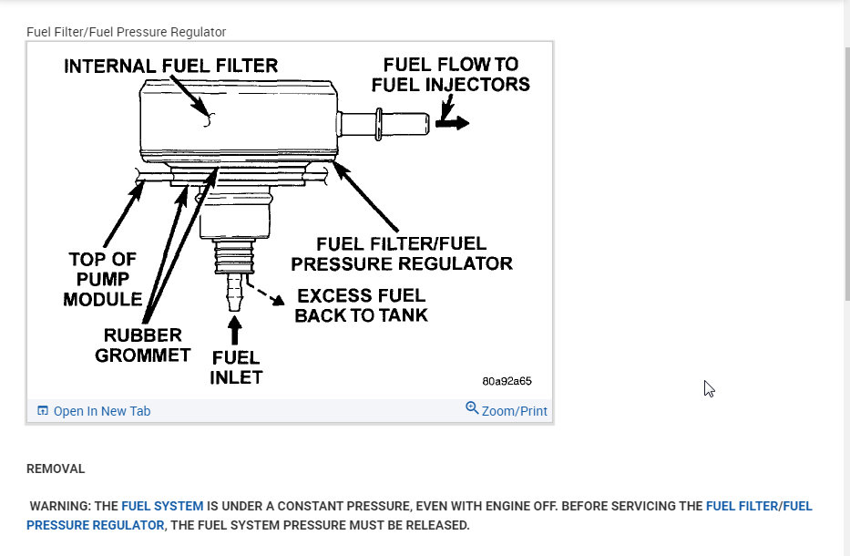

I attached the process. This is an integrated filter so you need to access the top of the tank and replace the regulator and filter assembly.
Let me know if you have more questions. Thanks
